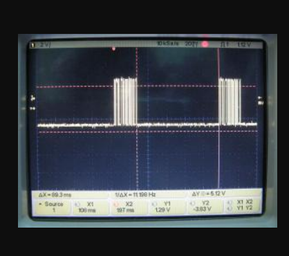

The best test is to use an oscilloscope on the IR receiver output and confirm the data can be seen.

If you have a scope then that is pretty definitive. Look for a 5 volt swing in the data on the output pin of the receiver.
If you set the time-base correctly then you should see this kind of thing:
