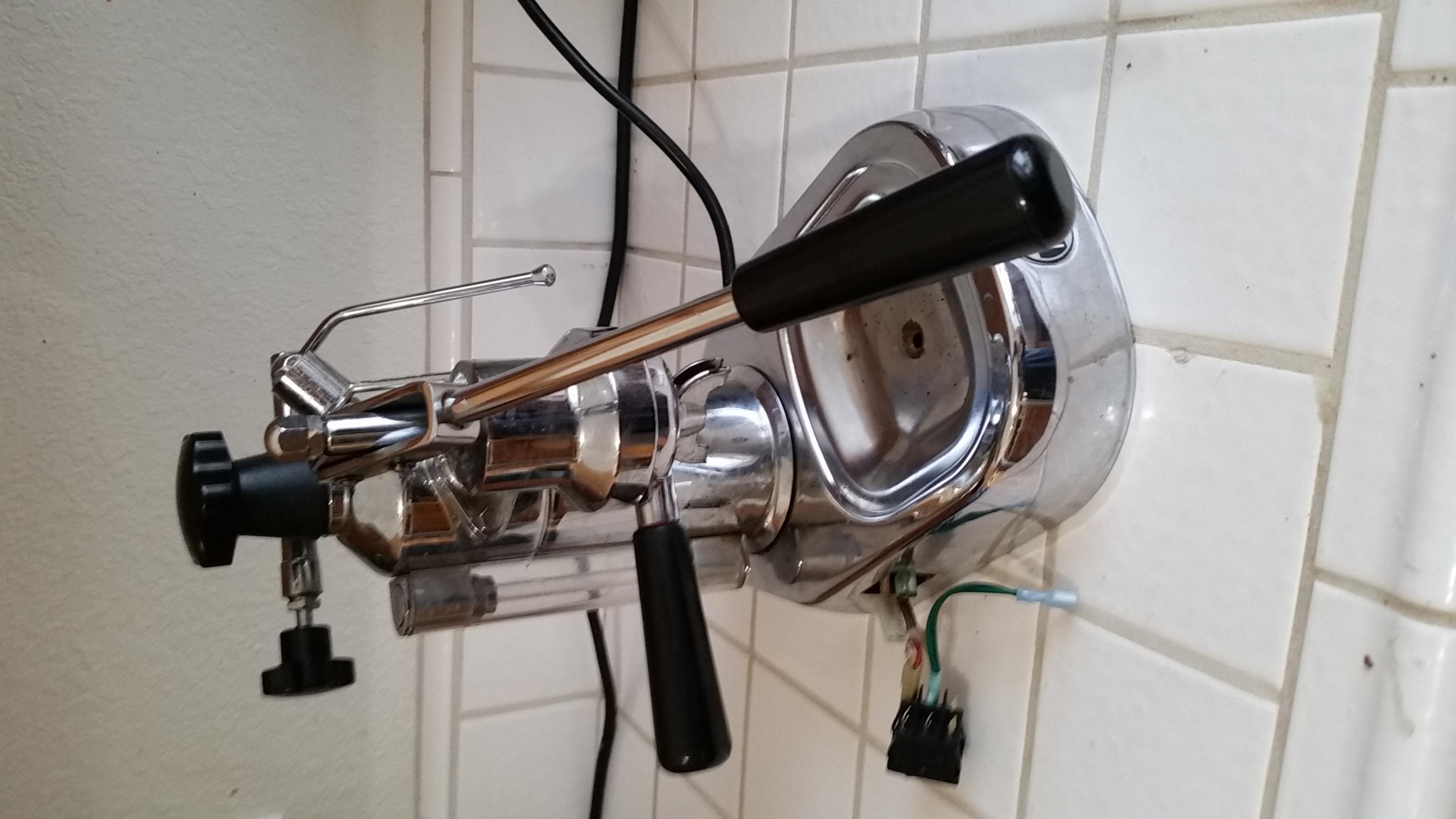

It’s time to rewire my espresso machine. Most of the internal wiring, including female spade connectors (Nomenclature?) and woven hi-temp insulation is in pretty rough shape. Do any DIYers out there have experience working with equipment that makes steam? It seems to be a pretty hostile environment for metals. My problem is that I need some wire, insulation, and connectors. If I knew how to specify these things I would just order some up from one of the usual suspects in Texas or Minnesota. The search engines on those sights always feel very awkward to me, probably because I’m not an engineer. I could probably source the stuff from a local appliance parts shop, but I don’t think that would really qualify as “ essential.“

Clean off all the terminals that you can't remove with Caig Deoxit D5.
Buy a terminal assortment in the hope that some will fit properly.
Solder the new wires to the new terminals after crimping them. Examples:

I'm a Deoxit fan too, but my solution is to replace the $50 espresso maker with a similar unit. 🙂
Yes, but he wanted to fix it, and he will have the Caig and terminals left over for future use,
so there's no significant cost for the repair. And it could be one of those $2k buck machines.
Yes, it’s a very hard environment and the aging process is very much accelerated.
Descale the boiler(s) while you’ve got it apart. Rayma’s suggestions are good. Basically anything new will be better than old, and generally just clean up everything you can get to.

Definitely not going to trash it! If it were a $50 unit it would be long gone. This is my second La Pavoni Europiccola, I didn't pay $2K for it, but significantly more than $50. I rebuilt the first one three times,including having it re-plated once. I don't know how old it actually was, but I used it for 20 years before replacing it with another used one off ebay. The original now serves as a parts donor for the second! This is the 3rd or 4th time I've done serious surgery on it in the 23 years I've had it. I know it is somewhat of an affectation, but then I enjoy the ritual of my morning latte. And, even with all my rebuilds it has paid for itself many times over. Through the years,I have learned more and more about the care and feeding of these little guys and continue to learn.

You can get silicone rubber heat shrink tubing for the aging insulation. It will take temperature and humidity. However it runs a bit more than $1 per foot!
McMaster Carr carries it.
No fun to get the wire to pass through either, at least the stuff I’d used.
Maybe some automotive rated wire would be something to use?

Faston, like all good things available in metric sizes 6.3 mm, 4.8 mm and 2.8 mm. Buy good ones not Aliexpress stuff. Especially when there are used in high current applications.female spade connectors (Nomenclature?)

Regarding the wire. Most commercial machines that I work with simply use high temp, high voltage wire. 105c and 600v. Often silicon insulation, i have a lot of salvaged coffee machine wire with 'silitherm' branding on it. Nothing too fancy. Faema, cimbali, gaggia, nuova simonelli, etc, all the big brands
Occasionally I see nicer stuff with what looks like braided cotton insulation but probably isn't cotton. For example San Remo machines.
Just get get whatever you can find in the right colours with the highest temp/voltage rating of the appropriate gauge. Preferably silicon.
Terminals don't need to be fancy either. I mostly encounter insulated spade terminals Of the type that looks like a white nylon box around the spade. Sometimes plain heatshrink or regular grade insulated spades.
