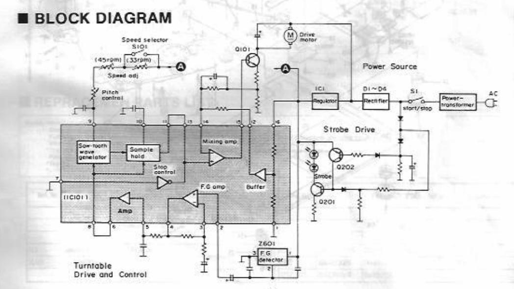

I'm trying to fix a broken Technics turntable which has a DC motor controlled by a servo feedback system. There is a magnet on the motor shaft which sends pulses to an IC (SVIBA6301) which produces a control voltage for the motor drive transistor. It is a very simple circuit with all the control functions built into the IC but unfortunately that IC has gone bad. All the input voltages and signals are correct but the output voltage is way off. I can't find any source of a replacement of the IC so I'm looking for simple options to get this turntable running again.
1) The easiest thing to do seems to be substitute a basic DC motor control. There is a strobe light on the platter so manually setting the speed correctly would be easy but there would obviously be some drift under load. How big a PSU would I need to keep it reasonably stable?
2) In the service manual there is a block diagram of the internals of the controller IC. From the voltages I can measure it looks like the problem is with last part of the comparator/buffer output - the "Mixing amp" in the attached diagram. Any chance I could just replace that stage with a simple OP-AMP?
3) Provide a complete replacement for the frequency feedback system. Anything already done in this area?
This is a friends ill-advised eBay purchase and simple/cheap would be what I'm looking for.

You sir, are a genius (although if I had looked closer at the actual hardware, rather than the schematic, it would have been obvious to even a fool like me).
After a short search on the web (avoiding booking the flight from Cape Town to Durban) I secured a BA6301 for a few quid and I now have a turntable running at the correct speeds.

Good to hear it's back up and running. These ICs were designed back in the late '70s or so in order to make basic turntables easier to build, and would have gone EOL when the market for record players dwindled in the early/mid '90s.
What I don't like so much about this one is that 33 rpm speed depends on 45 adjustment and 33/45 switch contact as well. How's it doing in terms of keeping speed? While the trusty SL-BD20 that my dad bought in '91-ish may well have been keeping spinning at near-ideal speed all day, actually playing a record it would be down by about 0.3% or so - it uses much simpler control electronics mostly integrated into the motor though, and I am not sure whether there actually is feedback involved (not from the platter for sure, which would seem to be the case with yours).
