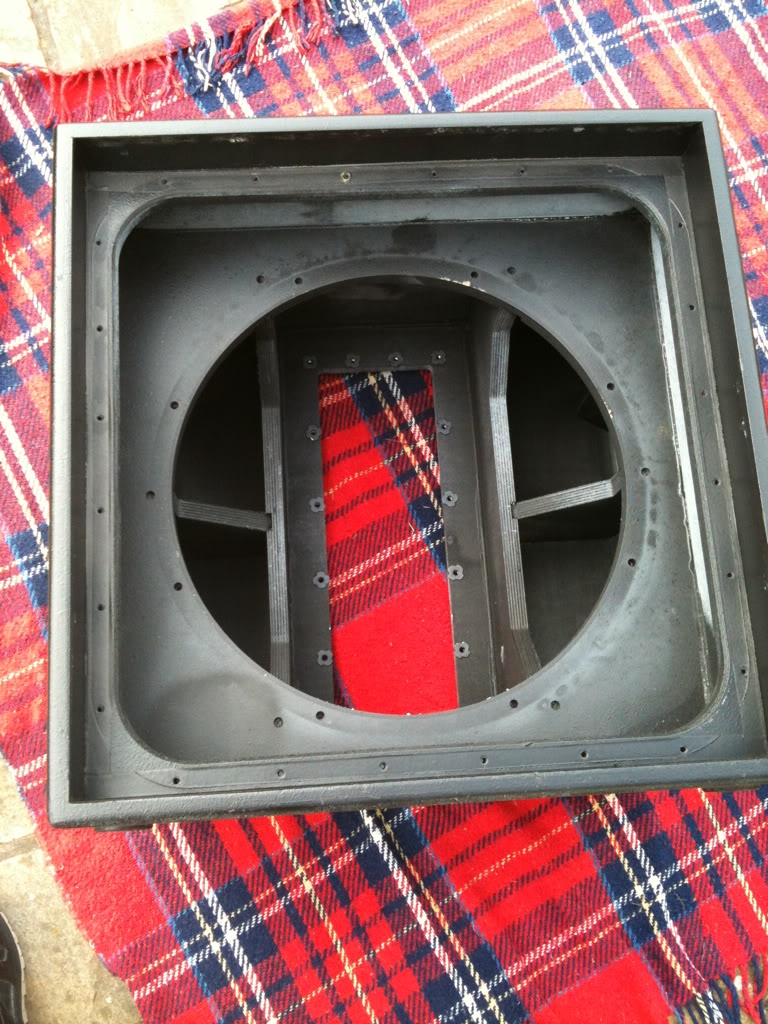

.... and one interesting answer is electrostatic loudspeaker. Which is the answer to a lot of quality sound-making questions.
With all the extraordinary huffing-and-puffing in this thread, you could go to the same effort* and make a giant ESL. No problem in theory, eh.
The famous Dayton-Wright ESL panel was enclosed in a meter-square steel box with mylar covering the whole front and back, which is larger than the ESL membrane. The insides were filled with a welding gas called by its friends, SH6 or something like that which is far heavier than air. Impedance matching.
Being full-range, DW didn't go for broke on the bass. The box resonance is around 45 Hz but you could go lower if you were only interested in bass. The sound is exceptionally good, of course.
For those of us who are negative on boxy sound, the DW box is different in that the essential working parts aren't trafficking in the resonances.
Ben
*OK, 100X the effort
