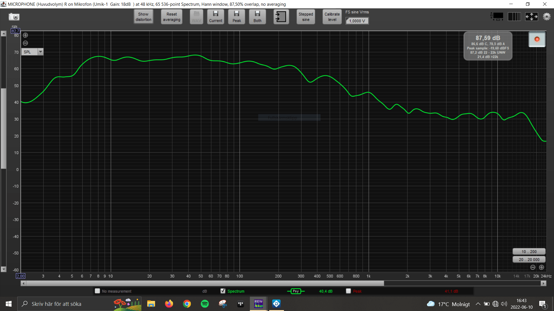

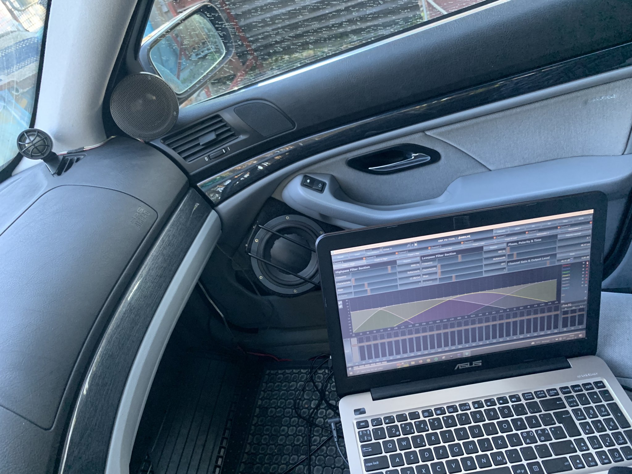

I am now DSP-tuning a full active 5 way system. And now it sounds top notch. Balanced. Sweet. Powerful, hard AND juicy, controlled and musical! All Front stage.
Well. Do you like flat-flat?
No one does? So why is flat still an issue and just not a very bad old joke, like it IRL is? And this is equally true in all home High End systems?
Pictures 1: 3 way front stage, closed boxes midbass. Not in picture: Twin 6,5 inch subwoofers front, closed box. One 8 inch subwoofer reae, closed box. Picture 2: NOT FLAT =) REW RTA measurement.

A rising response in the low end is typical. Usually starting lower than the OP's but typically with a 4 to 6dB difference between say 60 Hz and 10 kHz. What is rarely discussed is how much the time domain response of the room affects our perception of the frequency response, so much so that in our studio design efforts we prioritize that aspect over frequency response.
You're also in a car which changes things a little as not only are the speakers near boundaries so are you. You really want to get that tweeter closer to the midrange though.
It's fairly well established that we like a ~5dB downwards slope for averaged room SPL across the audio spectrum.
You're almost 15dB which could be exaggerated by the boundary conditions of measurements and positions of speakers but certainly wouldn't be anything out of the ordinary for a car. Usually you need the bass turned up quite a bit for it to have a similar level of impact with engine/road noise vs when the car is stationary and turned off. Not only that most car users tend to prefer having the bass exaggerated beyond that anyway.

If I'm not reading that graph wrong, I am a little surprised that your bass appears ~30dB higher in amplitude than your treble. Was the mic at ear height and position?

Yes, i was a little surprised myself where it all ended up, a very nice tilt on the graph🙂👍If I'm not reading that graph wrong, I am a little surprised that your bass appears ~30dB higher in amplitude than your treble. Was the mic at ear height and position?

And yes i am using a calibrated mic and it is placed where the drivers head are expected to be.
So i am sligtly surprised myself. But it sounds really musical, full bodied, crisp, clear and strong. And not bloated or fatiguing.
Just like real musical instruments and voices sounds in real life. Lush, full bodied, present and never electrically harch and thin.

In this car and measurement i have not yet added or extracted anyting with the EQ.

If all your calibration is correct, I would not trust a measurement with a level that low (30 dB SPL at higher frequencies). If your desired signal is not significantly above background noise, an accurate reading is unlikely. Something in the 80-90 dB SPL range is more typical for tuning a car. Wear hearing protection if you need to be in the car to do this. Without protection it gets annoying fast and will make it hard to judge what you hear after.Picture 2: NOT FLAT =) REW RTA measurement.
If you are using a correlated pink noise signal to measure both channels simultaneously with RTA or are using an impulse-based measurement, it's very easy to introduce errors when measuring multiple speakers simultaneously (e.g., left and right channels at the same time). Very small differences in the distance from the microphone to drivers will create cancellation. This affects high frequencies more, since the wavelengths are smaller. I can't tell from your description if this applies. If it does apply, switch to uncorrelated/random/unsynchronized pink noise. Sorry for the multiple descriptors, but people call it different things.
It's also pretty common to tune the left and right sides or individual amp channels in isolation to get things flat, then start combining things to apply crossovers and global EQ.
Steady-state measurement (RTA/pink noise) vs. direct sound (impulse-based measurement) affects this greatly. The two methods often produce different results, with steady-state showing in-room downward-sloping response with increasing frequency while a direct sound/impulse measurement shows flatter response. The following full paper is available free and deals with this topic. It also includes some data on typical car curves (section 4.2 and Figure 15).Virtually no one is creating, mixing or mastering on speaker/room combinations that are "flat".

IMO, flat (measured, not just dial markings) is a necessary target for designers to start with. We'd be lost without it. OTOH, it doesn't usually sound the best in real world listening situations. There shouldn't be an stigma to using tone controls or full equalization, though I'd add one caveat. Traditional equalization can't fix anything other than response, and many problems have to do with reflections and room treatment. If you need to fix the room, you need to fix the room!

If all your calibration is correct[…]Something in the 80-90 dB SPL range is more typical for tuning a car. Wear hearing protection if you need to be in the car to do this.
Simply top notch advise. I always use hearing protection when uncorrolated pink noice is playing.

Well, besides all above. Still: You will need a landslide from the bass to the treble, to make things real, natural and strong.
But i think you are thinking right: Noice versus real signal. Could be fooling us. So. I will play the pink noice louder. Uncorrolated. And post the measured curve.

The initial posted REW uncorrolated pink noice curve is done AFTER i have run the Helix automated time/distance based adjustment between all single speaker elements, to avoid cancellations.
