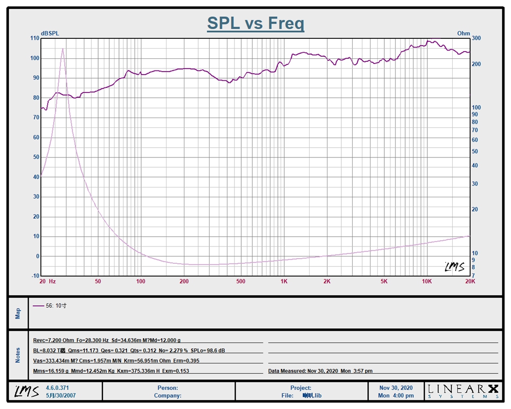

Take a look at some of the Lii Audio drivers and believe their FR graphs blindly 😉
Trolling aside, they have some great $/performance models and while my F15s are nowhere near the graph, I adore them with a little help of a notch 🙂

A notch filter is needed on many FR drivers. But tbh, the Lii drivers all got a very high Qts which makes it quite hard to use them other than in OB and I'm not a fan of their foam surrounds which will dissolve in 10-20 years. I honestly believe they sound good but I'm not convinced every of their drivers do. Their Silver-10 Flagship 10″ Fullrange Drivers go from 87dB@400Hz to 118dB(?!😱)@10k, don't you think a range of 31dB difference in level isn't actually that great? I mean, that goes a bit above 'sounding', don't you think?
At least their Silver-10 flagship got decent parameters, if you believe the text Qts of 0,31 in the graph. Though, according to the impedance measurement they got a Qts of far over 1 (impedance peak at 250 Ohm!). The very high Qts is the price you have to pay for the extremely low moving mass (Mss just 12g for a 10" 😱), which is really impressive. Though the mismatch of the stated parameters and the measurements do not tempt me to 'just try it' at a pair price of over 1000 bucks. They might sound very good but you very likely have to build very special enclosures with strong room interaction for them.

I'm quite baffled myself that their latest generation (and most expensive) drivers have a huge shelve in the high mid/treble.
I didn't really respond to the OP's question, but was probably too enthusiastic to share my experience with the F15, which is in his price range. These have a treated paper surround and sound really smooth with a notch at 6.5 khz (bye sibilance). I'm using them in OB indeed. Much prefer the depth versus razor-sharp imaging of monopole speakers.

The problem with lii specs are that they are not accurate at all. The real measured specs are far off from the published ones as many measurments show. They are very hyped now, but i don't think those are good at all.

The Mark Audio's are great but you have to live with the resonances in the lower midrange (clearly visible on the impedance graph).

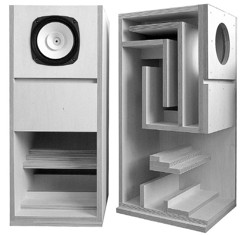

Santitrucco:
FE206En based BLH speakers
This construction was a " goal" with the Fostex FE 206 at the time, surely there must be current equivalent of that speaker.
Fostex FE168NS 6.5 "Full Range looks great ...
Fostex FE168NS 7.5" Full Range
OP :
On the Fostex page you have very valuable information, the cabinets for certain speakers are already calculated by the manufacturer, which is a great advantage in my opinion.
Which does not take away from the pleasure of experimenting with Win Isd or other similar software, although I do not remember any for horn speaker designs, which are the most recommended in low-inch speakers.
For example :
https://www.fostexinternational.com/docs/speaker_components/pdf/recom_enclose/168ez_enclrev.pdf
For example :
