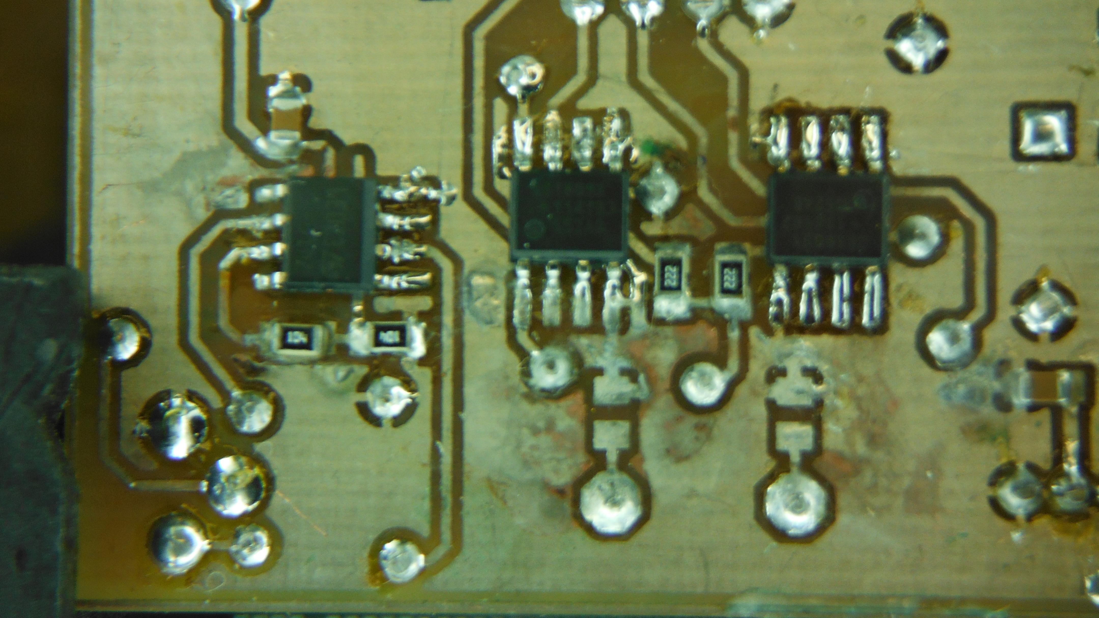

I recently had a project fail and it appears to be because of the soldering paste used during construction. The circuit failed the second time out and investigation showed it was badly corroded at every place I had used MG Chemicals No Clean Flux Paste. I was using it with a soldering wick to wick up excess solder. The corrosion was bad enough to short a supply rail under one chip, compromise all the traces under another and take the tinning off in multiple spots.
I obviously need a few pointers on a good solder flux and a cleaner. The stuff says 'No Clean' but apparently this isn't the case. I've seen this before when using something called Orange Crush which is why I tried this other stuff.
Most of my work is hand soldered surface mount. What does everybody use as a soldering flux?

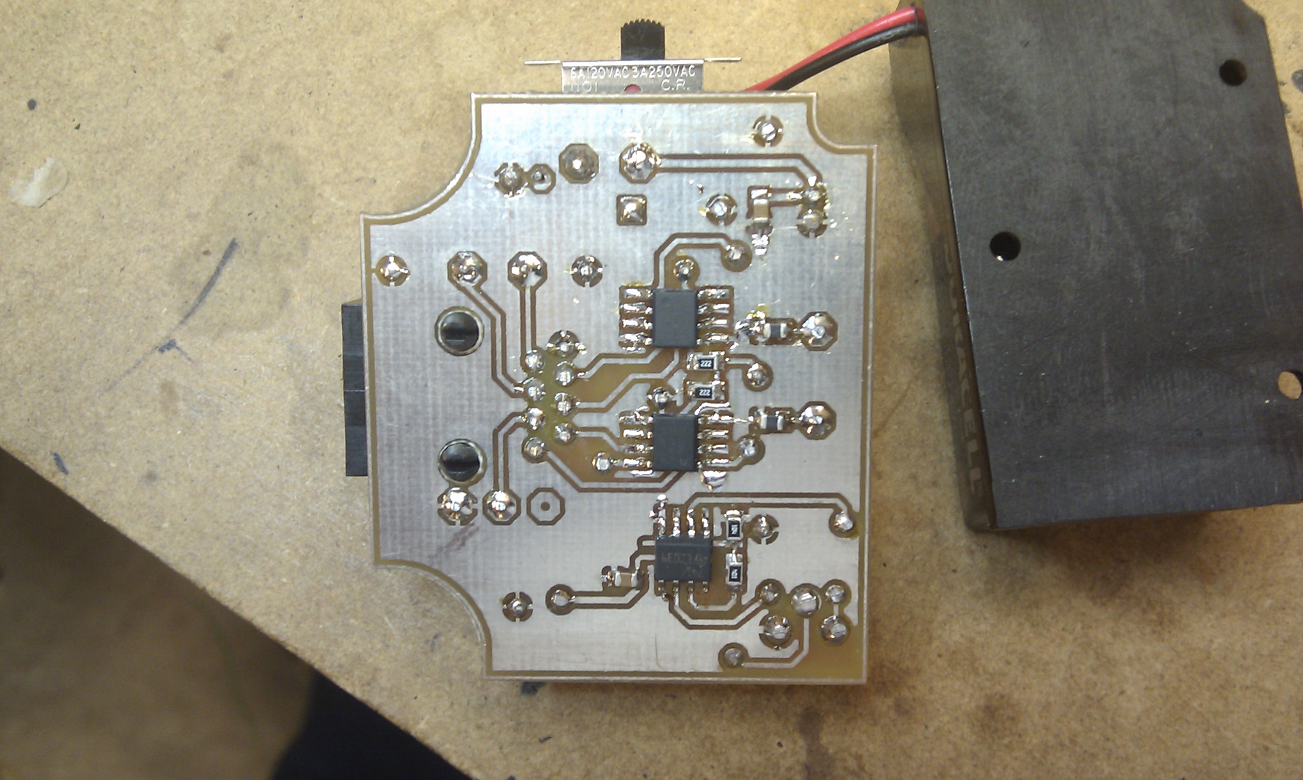

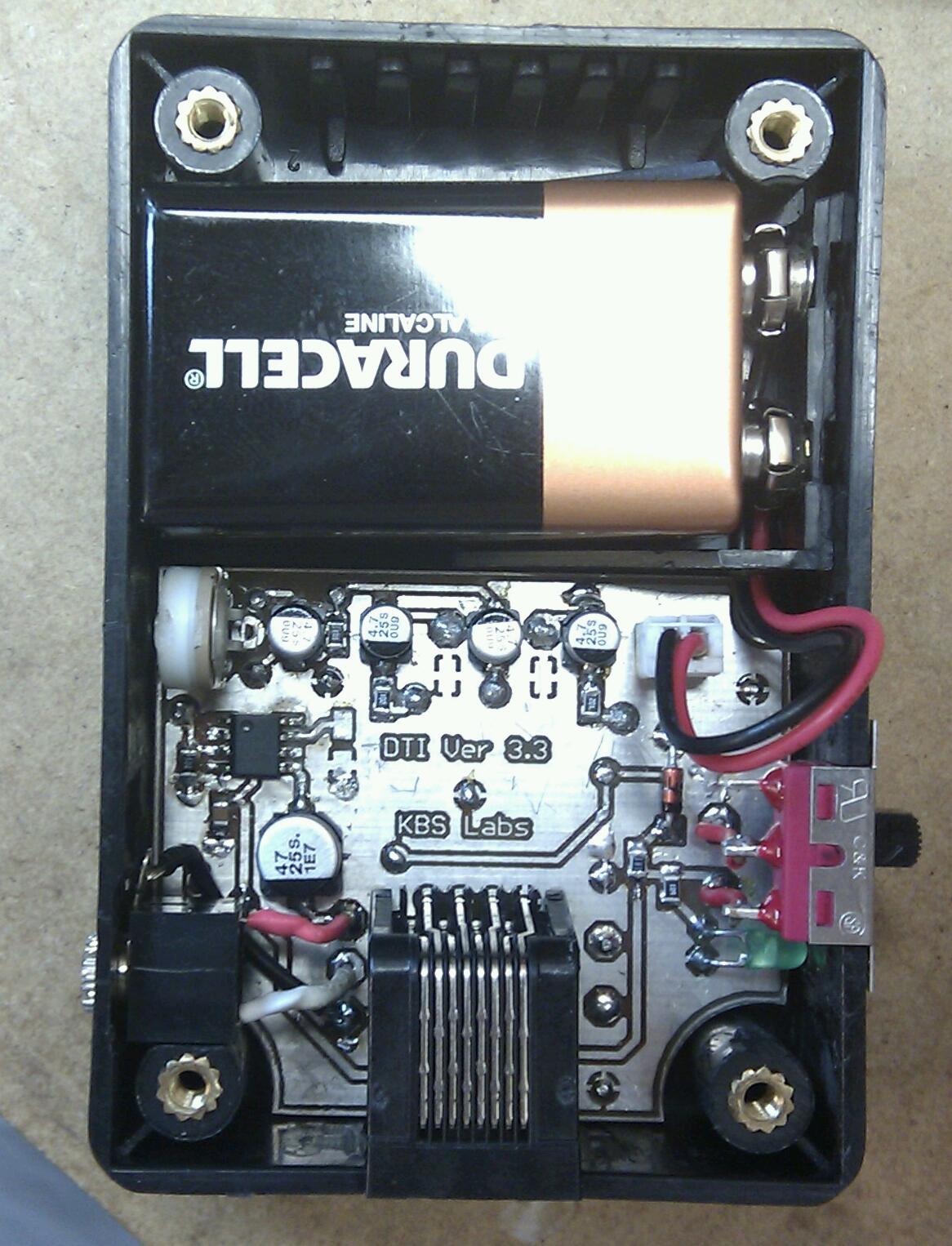

It's an audio mixer used with two transceivers. The PCB is a small double sided board primarily surface mount with a a few through hole components. This solder paste is sold for use with electronic components. In one of the pictures taken through a magnifying glass (not a good photo sorry) you can see some of the corrosion. It was bad enough underneath a couple chips to compromise the circuit. The odd thing is, the flux residue exists in all the pic's. It was on the board for weeks with no problems until it was used in the field. It only seems to have caused a problem where I used it with a solder wick.
![DSCF0248[1].jpg DSCF0248[1].jpg](https://www.diyaudio.com/community/data/attachments/315/315158-f01f809f3ce338dba2ab22758f2a896c.jpg?hash=8B-AnzzjON)
Hate to repeat myself, but solder wick usually contains flux.

Obviously there is a correlation between use of flux and corrosion, so 99% the problem comes from there.

That said, that PCB looks homemade.
If traces of etching chemicals remained, even a little can do a lot of damage if exposed to humid conditions so that's something to consider.
That PCB sits in a very tight, closed space, but in larger spaces (such as inside a TV or Guitar Amp, rat pee can have a terrible corrosive effect. No kidding.
Edit: I make my own PCBs; something I learned to do long ago, is to neutralize acid residues after etching, simply washing is not enough, doubly so in Phenolic PCBs which absorb moisture .
After etching and washing under running water I give it a last bath in a couple teaspoons of common household bicarbonate (a.k.a. baking soda in USA) into a liter/pint/quart of tap water, let it sit there for a few minutes and the wash again under a tap.
When dry (use heat or Sun to be certain) I brush copper shiny clean with steel wool and brush my homemade flux .... works like a charm and is very reliable.

As a former solder jockey, I can make some recommendations. In all seriousness, if you want your circuit build to last a very long time, clean it after soldering to remove all traces of flux, no matter what flux. This is DIY, so you aren't making 1000's of boards. Just take the time and clean it. Isopropyl, Simple Green, whatever. It feels funny scrubbing a stuffed and soldered PC board in water but so long as it's totally clean and dried before energizing it's probably the least potentially damaging method. Even zinc chloride pipe flux has its place in electronics for large connections that can't be properly clean before soldering. But it is difficult to clean petroleum base paste flux, and if used on stranded conductors or migrates under or into a component (like a small potentiometer) it can be plain impossible to completely clean off, so watch out / don't use it there.
This is excellent information. The article link posted my Marce is very informative. After reading that I believe this to be metal salts from the paste. I probably used to much or didn't get it hot enough or both. This is the first problem I've had of corrosion and the paste is new. I won't be using It again.
I've never washed my boards after population and haven't had problems but I probably should wash them. There are commercial board cleaners out there in spray cans. Sounds like some off you use alcohol and water. Do you simply immerse the entire populated board in the alcohol and then water to remove the leftover paste?
Andrew, you were posting the answer the same time I was asking question. Thanks. It also never occurred to me to flux the entire board and wash it prior to population. I've simply been cleaning them.well after etching and tinning them.
This board is a write off unfortunately but I'll be washing my boards after population from now on.
