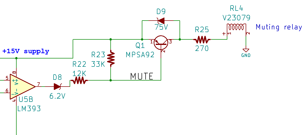

Sometimes I connect the flyback protection across the switch transistor instead of across the relay coil. Since the transistor is, after all, the thing which can be damaged by high voltage during the flyback event.
In this example I'm using a transistor rated Vce_max = 300V, and clamping its Vce to 75 volts. Very very safe.

Regarding that circuit with D9: the diode needs to be across the coil, not the transistor. Placing it across the transistor protects nothing and puts the diode itself at risk of being destroyed.
The purpose of a freewheel diode is to provide an alternative route for the coil current - if the current in the coil is forced to drop rapidly to zero it will fight back generating whatever voltage is necessary to keep that current flowing, which can be 100's or 1000's of volts.
Thus the diode is placed backwards across the coil.

Naah, the only thing that flyback can hurt is the switch (transistor). A 75 volt zener across a transistor rated for 300 volts, keeps everything within spec. Self's power amp book covers this, see Figure 24.32. His accompanying text above that Figure says
This is a good point to stop and consider exactly what we need to do: the aim is not 'suppress all back EMF' but rather 'protect the transistor'.
BTW, the schematic snippet shown in post #14, has been built and tested in real life. It's a small piece of the Azul headphone amp, which I demonstrated at the Burning Amp Festival in 2019. It worked nicely and attendees who listened to it, liked what they heard.

The zener diode solution provides for a faster release of the relay contactor as it allows the relay coil to breath a bit more freely when it commutates than with a freewheeling diode directly in parallel with it.
The schematic shown above is sub-optimal in the way the zener is connected as it now depends on how stiff the supply rails are, that is because the rails are the ones doing the clamping action of the overshoot and I would be worried with noise shot into to supply rails.
A zener + diode (+ optional R) series circuit directly in parallel with the relay is a better solution as in this case the supply rails will now be excluded from the clamping action as it is now kept local around the relay only.
If the turn off release time is not critical then there is no need for a zener solution, am suspecting another potential problem using zener might be the EMI emission as it allows for a larger voltage spike, therefor a freewheeling diode is in most case a good enough solution.
