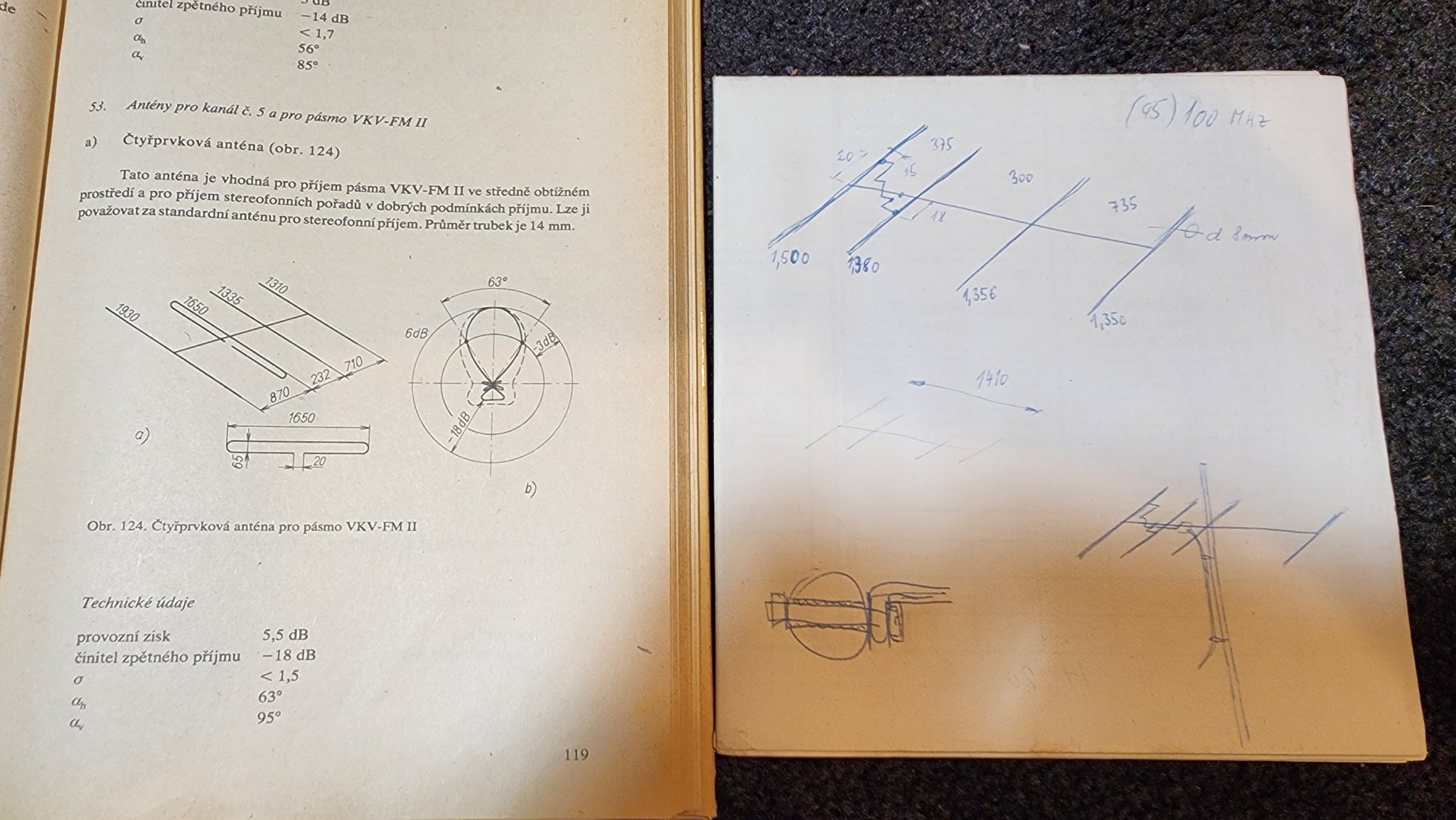

I use two element omnidirectional antena for local fm stations. For long distance i have four element yagi-uda.

I've built a yagi for my summer camp. Wood stick 18" long, 2 3" aluminum sticks on end screwed at insides to 300 ohms/cable converter. Screw 300 ohm converter on inside of 2 short sticks with stainless steel 4-40 screws & elastic stop nuts. More aluminum sticks not separated 8", `10" 12" 14" 16" on 2" spacing down the stick. #6 wood screws for these. Narrow end with dipole points at transmitter. Muffler clamp through wood stick holds to iron pipe to hold it up off floor. My summer camp is 25 miles from transmitters.
The big seventes 10 element yagi outside ripped off the trailer & blew down. Bent the elements, which I sawed up for the inside yagi. I cannot put the 25' tall pole back up outside, that was done by professionals. We get much more frequent 90 mph wind gusts than they had in the seventies.
