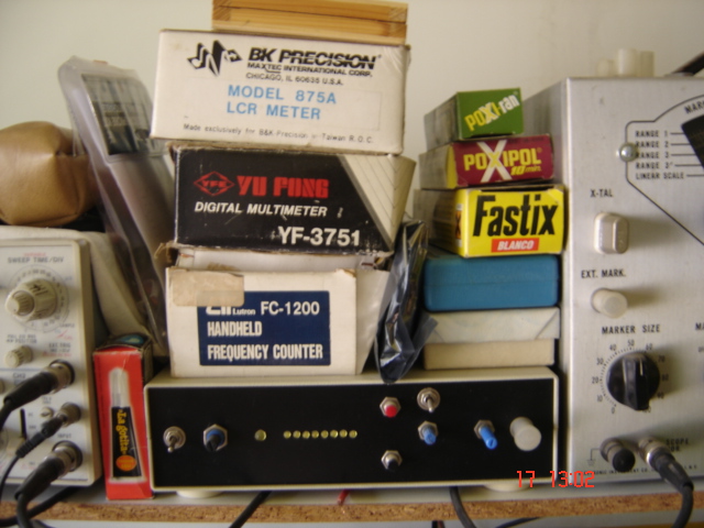

Coils OK
Ok, guy's. Thanks for your entries. Winding coils is not a trouble for me, I have wound thousands of them from those for AM 3.5MHz to toroidal transformers, passing though the AM regenerative receiver I had pasted. Also, I have coil formers and cores, and a LRC digital meter to aproximate the inductance.
