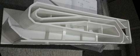

Cornu spiral BLH original vs Smooth Curve Ever think of building a Cornu Spiral horn? Now you can! - Page 3 - diyAudio
pdf plan for Cornu spiral by Planet10 can be found here: Foam Core Board Speaker Enclosures? - Page 23 - diyAudio
Micro 14in Cornu with 2in driver from Logitech S120 (Dec 2012):
Ever think of building a Cornu Spiral horn? Now you can! - Page 6 - diyAudio

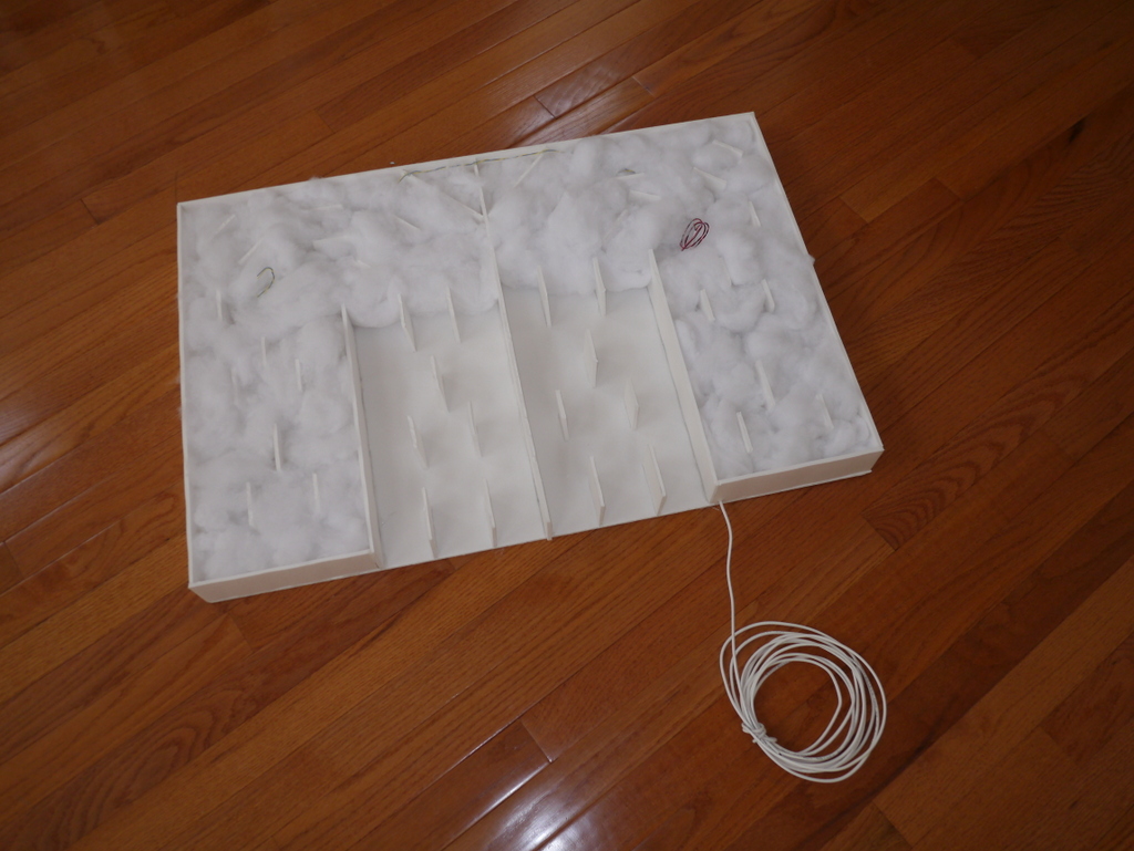

Flat wall mount stereo MLTL with Vifa TC9FD http://www.diyaudio.com/forums/full-range/223313-foam-core-board-speaker-enclosures-147.html#post3400954

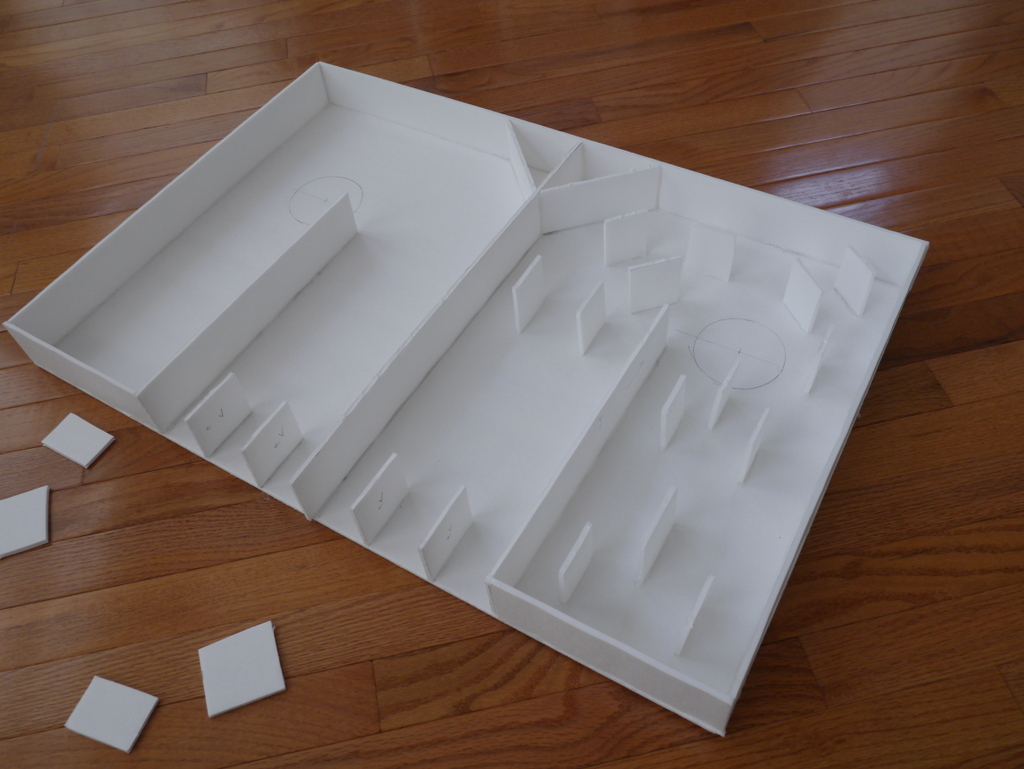

Flat BIB or FIB with Vifa http://www.diyaudio.com/forums/full-range/66173-terry-cains-bib-why-does-work-does-anyone-have-those-fostex-craft-handbooks-516.html#post3344893
FIB alternate without V channel http://www.diyaudio.com/forums/full-range/66173-terry-cains-bib-why-does-work-does-anyone-have-those-fostex-craft-handbooks-512.html#post3339813

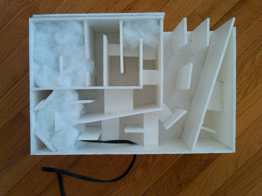

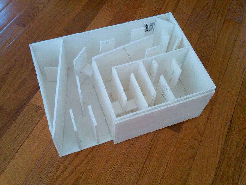

Folded bookshelf MLTL with Vifa http://www.diyaudio.com/forums/full-range/232778-fostex-fe83en-right-small-box.html#post3427671

Wall hanging foam core transmission line
I have started my stereo transmission line hanging picture speaker project. This was inspired by a design from: VIFAntastisch ! Der Wandlautsprecher, Projekte der Nutzer / Eigenentwicklungen - HIFI-FORUM which is for a single speaker and is made of particle board and pine strips. I decided to make it out of 20 in x 30 sheets of foam core board. The pathlength had to be reduced from 1.2 m to 1.0 m to allow me to fit two speakers side-by-side on a single foam core board. This tuning is for about 87 Hz. Now I await the Vifa TC9D speakers to arrive and finish assembly.

Wall hanging stereo TL's finished
I finally installed the VifaTC9FD's into the wall hanging 'picture' speakers. I hooked it up to the Lepai amp and iPod and tested with a variety of tracks. They sound fantastic, I mean really good. The bass is really nice, and the mids and highs have really good detail. The biggest surprise was the imaging given that they are mounted only about 2 feet apart in the same box as a stereo set. It is my first full range point source speaker and I just can't get over how good a pair of tiny 3.5 inch $12 dollar speakers and a box made of foam core paper and old pillow stuffing can sound. I am a true believer in full range drivers and TL's now. I am hearing details and sounds that I never knew were there before. The Vifa drivers are super in case anyone else hasn't heard them. Here is a photo of the new speaker propped onto some stools for testing. I need to have them decorated and put a picture frame wire for hanging on the back.

Back loaded horn bookshelf speaker
My next project for the Vifa TC9FD is a back loaded horn. This design is tuned for about 70 Hz based on a 48 in path length. I am using the plumbers putty in a sandwich between foam core for the front baffle to reduce any high frequencies that may re-radiate from the front. The enclosure is 5 in wide by 10 in deep by 15 in tall, as usual, the size is chosen to maximize cuts based on 20 x30 foam core stock. I am lightly stuffing some bends to clean out the highs from leaking thru. The driver chamber is heavily stuffed and has a throat area equal to the driver piston area, the expansion is modest, only about 5.7 to 1 but that is all the room I had in a bookshelf design. I pre installed some lamp cord straight thru - no binding posts for these cheapy projects.

Experimental foam-core backloaded exponential with 1:9 flare ready for side and bottom![]()
Which way does your driver point? Is this foamcore board?
