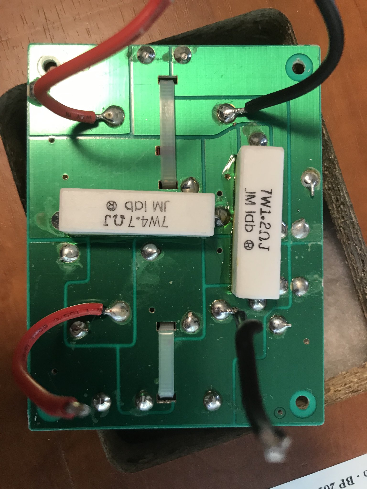

Hi all,
Recently bought a used Chorus LCR700 (built in 2001, I believe). The low frequencies are muddy and lack dynamics, mids sound shouty and nasally, and the highs are smeared and lacking detail. Please provide specific component replacement recommendations for the crossover. I aim to keep to this project under $100. Thanks!

Is the bass muddy without the XO?
Except for the bipolars not a lot you can do to that XO unless you redesign.

Here is a shot of the front. I haven’t tried listening without the crossover. I bought it used to work as my center channel. The tweeter surround is slightly damaged but without noticeable affect on its performance. That said, I would replace it if the price was right. The drivers are in perfect condition, with no signs of overheating or damage at all. Overall, the unit appears to be in good physical shape without signs of serious neglect or abuse.
When listening over a longer period, I can hear gradual changes in its sonic performance. Lows and low mids shift between more and less muddy/boomy. Highs seem to shift, too, and are quite grainy overall. This is why I suspect it’s electronics as the culprit.
With specific recommendations for upgraded crossover components (including brand, series, specs/parameters), I’ll install them and report what I find.
Thanks!

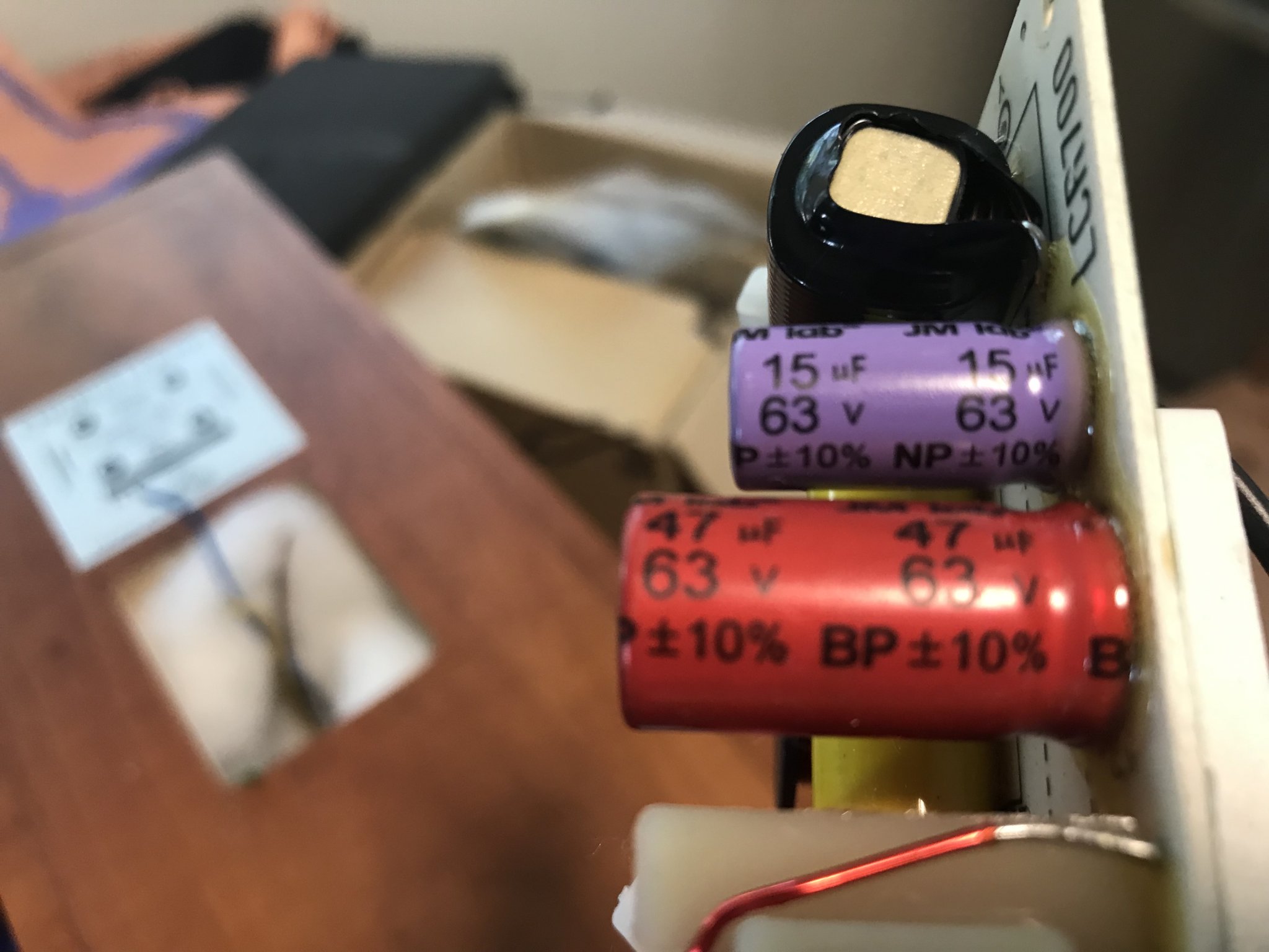

As to caps, i would get some black Solen plastic caps. you will not be able to fit them into the available space on the board so some creativity needed.
I also suspect the box is poorly braced MDF which can be improves.
Before messing with the XO i would ensure the problem not elsewhere first.

Just measure the elcos with a cheap LCR meter & replace if required with branded but non-boutique replacements.
Turn the drivers as you suggested to even out sag.
Play them until your ears burn in.
