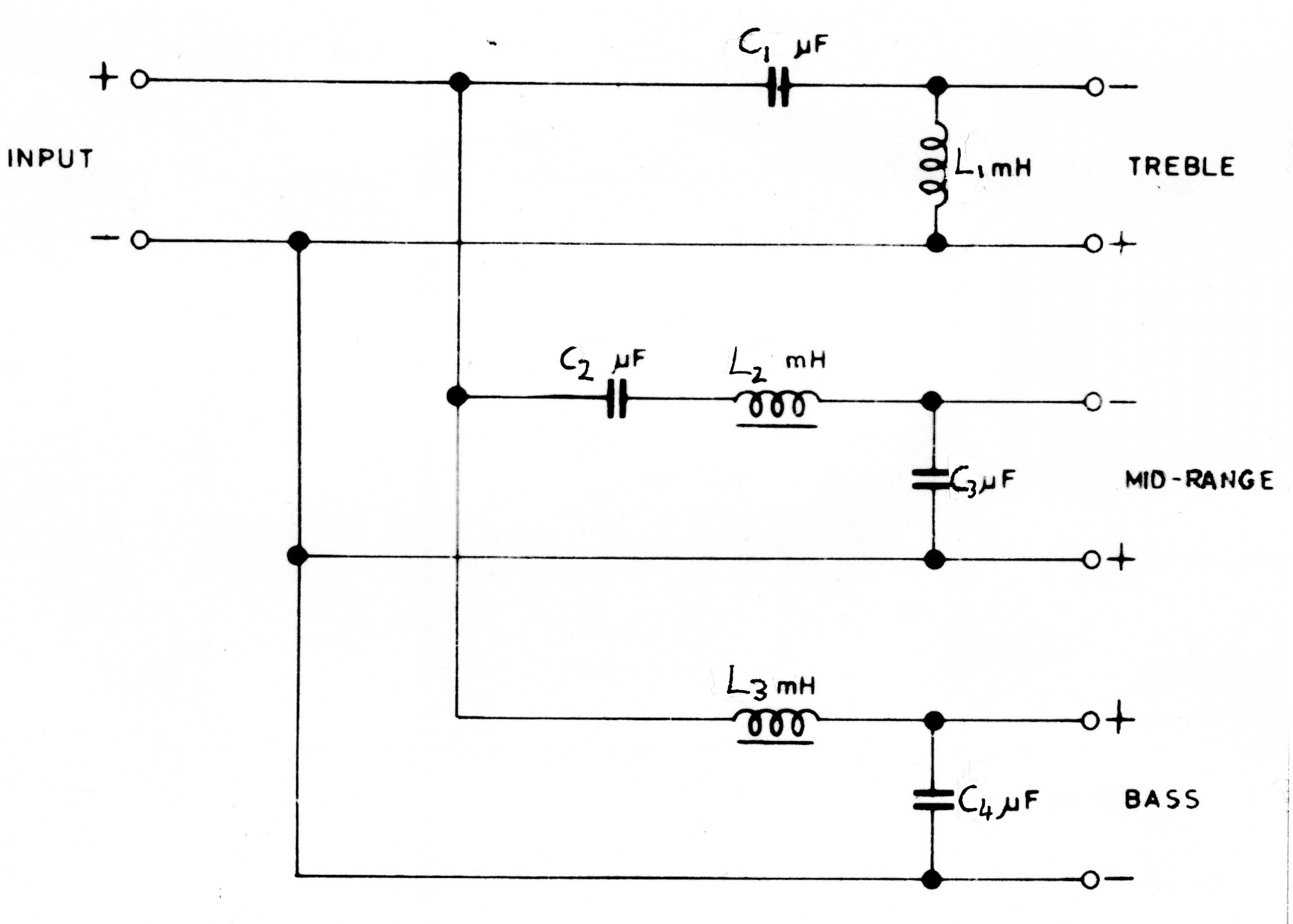

In a 2nd order crossover, the midrange driver should be connected in opposite electrical polarity to the woofer(s) so that they will be acoustically in phase.
Sometimes the tweeter is also wired in opposite polarity, so there is room for experiment there.
Whether it is desirable to replace a bipolar electrolytic capacitor with a film capacitor may depend on its position in the crossover circuit.
A bipolar electrolytic capacitor offers more 'series resistance' than the equivalent film capacitor, and that series resistance may have been taken into account by the crossover designer.
If you have a crossover schematic then post it here.
I attach a simple 3-way, 2nd order crossover schematic to emphasise the opposite electrical polarity requirement.

In this circuit, only the bass drivers are connected with reverse polarity.
That is the same as saying that the midrange and treble drivers are connected in reverse electrical polarity to the bass drivers.
Bass should always be positive connected.
That may be the norm, but I believe it is not essential as audio signals are AC and have no fixed polarity.
Would it make a difference to the working of the crossover I attached in post #7 if the input + and - terminals were swapped over to make the woofer electrically out of phase with the midrange and tweeter?

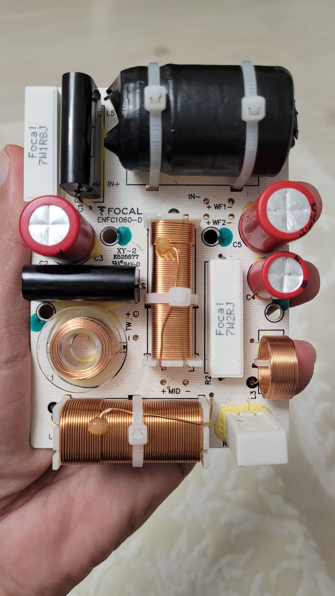

After replacing it with the original inductor, the bass frequencies became relatively louder. I was surprised that this was related to an iron core inductor. But my other original speaker seems to be better at the lower frequencies.
If I reduce the number of spirals in the air core inductor and lower its value from 4.6 mH to 4.4 mH, will there be an improvement in the lower frequencies?

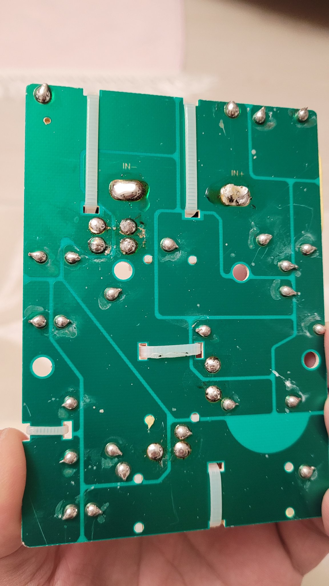

That is worse than useless and actually I feel insulted that you ask for advice, but don't want to put in the effort to reverse engineer the schematic.I don't have the circuit diagram but I'm sending you a photo of the original crossover.
First off, what made you decide to "upgrade" the filter? What components failed or could be improved?
Secondly, it is not normal what you see/hear. You "upgraded" the components with components with equal values. So something is out-of-the-ordinary.
The best way to start looking at this is have a schematic, understand the circuit. Connect a signal generator to the input of the filter and measure the outputs. Both with the bass speaker connected or a load resistor. A load resistor is not a good replacement for the complex speaker impedance, but differences in filter characteristic certainly show up.
Once you see these differences between the filter with old and new components. Check the schematic and see which components could have an influence. Then you could check the exact values of the components. With exact I mean inductance, R, magnetic field distribution and hysteresis. Both the old and the replacements. And lastly see if there is any interaction between inductors on the PCB. For air inductors that is different than for iron-core.
Any random changing of component values without exactly knowing the function or influence is useless. There are too many variables.
I must say that the original Focal crossover appears to have been built to a high standard.
E&E appears to have contracted a particularly virulent case of "crossovus upgraditus" which is doing the rounds on this forum!
To undertake such a task without access to a crossover schematic and measuring equipment is simply asking for trouble.
