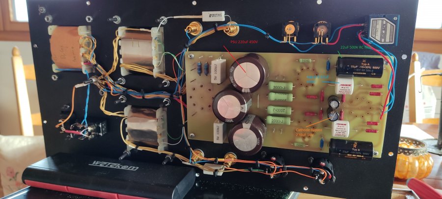

My amplifier uses 3x 220uF 450V capacitors for the power supply. I am looking to do some upgrades and I never looked at foil capacitors for those values because I thought they don't exist. However, they do actually exist.
Would there by any benefit in using foil capacitors over electrolytics for power supplies and cathode bypass? Provided there is enough space and they have the necessary capacitance and voltage.

Absolutely no advantage with the exception of a CLC type 5U4 or GZ34 rectifier. The cathode of the rectifier feeds the first capacitor known as the tank capacitor, usually between 4 and 8uF oil type. This then feeds the second capacitor through the choke. A 47uF electrolytic will smooth out the DC power. Any lumps or bumps are smoothed out by the reactance between the choke and feed capacitor.
Otherwise with silicon diodes, use what you like in electrolytic form. Bearing in mind the current draw from the transformer trying to fill up the tank capacitor. I have seen many transformer fail due to the value being too large.

Yes, less hum/ESR, higher ripple current, and no degradation with use.
To limit the peaks of the input current spikes, use a small resistor before the first capacitor.
You may not have enough room for the much larger film equivalents, though.

My amplifier has a rectifier and it doesn't have a tank capacitor.If you use a tube rectifier you need sub 50uf cap right after the tube.
It has 2x 22uF 500V RC filter
2x 0.22uf 450V signal
2x 220uF 16V cathode bypass
3x 220uF 450V power supply.
It has no capacitors after the rectifier. The 3 PSU caps are directly in front.
