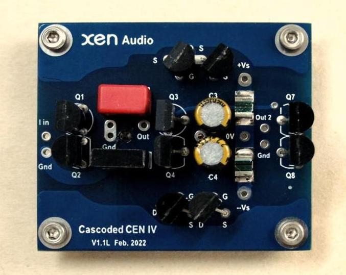

Exactly 11 years and 2250 posts after the original CEN IV, the simple circuit still have many fans and positive feedback.
But the difficulty of having to use floating power supplies remains.
Especially, if one is using 2 channel balanced mode outputs, 4 of these floating supplies are required.
https://www.diyaudio.com/community/...lution-of-a-minimalistic-iv-converter.195483/
The question has been -- is it possible to have at least similar performance but using fixed rails ?
In the original thread, the use of current sources between fixed rail and IV circuit has been discussed.
11 years later, with experience gained from the revised XCEN converter circuit, the puzzle has finally been solved.
So here you are. Happy Reading.
Patrick

Someone impatiently asked for PCBs :
https://www.diyaudio.com/community/...st-tht-i2s-input-nos-r-2r.354078/post-7111042
There will be 2 GBs given sufficient interest, one for through hole, another for the DIP8 SMD version.
Details will follow after Fran has published his audition.
Bear in mind the number of JFETs required for both versions.
It will not be the most cost-effective solution for an IV converter.

No floating supplies, nice Patrick!
I have been lucky enough to have a listen to both the SMD and through hole versions of this - my thoughts are below in hopefully enough detail but not so long as to be boring!

Through all of this listening over many sessions, the 3a5 DHT stage stands out as a real winner. Some others have more detail, or would certainly measure better, or may be less complicated builds with lower voltages, but it has sat at the top of the pile and it has been the benchmark - if a stage is at least as good as it, or better, then you know you have something that is really special.
The 3 devices being compared here were the 3a5 DHT stage, Patrick's prototype through hole FC CEN IV and the SMD version FC CEN IV. These were both powered from a diyinhk +/-15V supply (an older ultra-low noise unit). The IV is passive (500r resistor) for the 3a5 stage with voltage amplification by the valve.
The 3a5 stage first - you will already know the issues that exist with valve stages - they do not measure as well as solid state in general, and none more so than DHT valves which need either batteries for the filaments, or else a special supply. They are microphonic as well. However, in practice the sound is very appealing - deep holographic soundstage, very good resolution and spacing of instruments, full sound that is probably slightly on the warm side of neutral. It has a clean treble presence, and no hint of harshness or sibilance. It is especially good with vocals, and the projection from a centrally placed voice is really lovely. I suppose I can say it is a reference for me.
Next up is the SMD version FC CEN IV. Patrick built this for me, and as always did a really beautiful job in doing so. I set it up on a small piece of perf board, near the power supply so I could swap easily between stages. My test setup here is not ideal – long wires but that is necessary to allow change of stages. The SMD version warms up after a few minutes powered on and I waited for a few minutes before listening just to make sure everything was at equilibrium. In short, this output stage is at least the equal of the 3a5 stage which has been my reference. It does sound different than the 3a5, and is more neutral for sure, but it never strays into being hard or sibilant. For me, the key difference is that the vocals are just slightly more recessed with it compared to the 3a5 - but in saying that you have to understand that the 3a5 is probably more the odd one out here in that it is the unusual in how it projects vocals. If it makes my impression clear, I intend to replace the AC coupled output stage in a second build with this SMD version when I get a chance! It is very impressive.
On then to the through-hole FC CEN IV - how does it compare to the SMD version? It is very close indeed sonically, I would think that most people would not pick up on any differences between the two. I have convinced myself that it is just a tiny bit softer sounding, but do not take this as a criticism - there is full, accurate and deep bass, sparkling highs and everything in between. Soundstage is on a par with the SMD version. In truth I would fail a blind test miserably. So treat those comments with the skepticism they deserve - maybe this is a perfect example of confirmation bias. Also bear in mind this proto does not have the Sallen Key filter board either. If the goal of the through-hole version is to have an excellent sounding stage, that is on par with the SMD version, then I think that goal has been reached.

Hi thanks for tests.
FC Cen from the PDF seems to be a Current Device. If it is no I gin this is sort of Current buffer. If it is some Current amplifiacation that is sort of Current amplifier.
And I to V conversion happening at "external" R, with Idevice in between. Direct implementation on DAC Iout is avoided.
Q1: Is there some current amplification?
Q2: What phase is in Voltage @Riv at the output on FC Cen?
(Simple Riv @DAC-Iout turns the phase opposite, by 180deg... So optional SE gain stage have a same shift and brihng back the phase in 0 deg)

It is a current conveyor circuit, just like the original CEN IV, or the XEN current mirror IV, or the AD844 used as IV converter.
A current conveyor only convey the DAC current to pass through the IV resistor to generate a voltage.
So no current gain, Vout = I_DAC x R_iv.
A current flowing into the IV converter will generate a positive output voltage.
Patrick
Patrick
that is negative...The phase is the same as using a passive resistor at the current-out pin.
(if digital data bits are not inverted)
