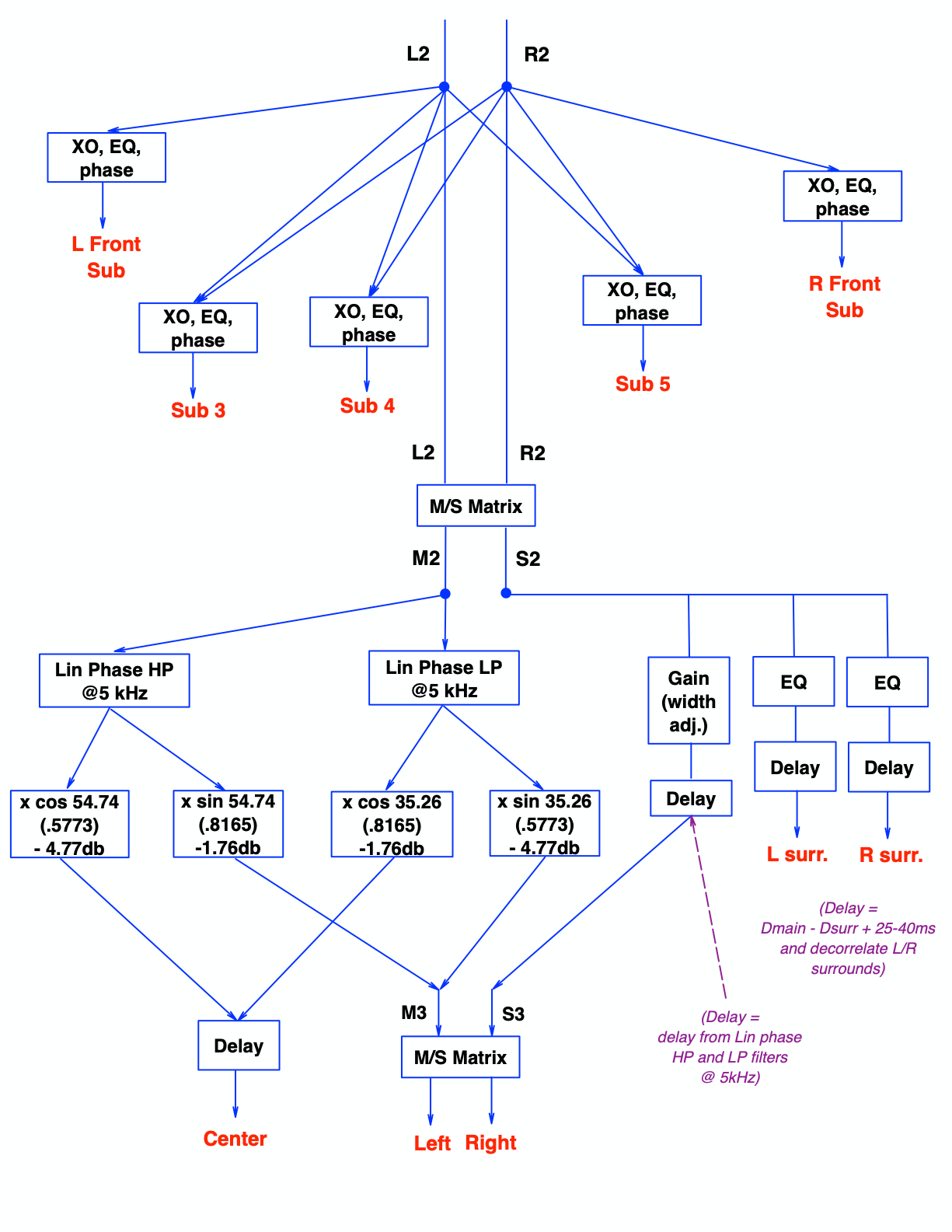

I worked through the Gerzon articles and patent recently and think his approach is this (ignore the subs and generation of the sides/surrounds). I have been trying to decide whether to try and implement this in software v buying a Meridian processor to get Trifield (the one implementation of his patents).
Nice !
Have you played much with where to set the lin phase hp and low pass filters? I still need to explore that.

Thanks.Nice !
And I wish 🙂. My listening room (wife would probably call a family room) is stripped down to the studs on the ceiling and front wall for acoustical treatment and I don't even have a center channel. Planning DIY LCR.
Though I did just take delivery of 3x Bliesma T34Bs, so hopefully will get there.
But yes, playing with the LP/HP frequency will be interesting. Gerzon actually mentioned linear phase filters in this role as desirable, though certainly difficult at the time/when he was alive.
