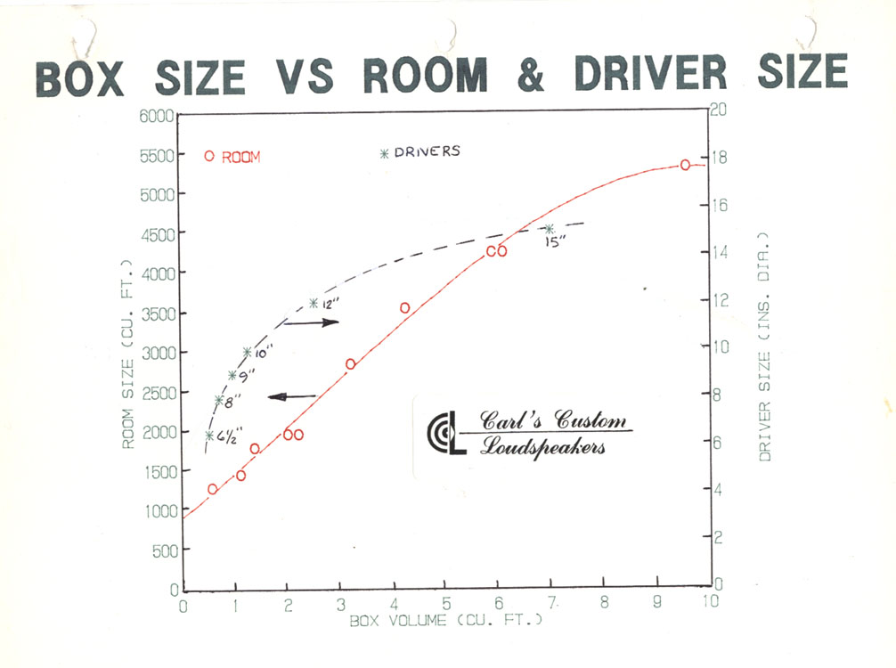

Is there a good formula for speaker size in relation to the room’s size?
I want to build some speakers that fit the room my hi-fi is in.

I find the B&W’s are to powerful, hard to explain the room somehow makes them sound muddy at medium volume, but this get less as I lower the volume, it’s as if the sound bouncing back at the speakers , I can’t explain it I’m no audiophile, I just like what I hear.
The rooms about 20 ft by 16 ft, and I listen between the 16ft walls. So sat in my chair I’m probably 12 feet from the speakers.
Anyone recommend a speaker size for those dimensions I could easily build?

Sorry I forgot to mention the TDL's , I had a Pair 20 years ago and loved them, I bought this pair , because I wanted to see if I could create another set with better parts.. they are tired, old and scratched .. bit like me , but somebody has to love them.. I will be taking them apart soon
Move the B&W's away from the back wall and side wall, until they sound right.
Its not rocket science, and done properly bass extension will sound better.
They must be on correct height stands, to work well.
Moving your chair away from the back wall will smooth bass.
rgds, sreten.

This is the problem, space I dont really have that much room around the speakers, one of the reasons I was thinking of going to a smaller speakers.
Smaller speaker with higher specs I think may help the room accustics?

I basically completely disagree. Your room is big for the speakers.
Try lining the ports with 1/4" open cell foam, length x 3xdiameter
to tighten up bass, And typically make rear wall distance ~ half
stand height and typically side wall distance ~ double, or more.
rgds, sreten.

Thanks I'll try that, I'll move the furniture around I will try it length ways as the longer walls have a door in the middle on both sides .. I'll set it up and take a picture..
There is a lot to be said for putting them (and yourself) in the right location. Upper bass and midrange will benefit from this. Bass is different, subs can help, but I'm speaking here in the interest of placement not bass extension. Small changes can be worth trying. Subtle, but not...
Once I have made the space I will retry my RTL Transmissions because they do suffer from cramped surroundings.. but like I said they need upgrades they have had "Bad previous owners"

I have swapped my B&W 602's for the old pair of TDL RTL 2's I bought to upgrade. I also moved the system so it now faces length ways along the room. First of all I still had the B&W’s attached and the move didn’t make any difference at all. Then I thought I would just test the TDL’s, what a HUGE difference! Tighter crisper everything , sound stage was not only there but the widest I had heard for a long time, however I did give the TDL’s a huge amount of air, 2 feet of space from the rear and side walls, I’m stunned,
That a 20 year old pair of , (let’s face it) entry level priced floor stand speakers, can sound so good !. I was so shocked I asked a friend of mine who introduced me to better quality sound if he would pop around and take a listen to the new setup. When he did he didn’t believe me that I had simply moved things around, we had discussed a quite expensive upgrade for the TDL’s when I bought them off eBay , so he automatically assumed I had done the upgrade ,even though we had both sat and auditioned the TDL’s only a week ago on exactly the same system and decided that they sounded a lot better when I had the first pair..lol He simply couldn’t believe they were the same speakers.. its amazing. When we shared a house back in the uni days, we had a huge Edwardian front room with just our stereo equipment in, they had loads of air.. right from the start so this is why we were so stunned at the beginning when we first hooked them up, and also why they conjure up so much nostalgia now.
Anyway I have done a rough pic of the before and after layout.
