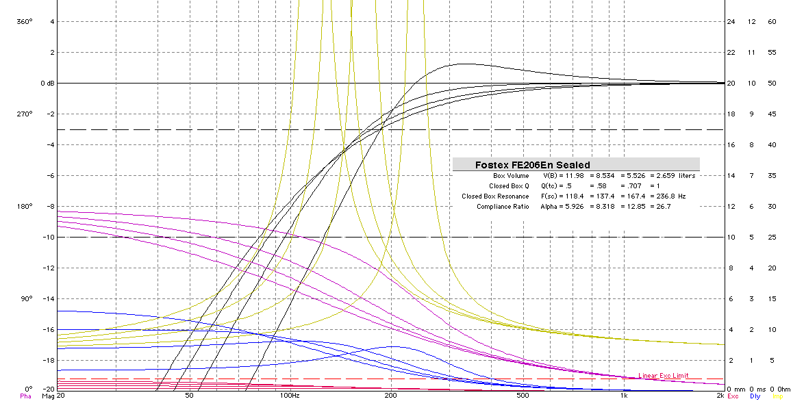

If you are willing to add woofers then put the FE206En in a sealed box (midTL or OB trickier) and add a woofer on each side. Bi-amping gives way more choice. The FE206En goes low enuff (167 Hz XO in a damped 5 litre with a butterworth roll-off) that some plate amps can work.
