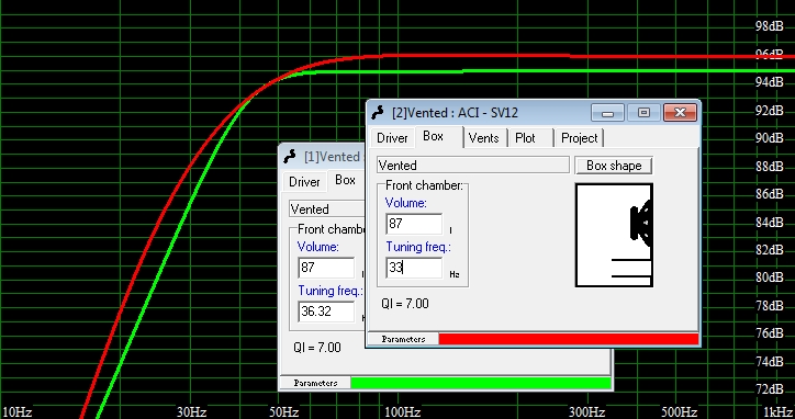

FWIW the only driver I could find that seems to suit is in a whole different price ballpark, 7mm xmax
: MCM Audio Select 12'' Die Cast Professional Woofer - 350W RMS | 55-2982 (552982) | MCM Audio Select
Attached fostex in green, MCM is red (not bad for $50), in your boxes :

MCM suggestion for 3.1 cf box
Sreten: Thank you for that detailed suggestion. That MCM woofer looks like a very strong performer, and is a real bargain at 1/4th the cost of the Fostex. Do you (or anyone else) have positive any experience with the MCM brand? That particular cast basket looks like a rather common item used by several other manufacturers, which is probably a good thing.
At that price, I could actually sell the existing mint condition NHT 1259 woofers for more than the cost of the MCM units. (The NHT won't play anywhere near high enough to crossover to the midrange horn)
Thanks again!

Question for Sreten on MCM woofer
Sreten: On the graphs you attached showing the MCM woofer versus the Fostex, the picture shows a vent. The individual boxes are not active when I click on them to get details about the vent. If that is a vent that is required would you mind telling me the size and length? In general, I have always preferred the sound of sealed woofers, but in this case that woofer has to match up to efficient compression drivers mid and treble. (JBL)
Thanks again!
