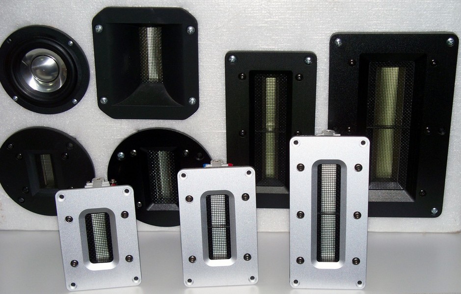

Hello Alex! what kind of measuring do you need? isn't it enough for make a choose into Fountek web site?
I used any type of ribbons and sure - all of them is good things, but you have match it to each loudspeaker progect and for person - to each his own
concerning measuring - I prefare consider about official ones only. not from someones and somewhere
Fountek and RAAL aren't in same league
I think so. 🙂 same as flowers - each ones is different. or you mean RAAL is expencive and brave, but Fountek is simple, cheap and poor?

I see, but cheapest - do you mean CD1.0?
my favorite is CD3.5H, but now I'm impressed of NeoX2 and will ask Mr. Max Ding to equip it horn - like cd3.5H 🙂
about frequency range - I 'm always use 2.5-3.2kHz for Fountek ribbons. usuale 3order crossover, sometime 2order.
for advanced loudspeaker I used CD2 before, but will use NeoX2.0 since its appeared

The new Founteks look a real step up, off axis looks good. Noticed that the 'old' CD1.0 can now be had for less than 45 euros.. seriously good value.
