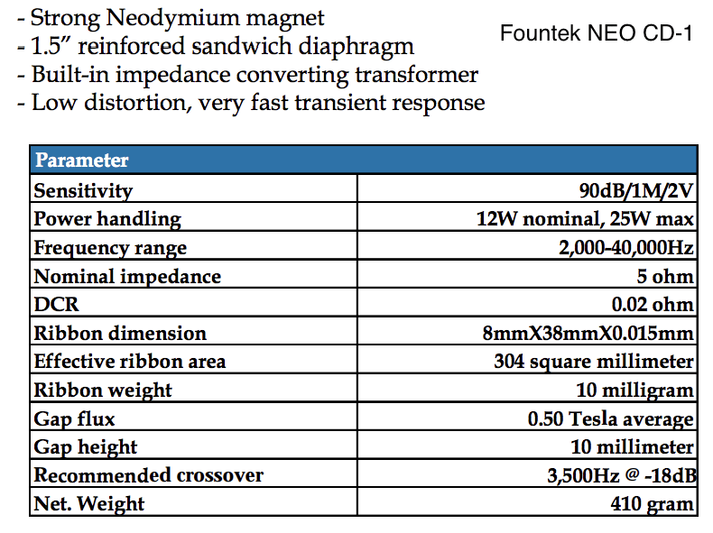

I have a pair of Fountek NEO CD-1 ribbon tweeters. I can't find any crossover design which uses them, and not being skilled in crossover design I don't know what to do with them. All I know is that they are supposed to cross over at 3.5K or above and preferably 18db Xover.
Would this drop into a design for a 19mm tweeter, for instance? They are 5 ohm and 90bd sensitive, so surely usable. Hopefully in a 2-way crossed over to something like a 135mm or 150mm mid-bass.

The mid-bass is indeed the issue, as well as the crossover point. Looks like the xover needs to be around 3.5K. That points to something like a LS3/5A clone or equivalent 2-way. I have a pair of tall cabinets 16litres looking for a build and I want to see if a 150mm mid-bass would work in that volume. I also have a pair of 10 litre cabinets. And by 150mm I also mean 135mm units with narrow metal surrounds like the B110 types, which are in effect 150mm because the SD is 80 to 95.

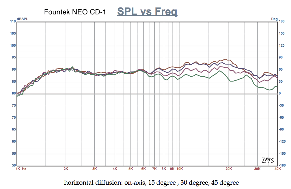

Yeah it just won’t disperse the same. Ribbons, Planars, AMTs and other exotics tend to have great horizontal dispersion, but almost no vertical. It’s why I like the 1.0 up close while a lot of larger designs prefer the Neocd 3.0 or 2.X models. I like these better than most of the domes I’ve heard in my life, but I imagine they’re just poorly made and implemented commercial designs and I could be convinced by one of these intermediately priced SB Acoustics or SEAS domes to be honest.
I do listen nearfield, so I think I can cope with the vertical dispersion of ribbons.

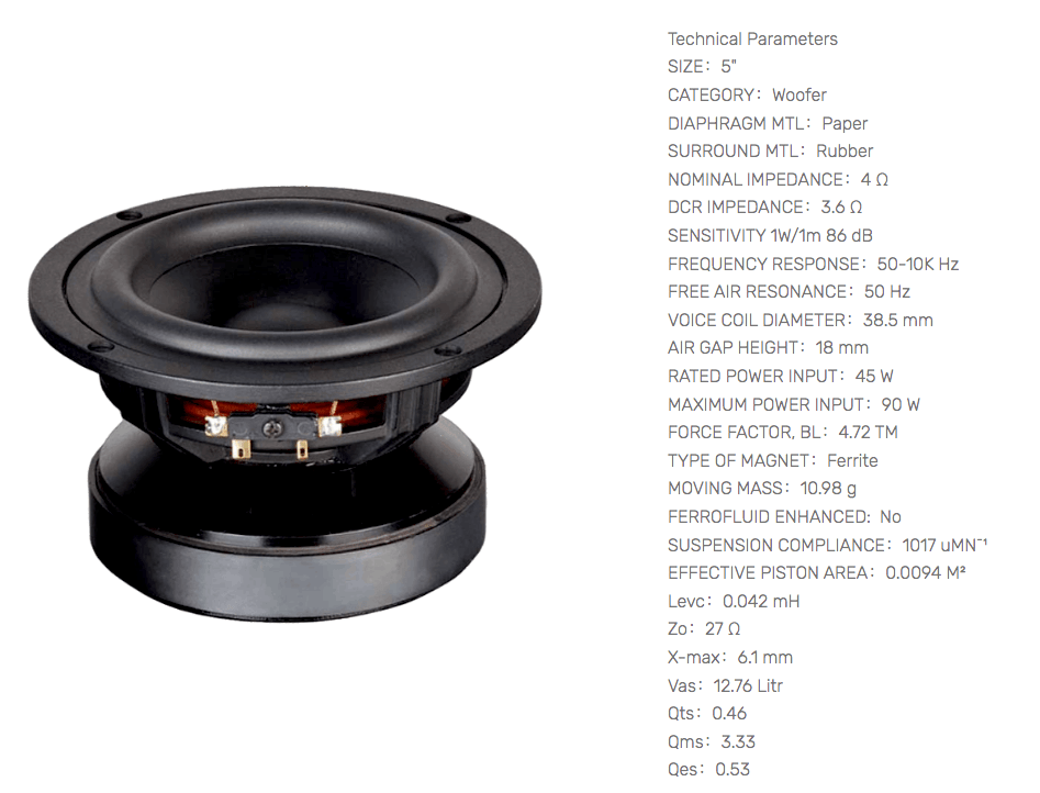

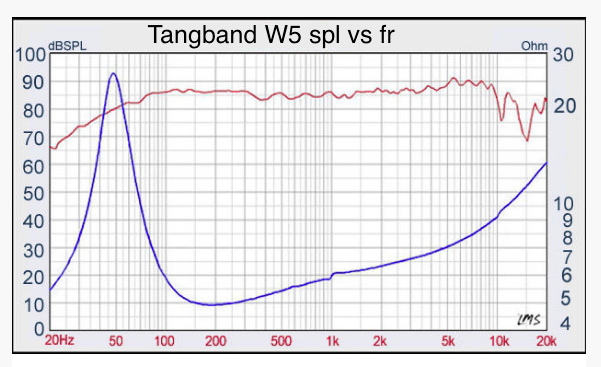

If I were to take another stab at the Speedsters, instead of making them 2.5-ways I'd consider using the 5" or 6" equivalent midwoofer. Both have clean frequency responses across a ridiculous 50-5000hz at least. They also make a stunning 8" I've considered building a bass box for. As prices increase across the board, I've lost a sense of value and have spent my money on more practical pursuits. The 8" used to be about a hundred dollars four years ago.
http://www.tb-speaker.com/products/w5-1685
http://www.tb-speaker.com/products/w6-1721
http://www.tb-speaker.com/products/w8-1722b OR http://www.tb-speaker.com/products/w8-2096b

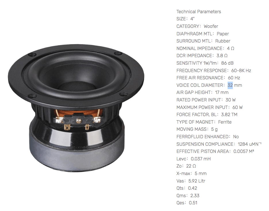

The 5" may not be "Drop-in perfect" but you can tell they're built for the same thing. I'd try it with a decent mic setup and some VCAD simulations if possible. The baffle will be no small task, but my guess is off-axis won't suffer with the 5" replacement.

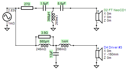

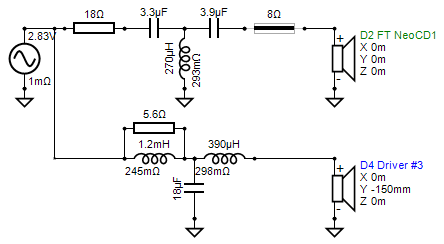

I don't have a lot to do today. Maybe I'll just throw up a sim and see what it looks like.

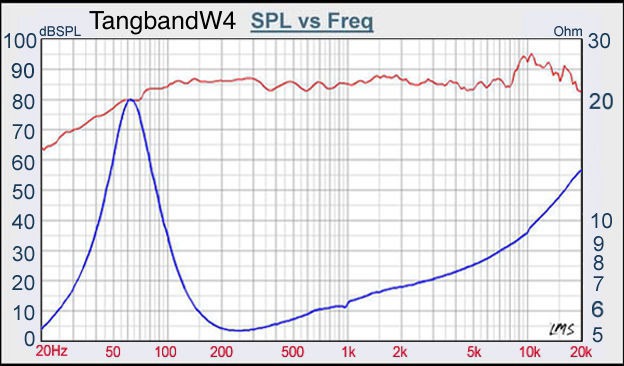

D1sco. A sim would be appreciated, thanks. I'm going to build one or the other, W4 or W5. All the buzz is about the W4 1720 - that seems to get all the praise. The Napoleons and The Neutrino are 2 more builds with it, plus the Rhodium mentioned. Maybe it's the case that the midband and integration with the ribbon are just superior to the W5. Anyone know?
There's almost nothing on the W5 except a design here: http://tb-speaker.com/products/sug2-22

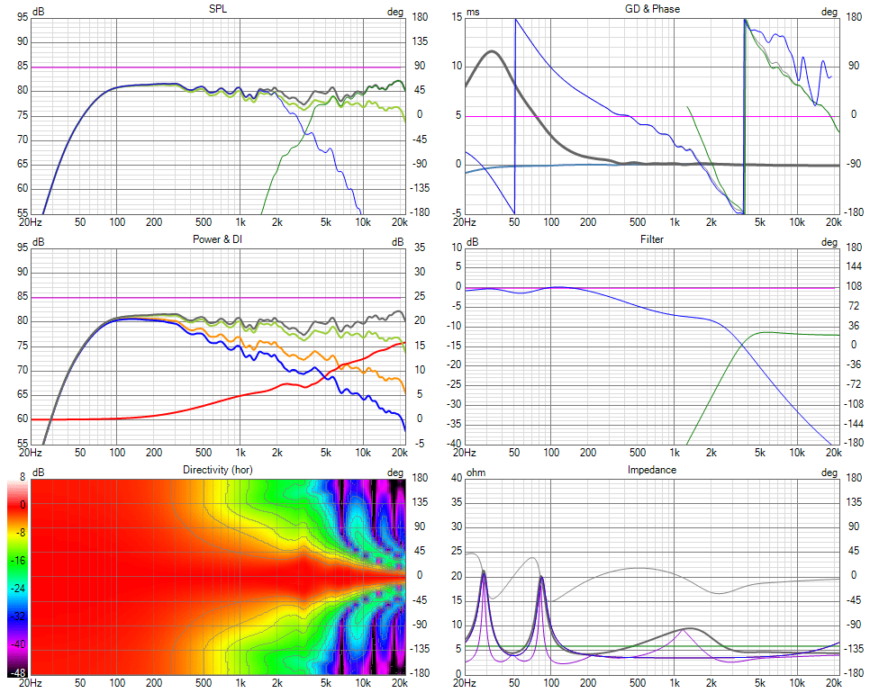

So far-- A reasonable bass response will take up to double the enclosure size. It will still peak at ~50W, but will go 5-10hz deeper. I'm frankly amazed at how well it worked. Simple plug and play, actually.

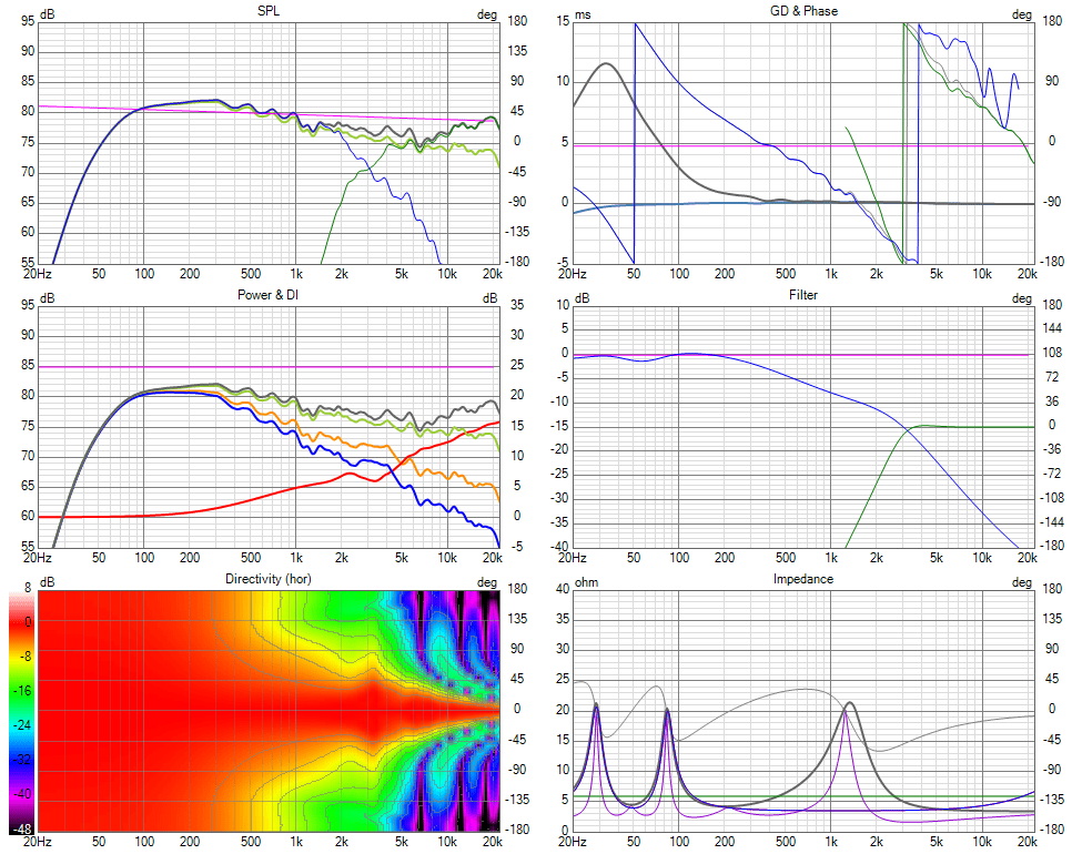

Some funkiness occured with the impedance. I solved this by adding a resistor atop the first order inductor of the woofer's third order filter. Otherwise the midrange is a gigantic soup bowl. The optimized version is pretty low sensitivity-- I imagine that's a choice most people would prefer making in EQ, but the more standard crossover does tend somewhat bright for some tastes otherwise.
--I am absolutely not a crossover designer and someone who is may say my designs will explode or something and you should take their word over mine.
VCAD's preference score adjustment:
Thanks - interesting. I'm absolutely not a crossover designer, no idea beyond the basics. Is the W4 1720 still the preferred choice or could the W5 1685 be a contender?

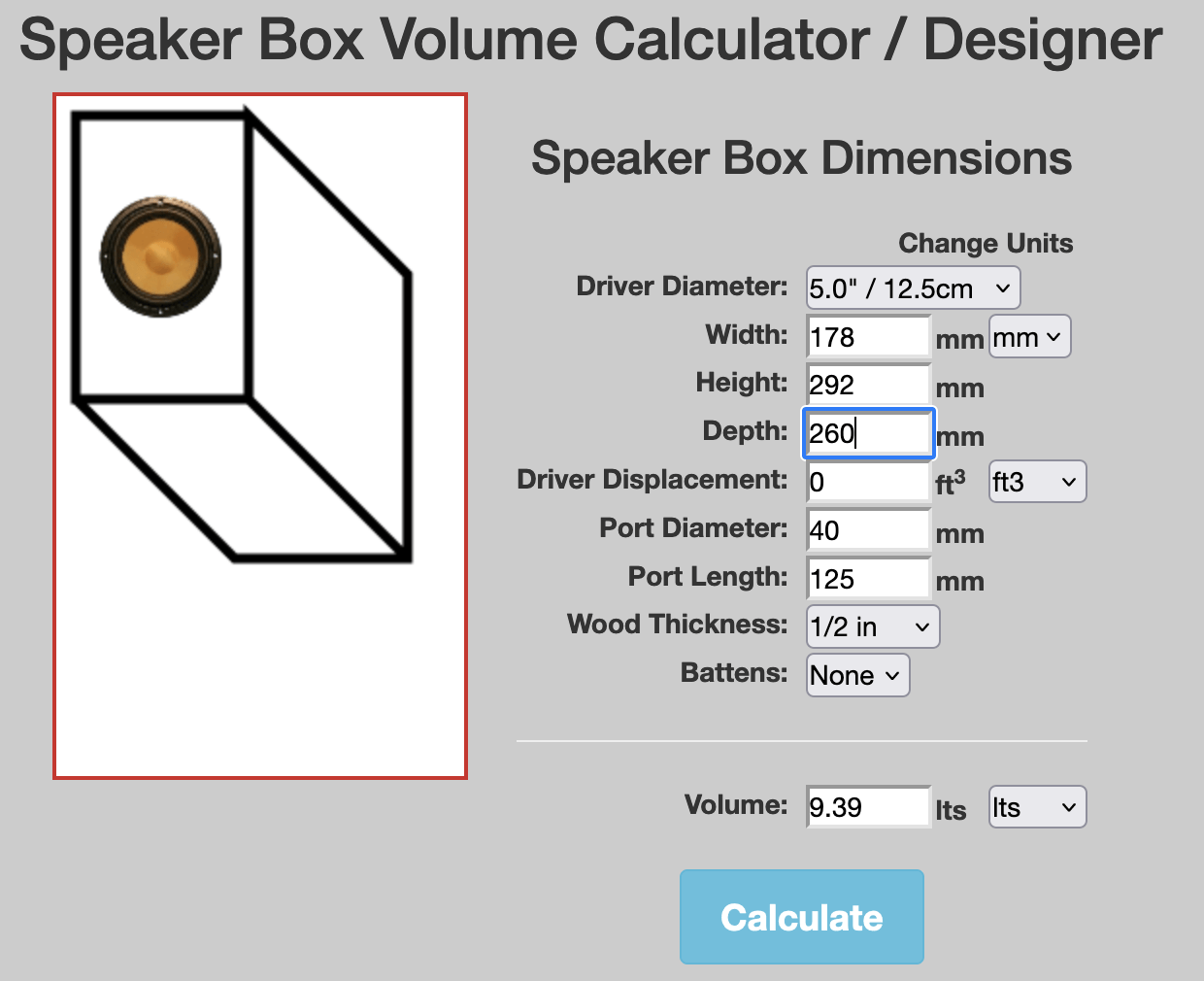

Just build the Speedsters as designed unless you feel comfortable diving into the unknown. I literally whipped this up in an hour. There's no way to know until someone does it. I still have the Speedsters two feet from each ear, not the larger version.
EDIT: For the record, this is the box.
