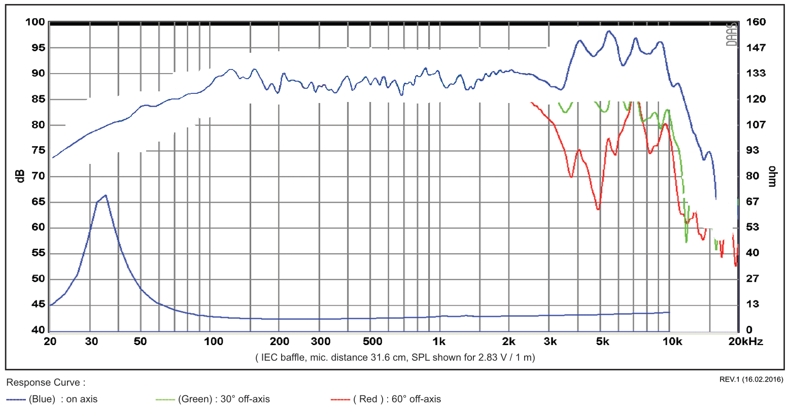

1. find manufacturer frequency response curve in high resolution, i prefer pdf file instead of jpeg.
2. convert pdf to to png (many free website to do this for free). this why step 1 for pdf is better because JPEG file has dirty image around the line. the "white" on the screen you see, when you zoom it will show many artefact
3. load png file from step 2 to FPGraphTracer, click 8X zoom button and zoom to the line that you want to trace. once you click it, look at the trace that it created (usually in pink line). if you find it hard to get a good curve tracing compared to datasheet, go to step 4.
4. edit the png and clear any dots around the curve that you want to trace, the purpose is to get a clean curve without any artefact. I do this using MS Paint, zoom it to max 800% and start Erasing pixel by pixel

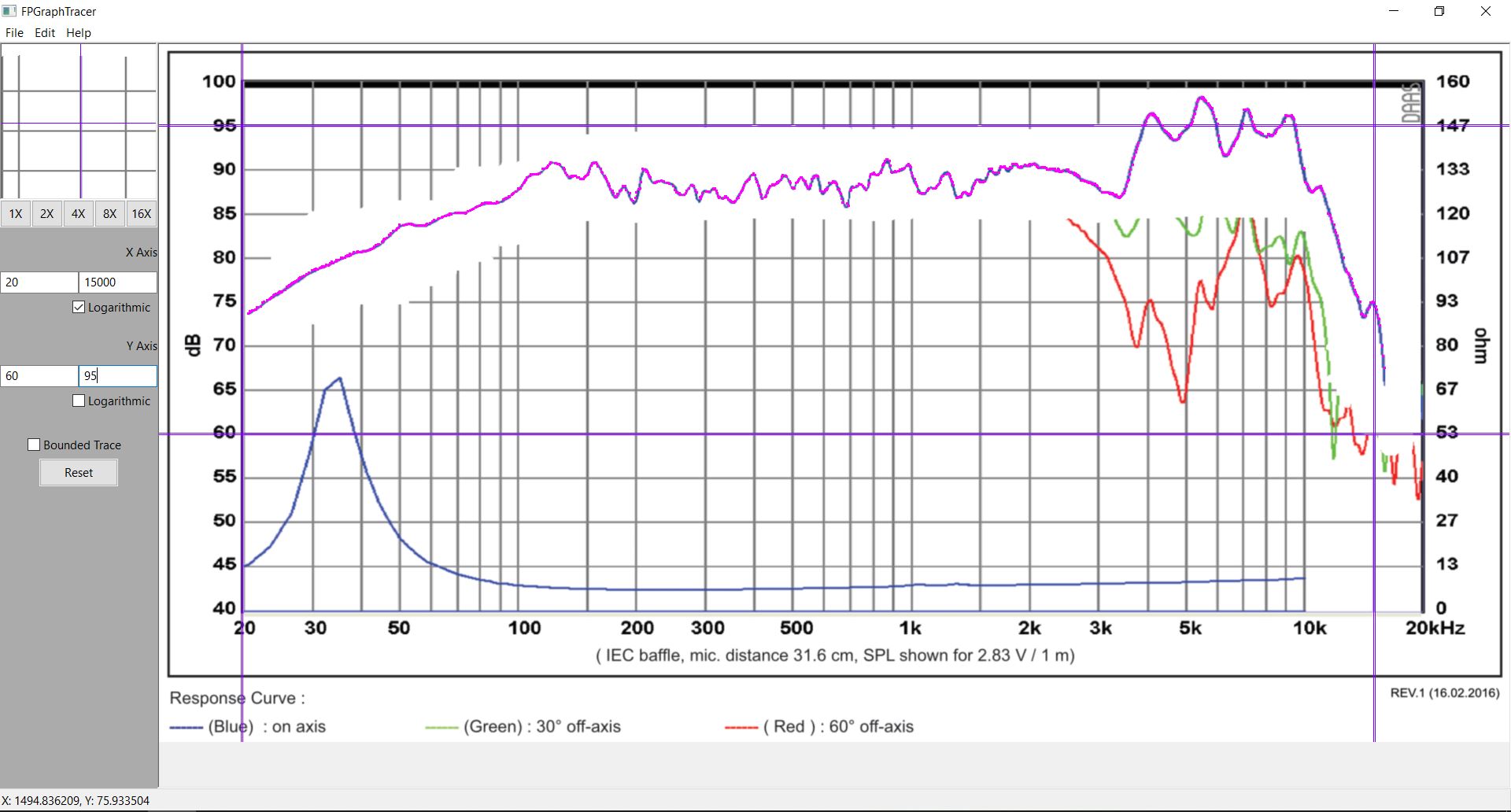

this is my project to trace SB17NRX, all artifact around the curve have been cleaned. started from Axis response
5. repeat step 3, move vertical and horizontal pink line to match with graphic and set X and Y axis min/max on left menu. my below example, vertical line is set to 60 and 95 (this is for SPL) and horizontal line to 20 and 15000 (this is for Freq). then save to .frd file. there are 3 group of data, first is Freq then followed by SPL and followed by Angle

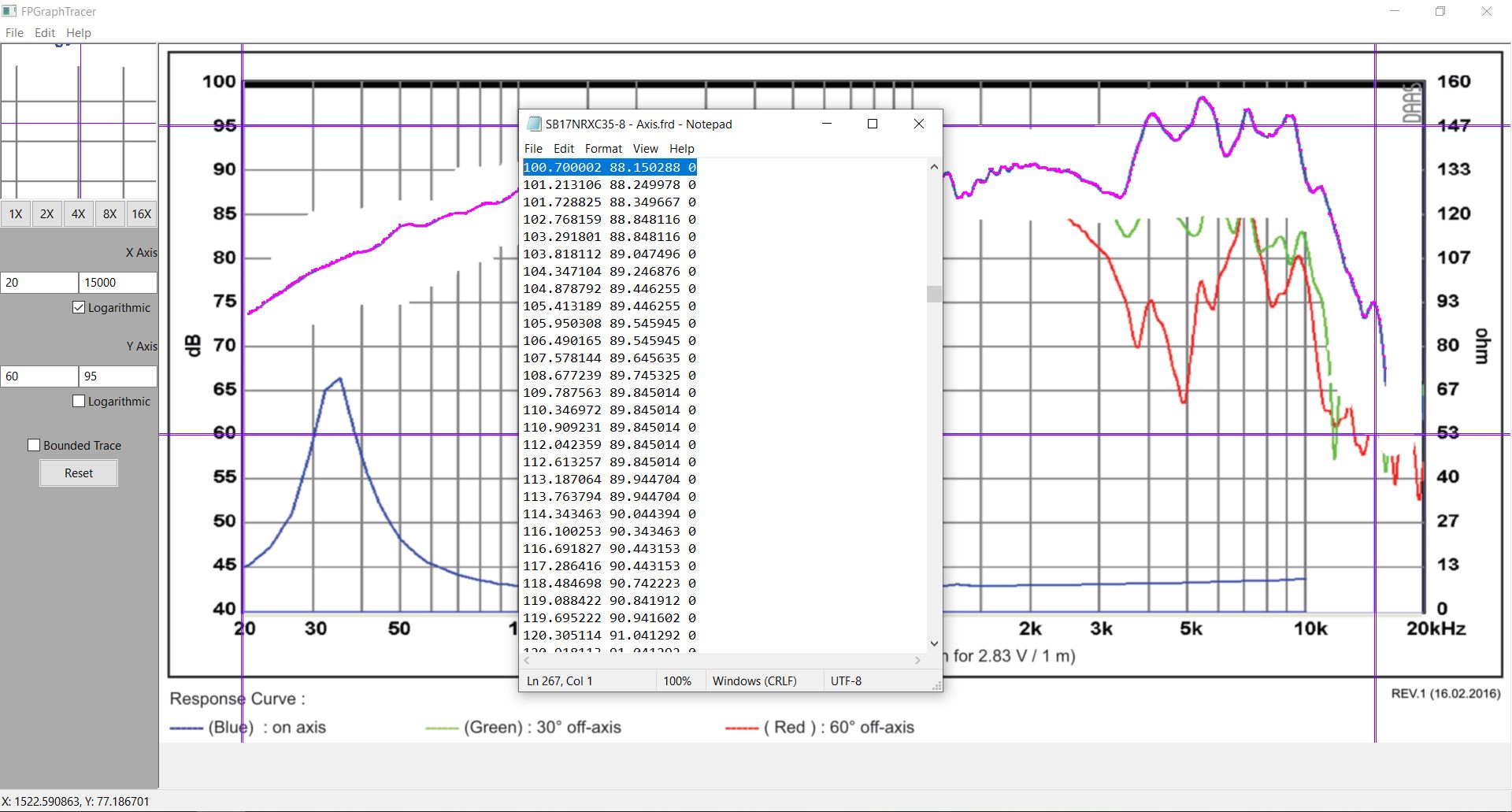

6. data verification, this is the most important step. open frd file using Notepad, choose any Freq point on graphic and compare to the number on frd file. my below example is : choose 100Hz point and check on number that is shown as 88 which verified by my eyes to the graph is around that, mission passed. you can sample as many point as you need

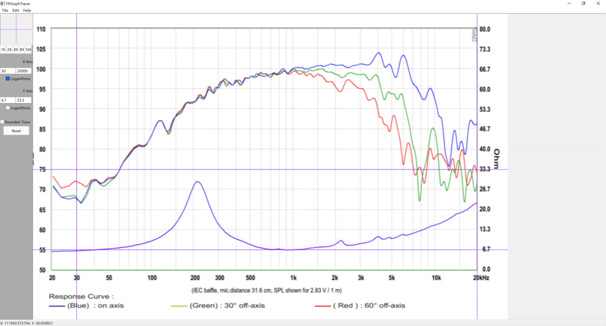

Where would I set the lower limit for the impedance axis (vertical)?
In the picture I've set it to 1 ohm but I know that's not correct. Problem is 4 is too high (impedance drops to 3 ohm). Setting to 0 gives an error when I try to load the file. And dropping the border on 0 and setting the value to 0.001ohm results in a clearly incorrect trace.
Joined 2003
Use 4 ohm. The trace does not need to fit within the limits, the two points are simply reference points to determine the chart scale. For best accuracy, use two points as far away as possible, so 4 ohm and 64 ohm in your photo.

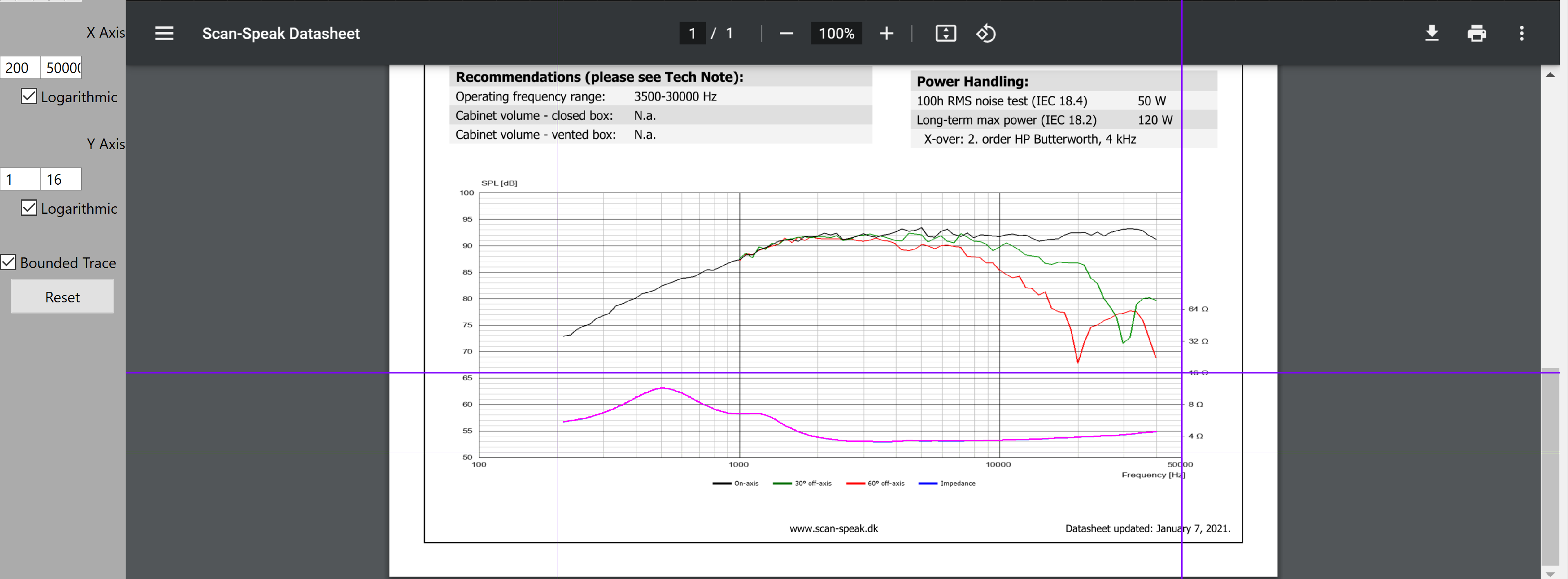

What am I doing wrong? I keep getting a nearly flat impedance curve when i open the file in Xsim.
What am I doing wrong? I keep getting a nearly flat impedance curve when i open the file in Xsim. View attachment 1012178
- try to set Y axis from 0 not 6.7
- open exported file using notepad and verify the numbers, or copy that into xlsx and plot the result
either it's wrong when you export it or issues with Xsim
