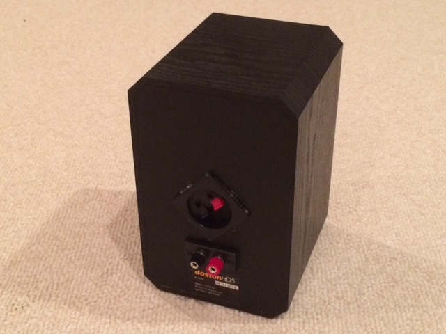

I have an old pair of Boston Acoustics HD5's with rotted foam woofer surrounds lying around for past couple of years. Always been meaning to replace the surrounds... I got some new Aurum Cantus AC130F1 drivers in the other day (same ones used in Jeff Bagby's Continuum, the advanced tech redux of the LS3/5A) and I needed a box to test them in. The HD5's were a perfect fit. They actually sounded almost passable when hooked up to the stock XO and paired with the 3/4in mylar dome tweeter. So I got to thinking, what if I swapped that tweeter for a nice 2in full range driver, and active bi-amped it for a very cute little FAST desktop monitor. Cute because the boxes are 6.25in W x 9.5in H x 7.0in D.

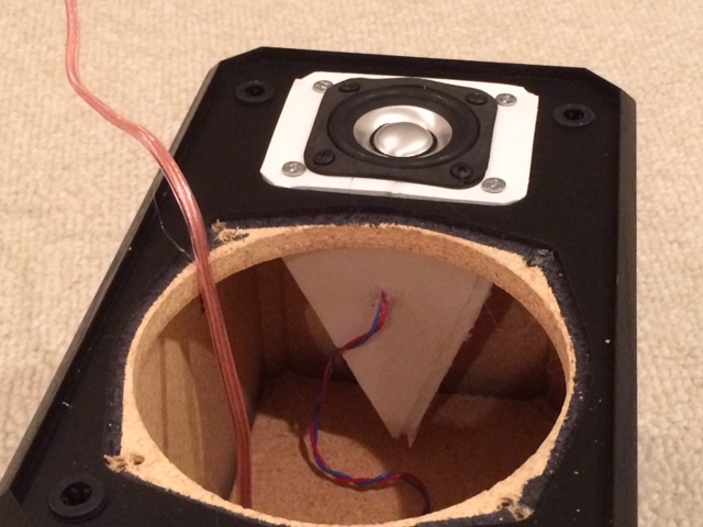

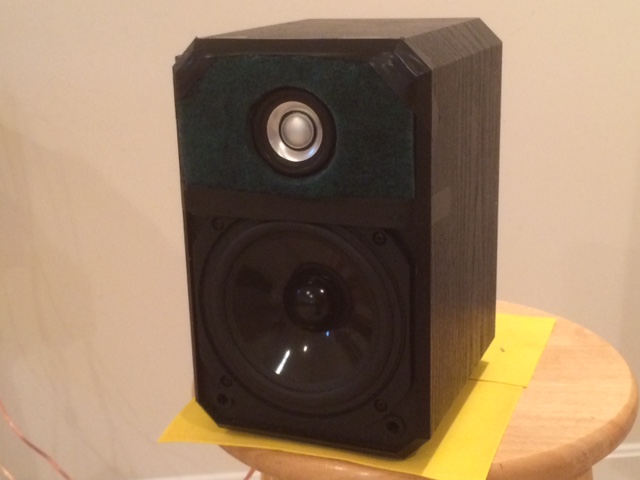

I made a small 4-side Dagger for the FR58EX (3in base x 5.75in high foam core panels x qnty 4), stuffed tightly with polyfill. I went with 4 sides to make the volume larger and to accommodate the square cutout for the tweeter. I removed the stock terminal cup/XO board and replaced with a plain terminal cup. I added a 5-way banana post binding terminals for the woofer. Stuffed the box (circ 5.7 liters) with stock polyfill and added some more for good measure.
Here is a photo showing the detail of the Dagger as mounted with the FR58Ex:
Here is a photo of the completed speaker front:
Back showing the terminal cup and binding posts for bi-amping:

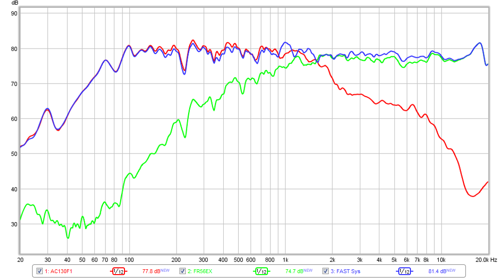

Here is the measured acoustical crossover plot. The relative sensitivities of the the FR58EX an AC130F1 matched perfectly, no gain adjustment was needed. There is some mild EQ to get the responses sort of close to a 1st order and to flatten the response a bit.

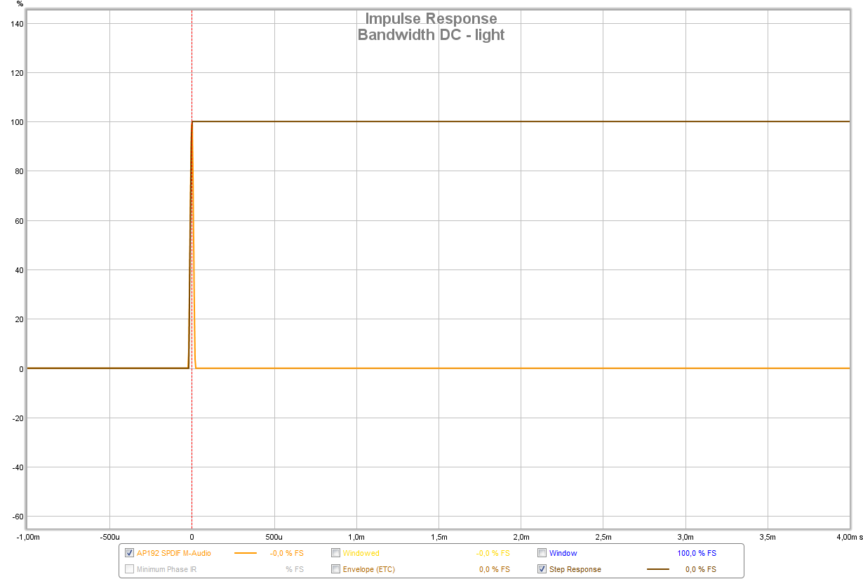

Here is the resulting impulse response and step response. IR is very clean with little overshoot and just a little bit of fuzz which may be reflections from the driver mount and cabinet lip. The SR is indicative of a transient perfect speaker with a right triangle shape. Dare I say it, can a Continuum do this trick? Don't think so with LR2 slopes - the leading edge is probably negative going:

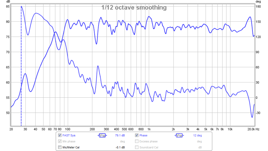

Here is the measured frequency response and phase, pretty linear within a 30 deg band:

I have some Fountek FR58EX's (thanks to Byrtt!) lying around from the recent data collection for the Round 5 of the Subjective Blind test thread. They sound like aluminum dome tweeters but can be crossed very low as they have an fs around 150Hz. One of the nicer aluminum drivers that don't ring. The AC130F1, is one of the nicest mid bass drivers I have tested - it has a super flat response, not unlike a ScanSpeak 10F, but only goes up to 10kHz and has no cone break up peaks.
![506251d1443345174-fr56ex-ac130f1-micro-fast-fr56ex-ac130f1-fast-03.png](https://www.diyaudio.com/forums/attachments/full-range/506251d1443345174-fr56ex-ac130f1-micro-fast-fr56ex-ac130f1-fast-03.png)
![506253d1443345174-fr56ex-ac130f1-micro-fast-fr56ex-ac130f1-fast-01.png](https://www.diyaudio.com/forums/attachments/full-range/506253d1443345174-fr56ex-ac130f1-micro-fast-fr56ex-ac130f1-fast-01.png)
![506252d1443345174-fr56ex-ac130f1-micro-fast-fr56ex-ac130f1-fast-02.png](https://www.diyaudio.com/forums/attachments/full-range/506252d1443345174-fr56ex-ac130f1-micro-fast-fr56ex-ac130f1-fast-02.png)

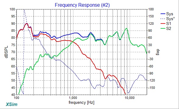

![506254d1443345174-fr56ex-ac130f1-micro-fast-fr56ex-ac130f1-fast-xo.png](https://www.diyaudio.com/forums/attachments/full-range/506254d1443345174-fr56ex-ac130f1-micro-fast-fr56ex-ac130f1-fast-xo.png)

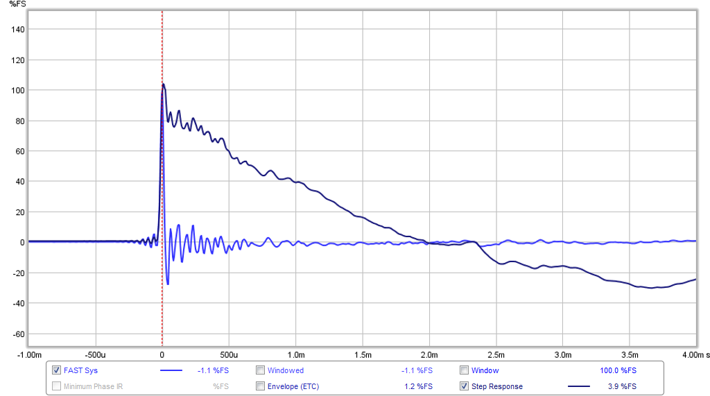

![506255d1443345174-fr56ex-ac130f1-micro-fast-fr56ex-ac130f1-fast-ir-sr.png](https://www.diyaudio.com/forums/attachments/full-range/506255d1443345174-fr56ex-ac130f1-micro-fast-fr56ex-ac130f1-fast-ir-sr.png)
![506256d1443345174-fr56ex-ac130f1-micro-fast-fr56ex-ac130f1-fast-phase.png](https://www.diyaudio.com/forums/attachments/full-range/506256d1443345174-fr56ex-ac130f1-micro-fast-fr56ex-ac130f1-fast-phase.png)

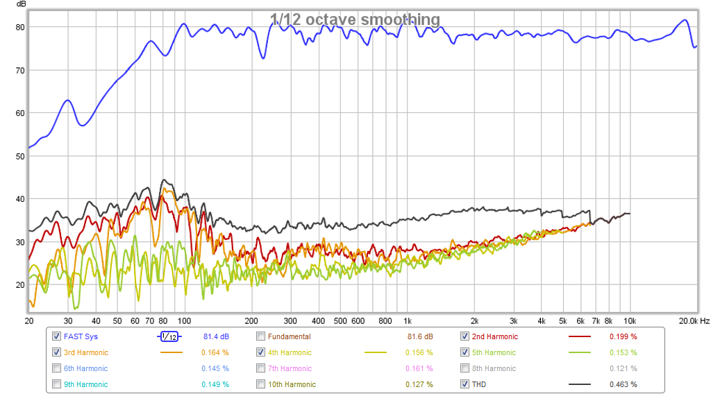

And here is the harmonic distortion:
![506257d1443345174-fr56ex-ac130f1-micro-fast-fr56ex-ac130f1-fast-hd.png](https://www.diyaudio.com/forums/attachments/full-range/506257d1443345174-fr56ex-ac130f1-micro-fast-fr56ex-ac130f1-fast-hd.png)
I listened to a few songs and it sounds really good. It renders percussion like it was meant to be heard. Below are some sound clips to demonstrate the time accuracy and also vocals so you get the sense of the balance in the voicing. Change .asc to .mp3 to listen.

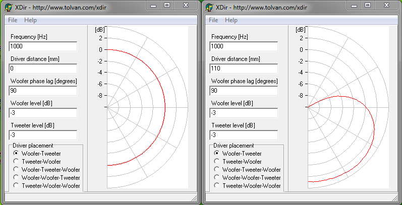

Phase trace for AC130F1 looks like textbook in the 90º lag point is around low 90Hz area just as a simulation program predicts.
Phase trace in 1-2kHz area takes a little dip if one virtual smooth it by eyes, think that could indicate some fine tuning could be worth looking into, its probably the spl difference between LF and HF but could be slopes precision or actual XO point too. Electric XO point set at 1kHz but looks more like 1500-1800Hz acoustic, attach below how XO area vertical lobes look like with unsymmetrical lobe that BW1 always 90º apart phase perform for 750/1000/1250/1500/1750/2000Hz, guessed ctc distance to 110mm by looking at picture.

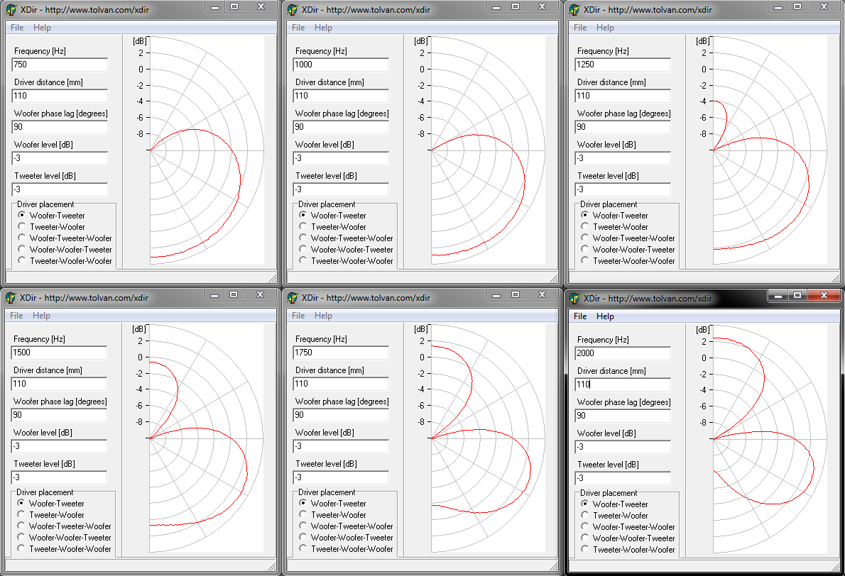

Second attachment is vertical lobe at 1kHz if drivers in phase at XO point as with even order filters and guess Harsch would be as that.

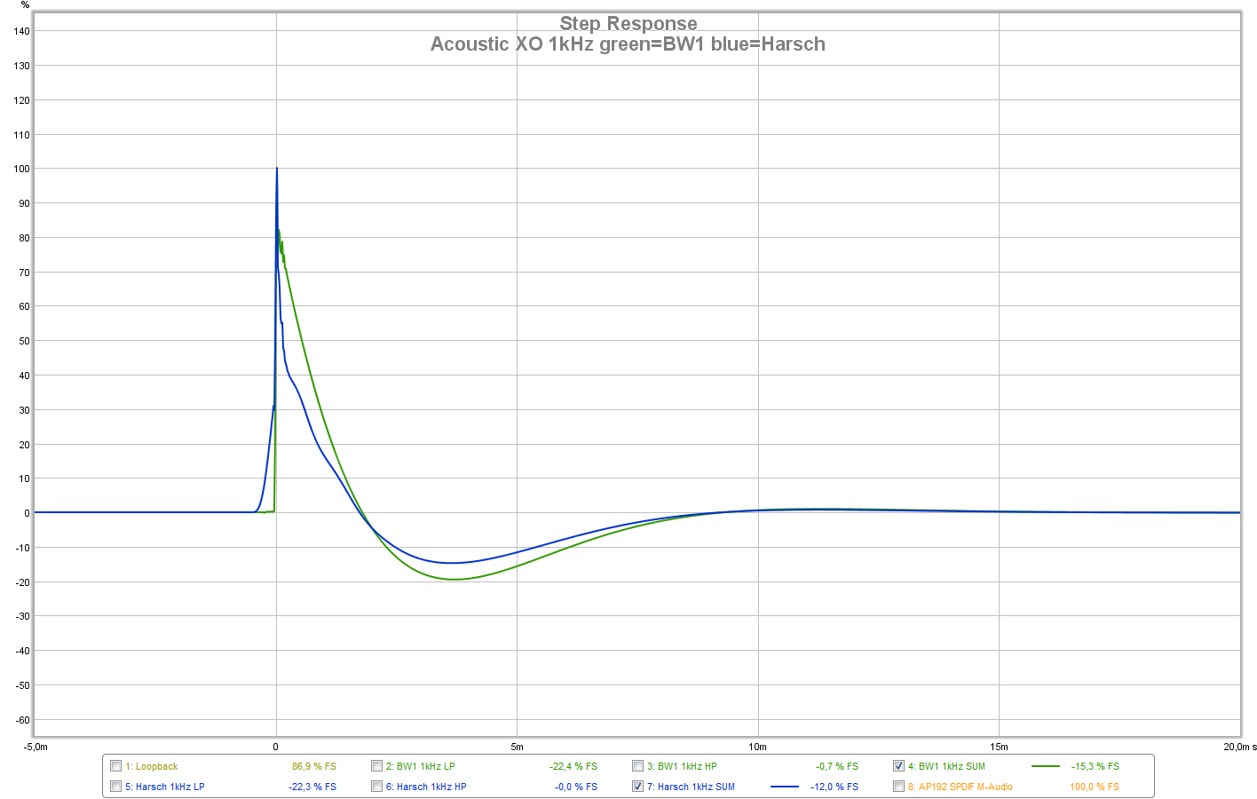

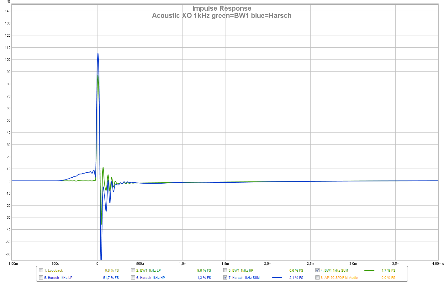

Respect it was a quick and dirty effort in middle of the night and as said it is a nice build including data and sound clips, comment was not to bite at all but based our previous investigations into those BW1 show they so sensitive for small errors in slope and correct spl mix from LF and HP part plus need precision acoustic offset executed. Probably because they cooperate over so wide a bandwidth they need much more care for precion in setup than steeper filters where cooperation bandwidth is narrow.

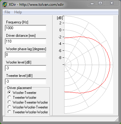

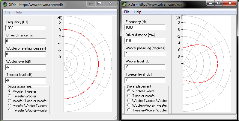

.....I guess your point is that of the slopes are not perfect you get vertical lobing that is frequency dependent and that can ruin spatial image coherence?.....
Hope have this right as i see it : ) vertical lobing is inherent part of uneven filter slope, that's not just regarding errors in your settings for BW1 filter but because of soft slopes most of speakers bandwidth is in a XO region. LP verse HP is never in phase as even order filters is, the always 90º phase apart between LP/HP means unsymmetrical vertical lobe because in acoustic domain we sum with a ctc distance spacing and this means listening hight is relative very sensitive. When summing two BW1 filters in electric domain gives a perfect summing as first picture below, no ringing at all as with higher order but also there not the ctc spacing parameter which makes the difference for BW1 electric verse acoustic. Below picture 2 is BW1 1kHz XO point vertical lobe with ctc distance set to zero (coxial speaker or electric sum) and with 110mm as with this build, picture 3 is even order LR4 1kHz XO point vertical lobe with ctc distance set to zero and with 110mm. So reason showing the lobe plots was to remind we get tilt or sensitive listening hight especially because XO area is so wide when there is ctc spacing verse a electric device where BW1 sum is invincible and perfect in measurements.

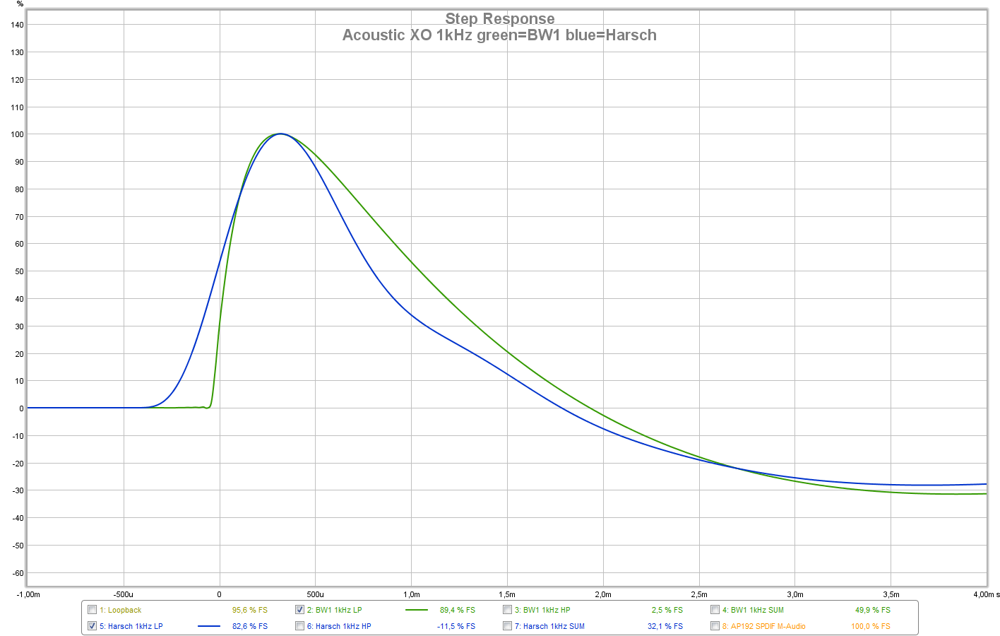

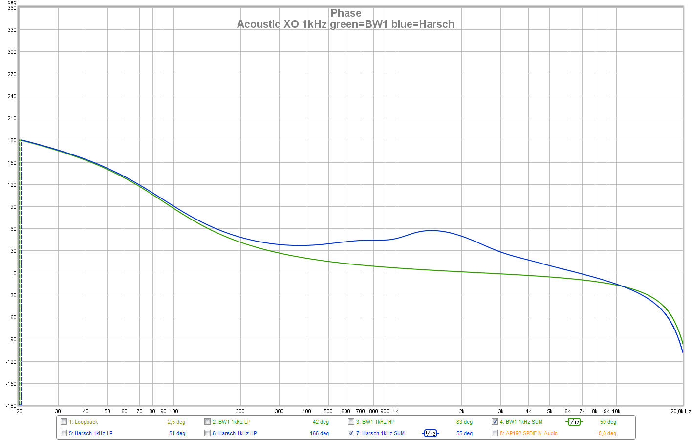

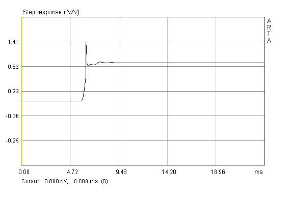

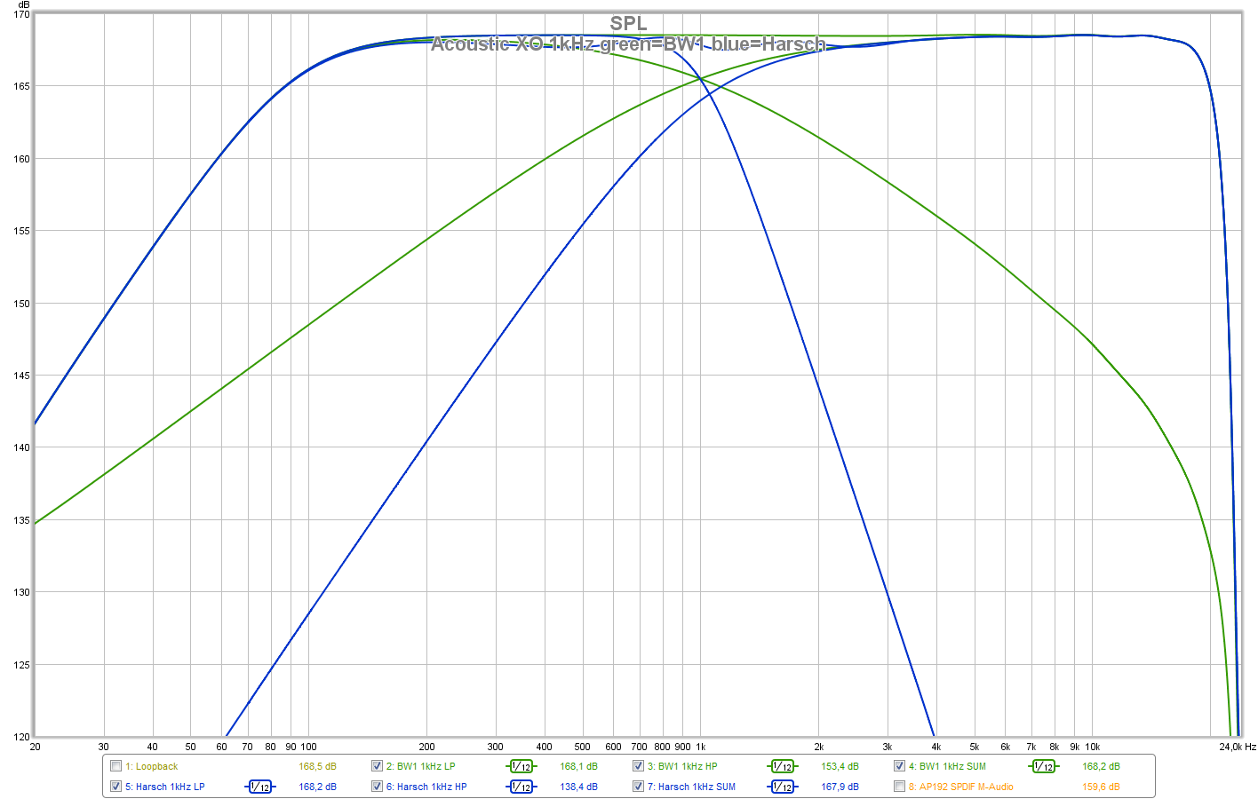

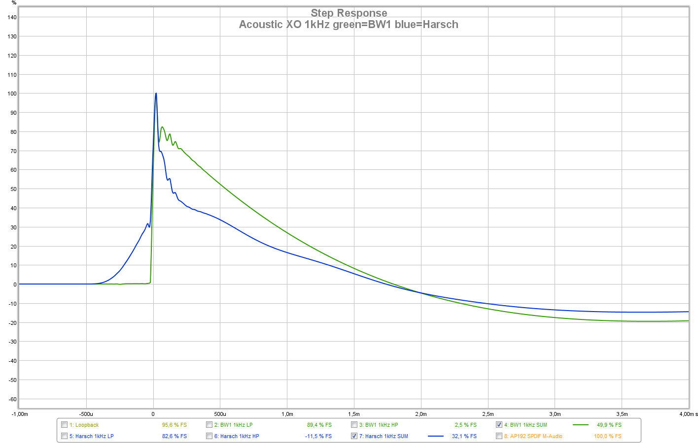

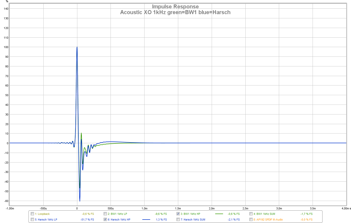

Picture 3-6 is quick and dirty made BW1 verse Harsch in electric DSP loop, system bandwidth is set to 92Hz-20kHz
Byrtt,
Your electrical sims are right one with what I see. I always have that little rise before the sharp leading edge with my Harsch XO. Only with BW1 symmetric am I able to get the steep sudden cliff like rise on the leading edge. I have never gotten a Harsch SR to look like the one shown by Harsch in his paper.
Think its the plots X and Y scaling that makes the difference also the one from the Harsch paper have no real world system bandpass cutoff filters.
Picture 1 is copy the Harsch XO paper at picture 2 i set X Y scale close to that paper and it now looks lot more alike without the revealing rise before the sharp leading edge, and had this build not had high pass f3 at 92Hz the approx. 1,8mSec decay had been longer.
Picture 3-4 is IR/SR woofer section where sharper rise less ringing for BW1 is clear.
Picture 5-6 is IR/SR tweeter section where less ringing for BW1 is clear.
