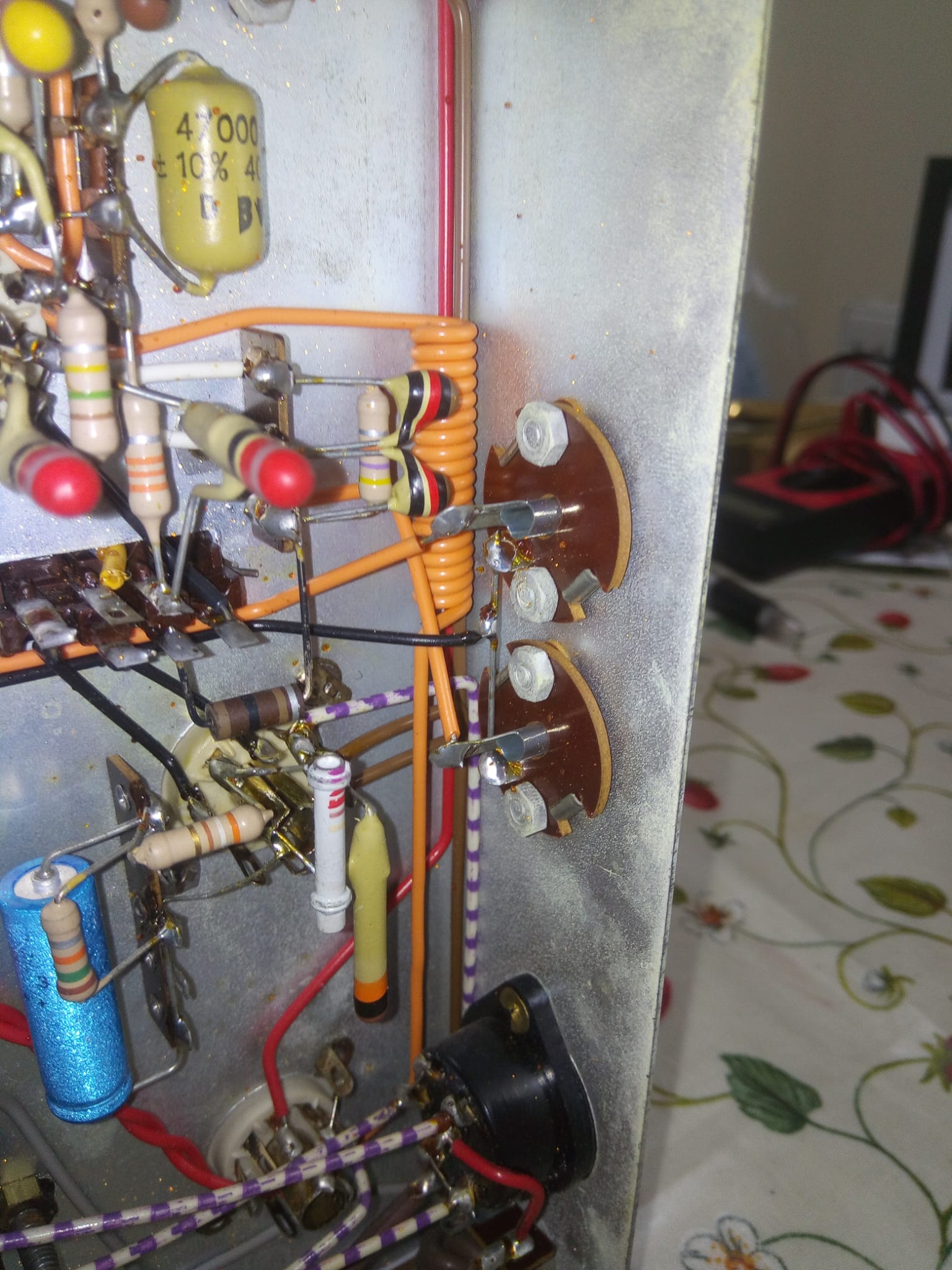

It has separate left and right RCA sockets on the rear, so I assumed it was stereo. Also it has level adjustment for each channel. As I cant get both tuned in clearly, I cant tell if the left and right have different content. The channel output level adjustment is quite strange the right channel level is fixed and you adjust the volume control until the left channel matches the right channel level.Chris are you sure this is a stereo tuner? I believe it was not before the mid-60-ies that stereo tuners became available in Europe.
Jan
Looks like you are right. 1) I can't find anything that looks like a decoder. 2) Look at the image, both RCA sockets are supplied from a common source.Chris are you sure this is a stereo tuner? I believe it was not before the mid-60-ies that stereo tuners became available in Europe.

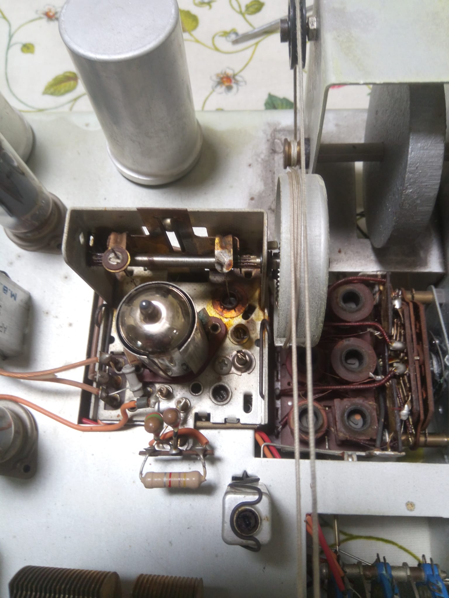

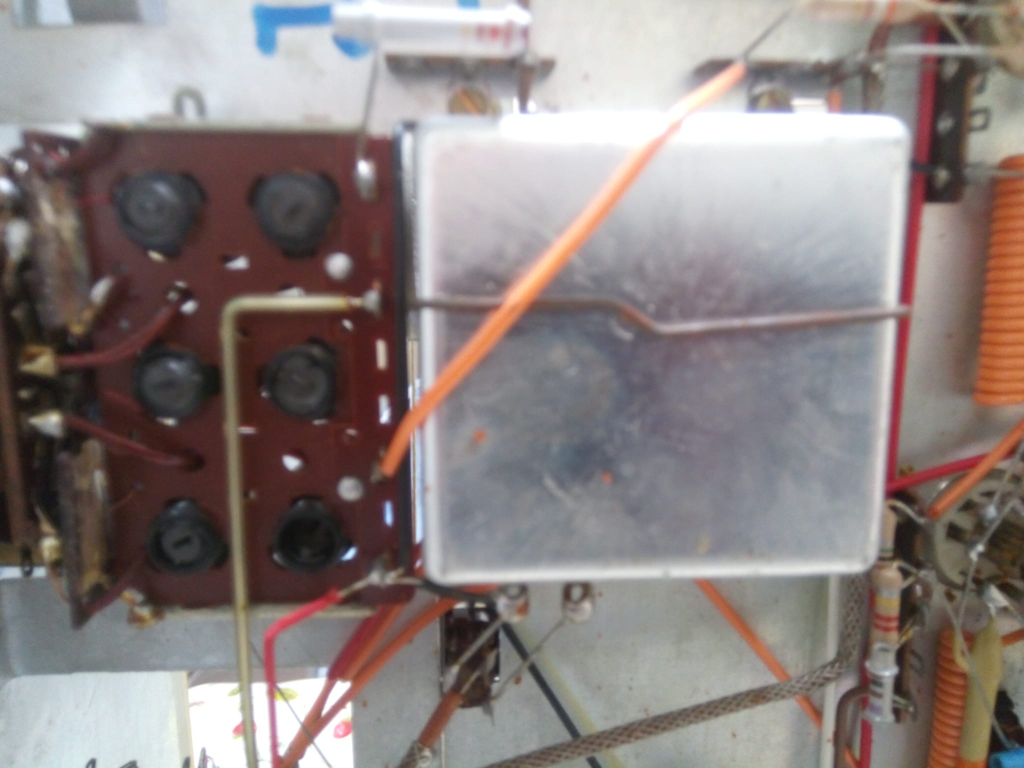

I just opened it up again, that photo of the RCA wiring is taken from a deceptive angle, they have separate feeds. Also the FM tuner has two separate sections, and I think the decoder is in the metal box under the FM tuner. I am not able to verify the decoder as the box is sealed shut.Chris are you sure this is a stereo tuner? I believe it was not before the mid-60-ies that stereo tuners became available in Europe.

I have since discovered that the two RCA sockets are Mono to connect to an amplifier, and Multiplex for connection to a decoder circuit, which I am now in the process of fitting, also a PS recap.Chris are you sure this is a stereo tuner? I believe it was not before the mid-60-ies that stereo tuners became available in Europe.
