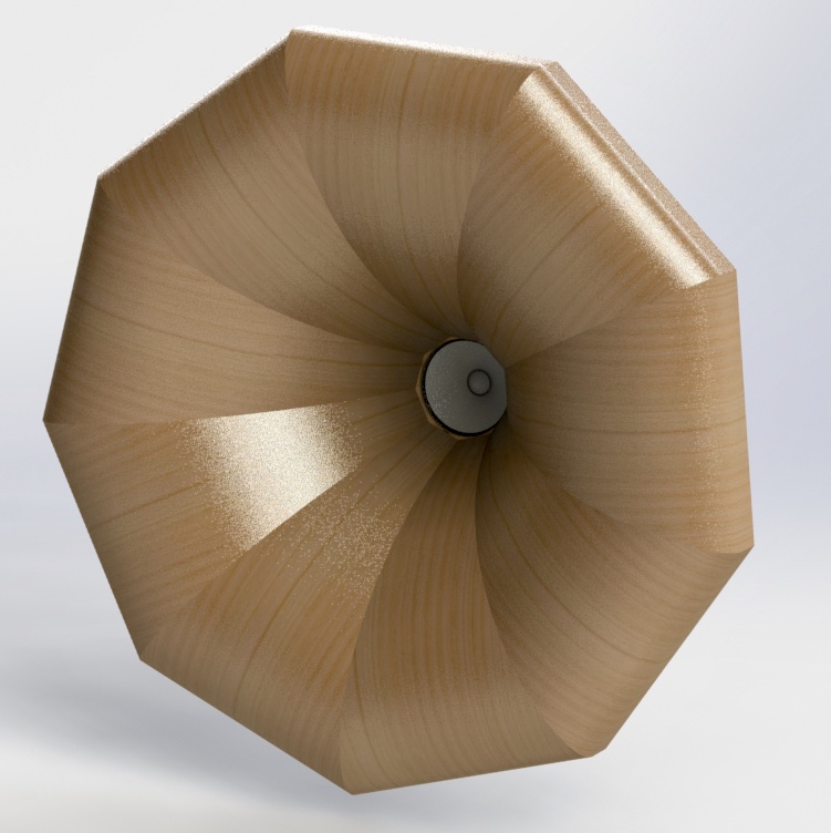

This is a shameless plug but I can certainly help...I offer front horns plans on my website. I include the AutoCAD files as well.
I have a growing number of different designs, and I can customize to your needs since I’m an avid Solidworks user able to do flat shapes from bent wood designs.

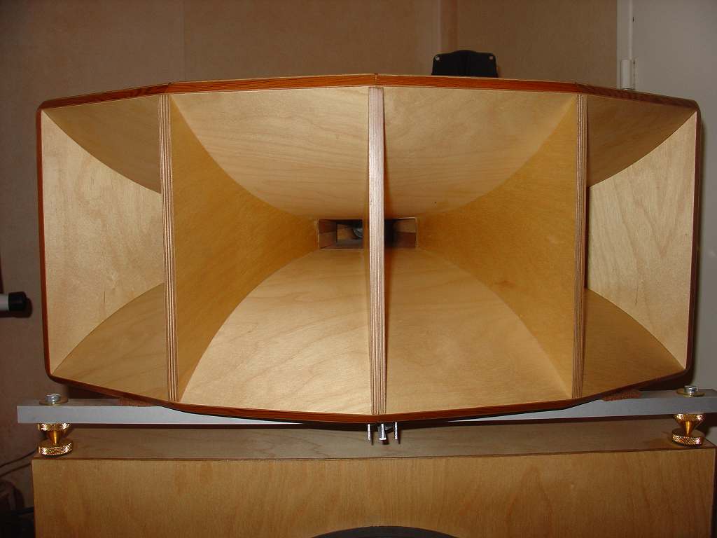

What bandwidth of horn are you looking for? I recently built a small Yuichi biradial that uses the Beyma TPL-150.

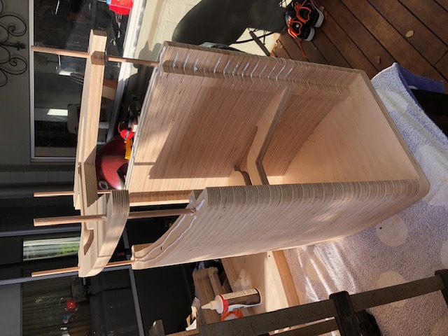

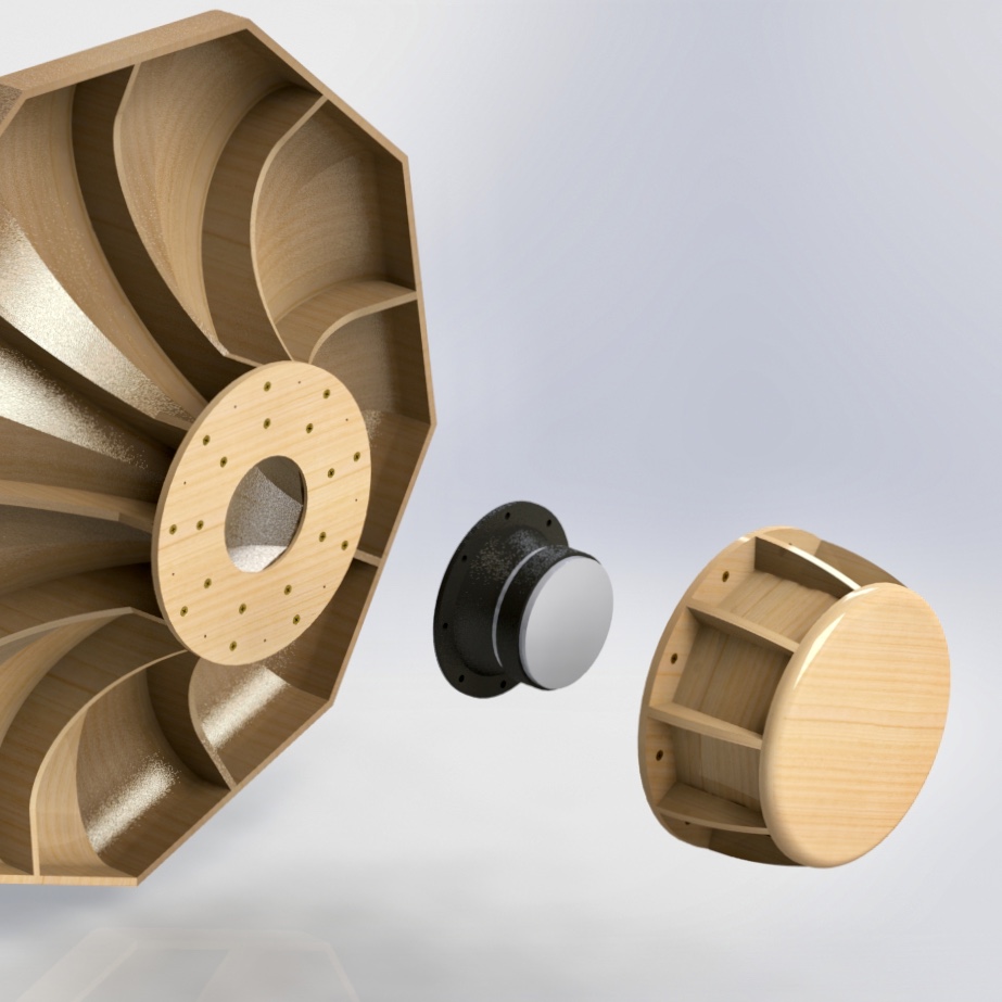

I have plans for a 300Hz JMLC x9 pedal wood horn that can use 4”-5” fullrange drivers. I’m currently waiting for the FE126EN on back order from Solen.
The outside diameter is 24”. It uses bent plywood by soaking in hot water for five minutes. Two layers of 3mm thick Baltic Birch Plywood for the Horn walls.

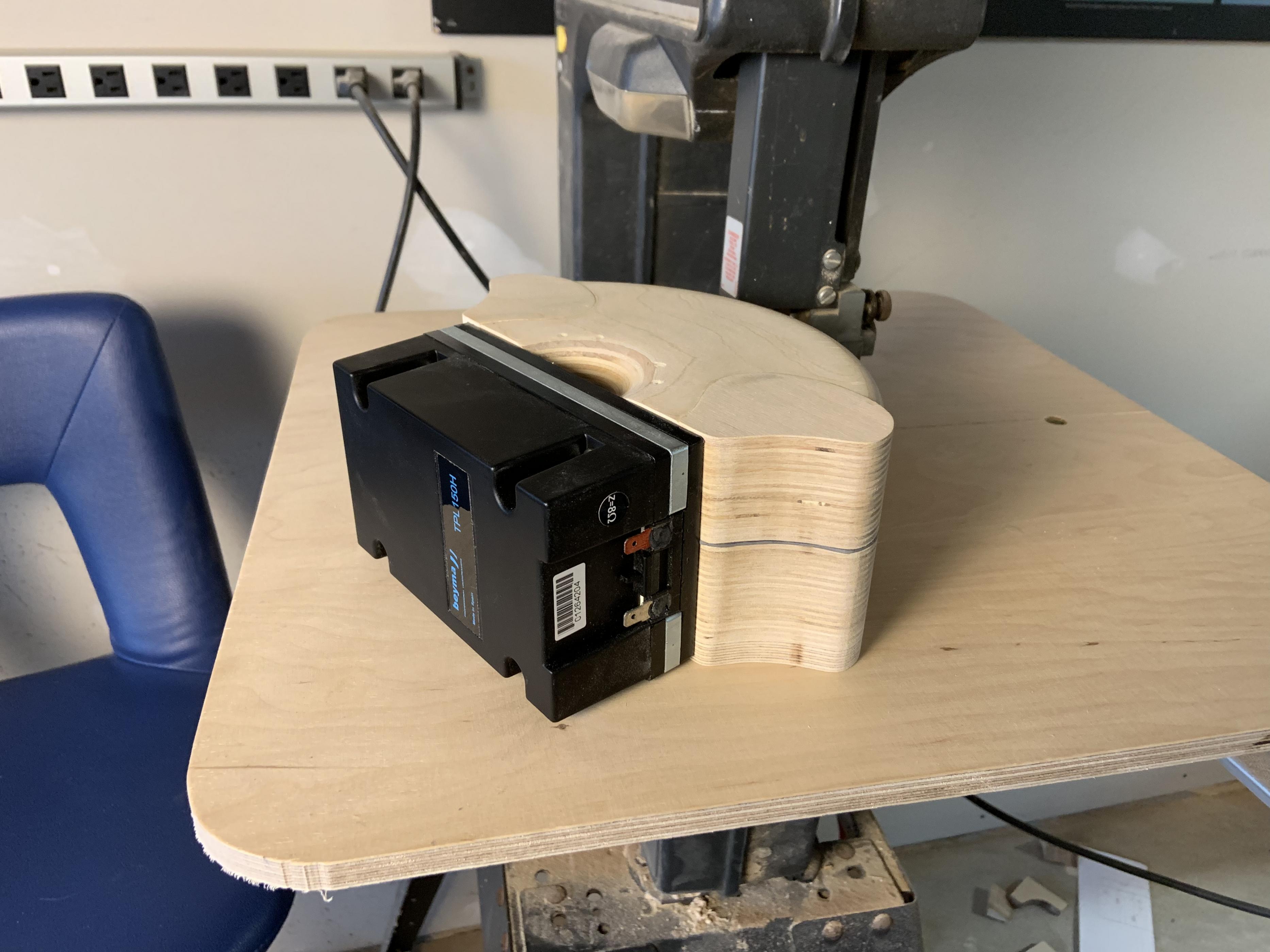

Flat packs will be available July timeframe. The plans are complete but I’m validating the design once the drivers arrive. It would ideally be suited to use a wood phase plug (see photo).

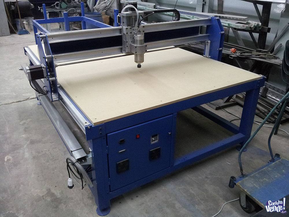

I purchased a RouterParts Pro Benchtop CNC router which arrives mid May. I’m very excited to start using this machine! 🙂

Joseph, from one (CNC/CAD) horn builder to another, very well done. How do you fix the individual petals together once bent/dried? Also, can you accommodate a 2-inch throat? Regards.

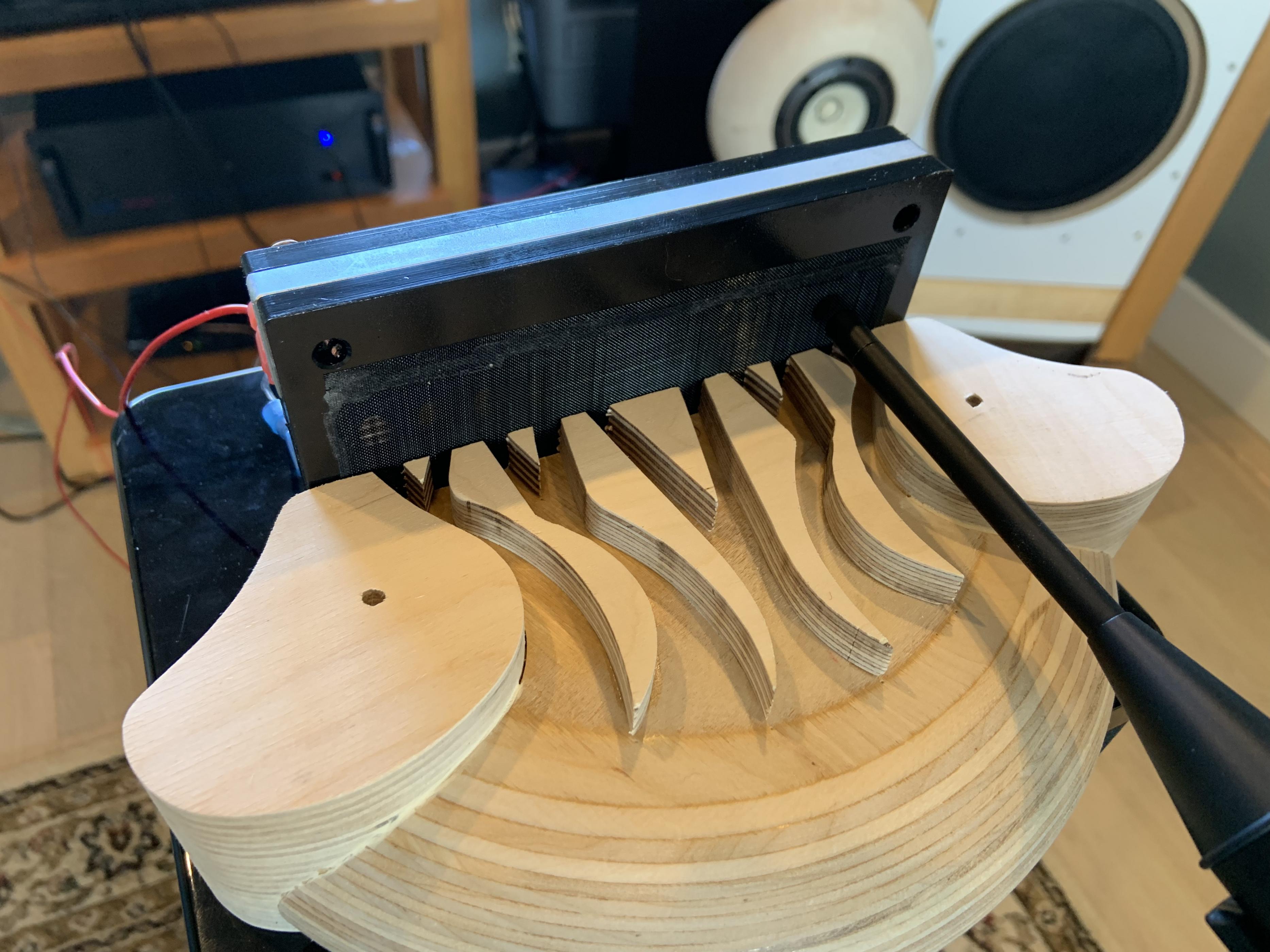

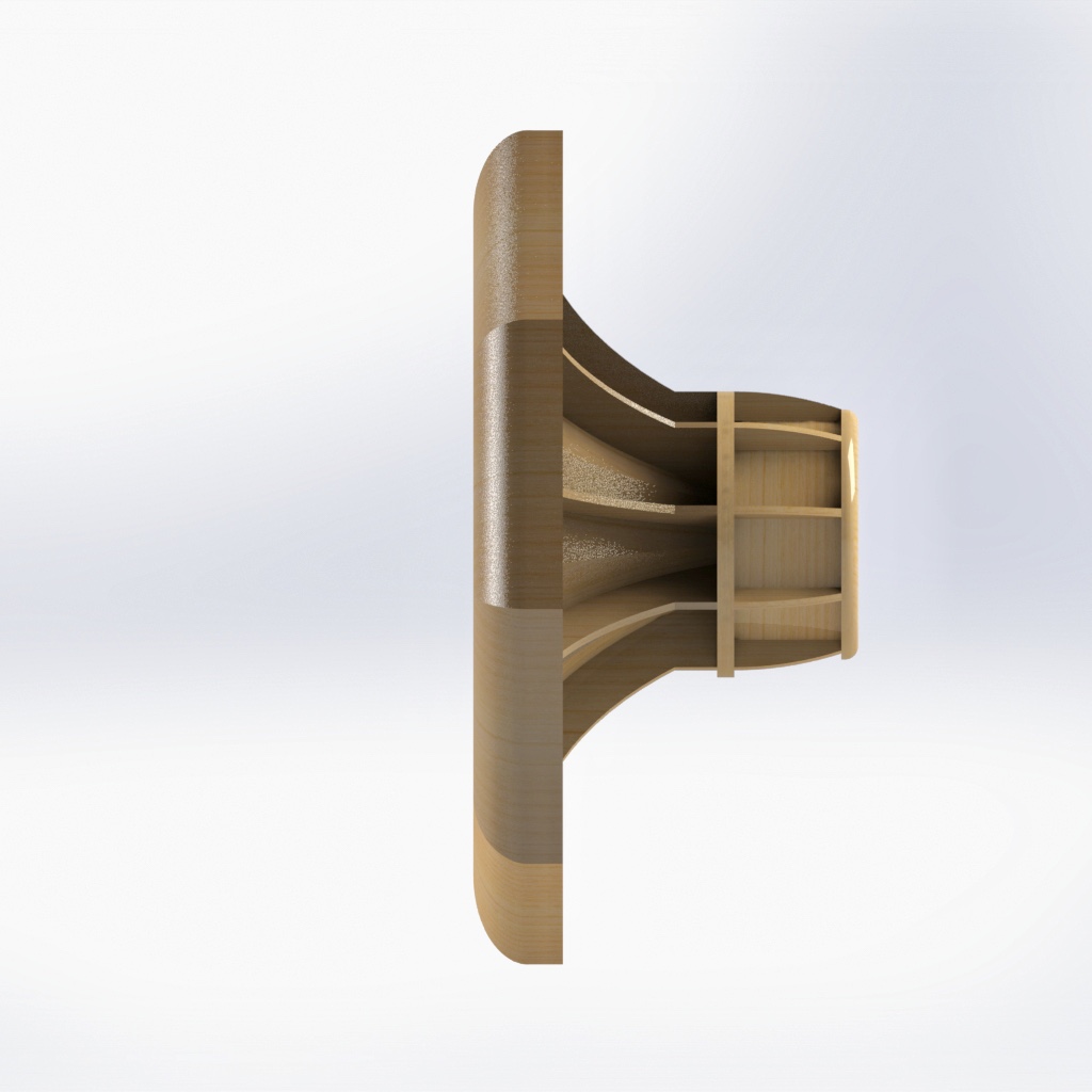

Hi Mr.Trucco, the rear support ribs provide all the strength and rigidity. The pedals are left with a 90 degree cut edge, this forms a vee-groove at the seam on the back side that acts as a glue prep. Run a bead of glue down down this seam to provide the necessary air seal, and further strengthen/stiffen the structure, but it’s not the primary support. The bending of the pedals relies on a holding fixture that requires construction and is detailed out in the plans. This fixture holds one pedal and support rib and allows bending the pedal and holds everything in place while the glue dries between the pedal and support rib.
I’ve tested it and the glue still cures fine even when the wood pedal is soaking wet. It’s kinda fun too.
Great, thanks for reply, Joseph.Hi Mr.Trucco, the rear support ribs provide all the strength and rigidity. The pedals are left with a 90 degree cut edge, this forms a vee-groove at the seam on the back side that acts as a glue prep. Run a bead of glue down down this seam to provide the necessary air seal, and further strengthen/stiffen the structure, but it’s not the primary support. The bending of the pedals relies on a holding fixture that requires construction and is detailed out in the plans. This fixture holds one pedal and support rib and allows bending the pedal and holds everything in place while the glue dries between the pedal and support rib.
And can you kindly confirm if this type of horn can be made with a two inch throat, suitable for compression drivers? Regards. Andrew.
Yes everything about the design is customizable since it’s just me doing all the CAD,CAM, and cutting. There’s no tooling involved so it’s a flexible process.
Actually all the horns I build are one-off projects. The flat packs will be built-to-order as well for this purpose.

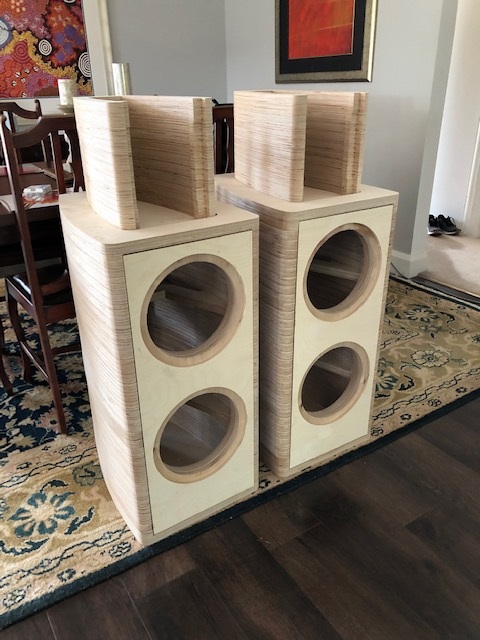

I'm currently building a large 3 way horn system, dual AE TDM10's, Jabo 350Hz horn with Radian beryllium drivers, and Beyma TPL150 tweeter...all CNC'd in euro birch ply.
