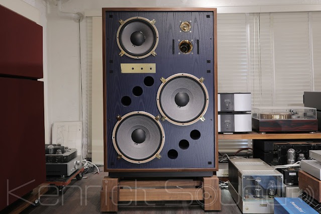

Recently i made a DIY project. i wanted to have speakers like the 4351 from Kenrik's
So i made some with what i had.
I picked up Goldwood GW15PC-4, strictly because the specs on paper was convincing and relatively similar to the JBL 2235h. i know, i know, they are cheap woofers and there isnt much to believe in, but anyway, this is what i had, they where cheap and easy to get.
So
I entered the parameters into WINISD and builded the enclosure accordingly.
Front/back is 1" mdf, sides are multiply 18mm veneer. all braced inside, very strong. glued and screwed. i didnt cheaped on this part.
I followed what win isd told me
about 11ft3 and a tuning FS of 30hz
that made 6x 3" port of about 8.5" long
which is almost the same "close" basic dimensions as a 4350/4351 when compared so in my head i was not far from something that would work

4351 from Kenrik

Hi Pat,
I think the last two posts may give you what you need moving forward. But I wanted to point out what seems to be some confusion in your terminology, which makes it hard to know exactly what you need help with.
The VAS probably never changed. If you did not measure them before, they were probably different from the published specs to begin with. Note, even if VAS is off the other TS parameters may be off too and the box modelling still may come out to be close. (Of course this isn't always the case - I had a Tang Band driver where the difference between published specs and actuals made a signfificant difference in the needed cabinet volume.)
Fs is a TS parameter of the driver (Free-air resonance) and is unrelated to the box.
I think you mean Fb - which is the typical notation for the frequency of the box tuning. Note, the tuning of the box is unrelated to the driver. However, you can tell what the tuning is by looking at the point between the peaks of the impedance curve - which is what you have done above.
Note, you have two issues.
1. The tuning of the box is not what you thought it was, if you want to change it you need to change your port length. This is unrelated to the driver you are using.
2. The TS parameters are not what you thought they were based on the published specs. Therefore, the Fb you were aiming for may not be the Fb that you really want now that you know the actual TS parameters. So before you mess with the port length trying to get Fb to your original target of 30Hz, you should put the actual TS parameters into WinISD and re-model it.
DATS V3 measures TS parameters, WinISD does not. WinISD takes the TS parameters (from DATS or published specs) and allows you to determine your desired box model (transfer function, box tuning, etc.). If you put in accurate inputs (i.e., actual parameters from DATS) then WinISD can generate accurate ouputs. WinISD has always given me very accurate estimates including port lengths for the desired box tuning.

You should believe in the actual DATS V3 TS parameters over published specs. DATS V3 is quite accurate. (Vas can be a bit tricky, but as long as you are doing things right, DATS is good.)What should i believe in, the goldwood specs, the DATS V3 ? WINISD ?

the predictions where matching the data sheet of the speaker, but not the DATS ones, specifically the VAS. as soon as a manipulate the vas it get red flaged, 0 or 9 digits doesnt matter. i had quite a lot of arguments with the guy at Parts express about the goldwood and the potential inacuracy of the (already spoken for on other forums and on their own web site) bad or false TS, at the end i had to tweak the SD and the cms value to "comply" with the original values...i dont really agree with that "lets do freaking guesses and rule of broken thumb" method while we have tools, suposedely factory measurement and judgment.....i hate thoses Goldwood since day one, maybe i am biased.
Just had a look at the data for the Goldwood speaker chassis. The data are from 2003... 20 years old. All to common... I even found data sheets from 1997 in 2022 offers at other places.
This is a known problem with long time produced Chinese products. They are build from the cheapest parts and materials the factory can source in the darkest parts of Asia.
You can be sure that not even a single part of such a chassis today will be the from the same source it came from in 2003. A Chinese manager does not even understand why this could make any difference, as he has no clue what he is building and selling or how physics around it work. "Look good, make cheap" is all Mr. China boss knows, "very good copy from famous speaker", "we sell quick". Trust me, this is the reality.
