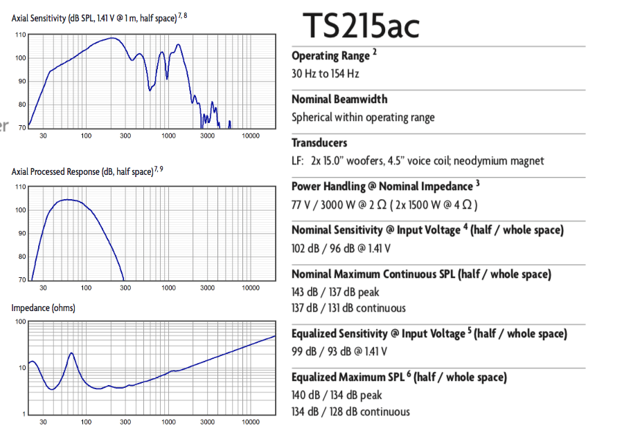

OK, here we go. Once more into the breach. The reason I hate this is that in the process of explaining how our industry does specs, it appears that I am justifying practices that I actually don't agree with.
One of the reasons I don't like peak SPL specs is that "SPL", at least in textbooks, is defined as the RMS sound pressure (referenced to 2x10-5 pascals). So theoretically, there is no such thing as "peak SPL". OK, maybe that's too pedantic: we could interpret it as "peak sound pressure, expressed in units of SPL". Let's go with that.
The point is that "Peak SPL" as it is treated in the professional loudspeaker industry, is peak pressure, not "highest reading of an SPL meter" (SPL meters only measure RMS; even if there is a peak hold function, it is the "highest rms reading observed", and that includes the selected averaging time). Anyway, peak pressure is calculated using the peak voltage of the amplifier. With non-powered systems, the assumption is that a user will supply an amplifier with twice the power rating of the loudspeaker, and that the peak voltage of the amplifier is 3 dB higher than that, because amplifiers are rated with sine waves. Hence, the peak pressure should be 6 dB higher than the maximum continuous SPL.
Keep in mind that maximum continuous SPL is a survival rating, not a useability rating. Of course what would be more useful is "maximum useable SPL", but that would be signal dependent and would have to be subjectively determined. So we're stuck with a calculated value that serves only as a point of comparison: "This one's red line is 2 dB higher than this one's red line."
As for the TS215ac, here is the math (with one more significant figure than the whole numbers on the spec sheet):
Equalized Sensitivity: 99.2 dB
Maximum Peak Voltage of the Amplifiers: 150 V
"Peak Power" into 2 ohms (actually two channels driving 4 ohms each): 11,250 W
Peak Power, expressed in decibels: 40.5 dB
99.2 dB + 40.5 dB = 139.7 dB, which rounds to 140 dB

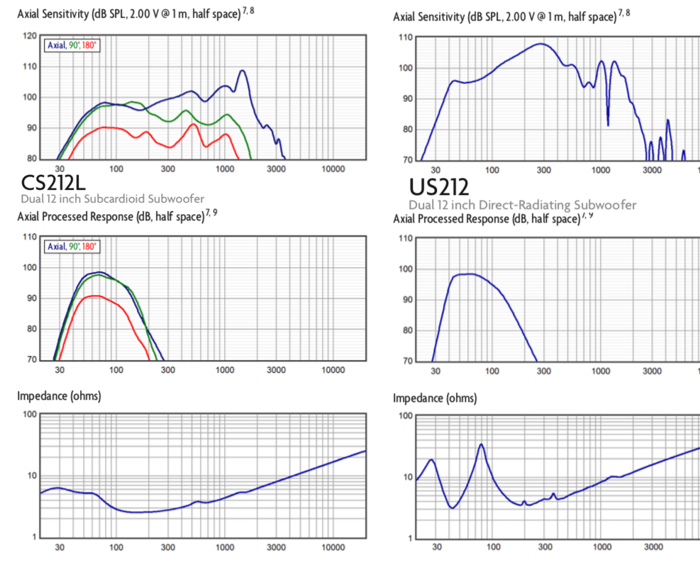

Note the unprocessed TS215 is 95dB at 40Hz, the CS212L is only 88dB, though the impedance is much higher in the low frequency range and the cabinet smaller.
Having heard one of Dave's subcardioid subs, that part of the spec seems completely believable.They also claim 8 dB of rear-rejection across the entire usable bandwidth, with (from what I can see) no lobing on the sides. - which is also sorta' hard to believe.

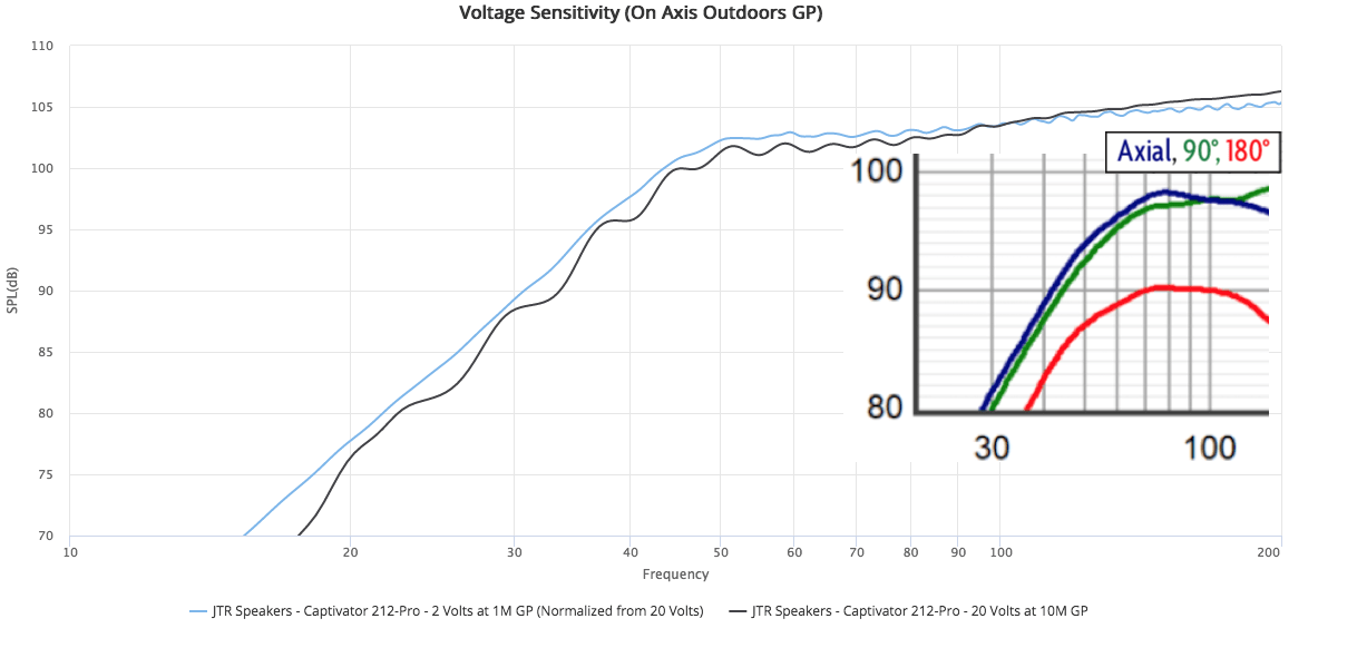

The efficiency is less than a good 2x12" bass reflex. The JTR Captivator 212 is only slightly larger, but it's 1w/1m sensitivity is about 97dB at 40Hz, 102 at 100Hz, compared with only 88dB at 40Hz, 98 at 100Hz for the CS212L. You don't get something for nothing..The efficiency surprises me because some amount of power has to be "sacrificed" in order to create the phase-cancellations.
I know manufacturers love to play with numbers, but then how is Gunness claiming 132 dB continuous in half space with 1400w?
Just at 100 Hz? I must be calculating wrong.
I'm not arguing with you (that would be foolish 🙂 ) - only trying to understand. Besides, I EXPECTED the cardioid sub to be less efficient. I was just surprised when it seemed otherwise.

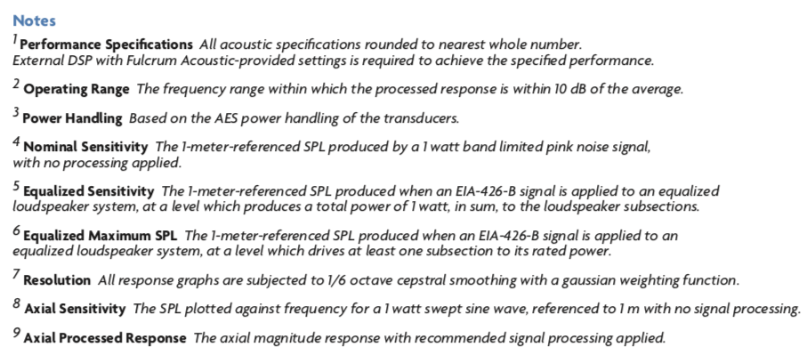

132 dB Nominal continuous, based on a nominal sensitivity of 101 dB, which is only reached above 400Hz.I know manufacturers love to play with numbers, but then how is Gunness claiming 132 dB continuous in half space with 1400w?
Just at 100 Hz?

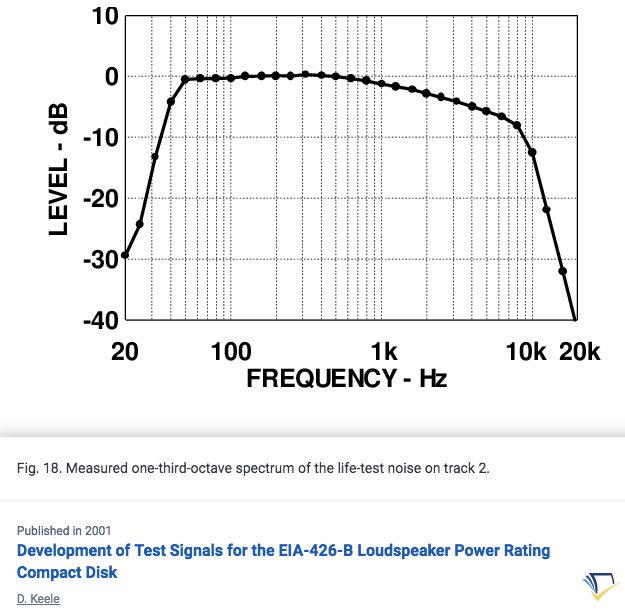

Note 4 "Nominal Sensitivity" does not specify the band limit of the pink noise signal.
The band limited EIA-426-B signal looks like this:
The FA CS212L is about 5.4 cubic feet gross (exterior dimension), the FA US212 is 4.1 cubic feet gross, and specs a nominal sensitivity of 102dB.
The charts show what you need to know about sensitivity vs frequency and impedance, the US212 is about +6dB more sensitive at 40Hz.
