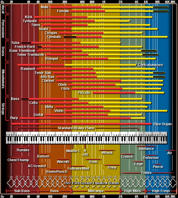

Full Range for me is now 10,000 Hz & below
My Hearing test revealed that I am unable to hear beyond 10,000 HZ. Actually I could not hear 9,000 HZ either and since Music is said to only go out to about 5,000 HZ and not much of any music will be at 7,000 HZ & above ...................
Then it occurs to me that it is pointless to be limiting my choice of Full Range drivers to those units that only go above 10,000 HZ. This opens up many,many more drivers to choose from to create speaker systems with. and I would guess that I would probably realize as much enjoyment from my speakers at a 9,000 HZ or 10,000 HZ top end as I would if they went out to 15000 HZ & above.
So if anyone is using 5 " or 6.5 " units I would be interested in knowing the drivers you are using.

how does live music sound to you? - does it seem "dull" ? - you may still benefit from downward sidebands from high harmonics and good power response in the treble - with old opera I could enjoy say a BOSS $10 6.5" on a cardboard baffle just fine

The system is already full of low-pass filters, so don't limit the BW at the very end. Modern tweeters can have a good off-axys response ( and that's useful for stereo, uh, Freddi ?? ) well beyond 20000 ...

Even though you may not hear much above 9-10K, I believe there is still something to be said for having higher frequencies present. Typically, it's not that you don't hear the sound, it's that it just needs to be louder to hear it.
I don't know how high would make a difference to you with the FR of a speaker, but I wouldn't discount frequencies above the 10K range.

Do keep in mind that there are 2 hearing systems. The measures taken were FR, The less talked about time response system does not degrade near as fast so limiting the HF response to 10k may find you wanting.
But the only way to know is to try, you may find drivers with limited top just fine. Most of the music is in the midrange.
2 known to have less top that are worth looking at are the Mark Audio CHP-70.2 and the CHN-70 (a wonky FR specifically for the Japanese market it is targeted for). At a higher price others like the TB W5-1611, and the Fostex FE108/168eS might suit as well.

I am 52 yrs old and from what I have seen with my Dad and others who have them, I will pass on hearing aids for now . Actually I am still able to hear & enjoy Music , I just can't hear "The Air around Instruments" so I guess I am no longer an Audiophile ......lol
Perhaps when the day comes to get hearing aids I will send the Bill to the rock band ...AC/DC
Steve -
