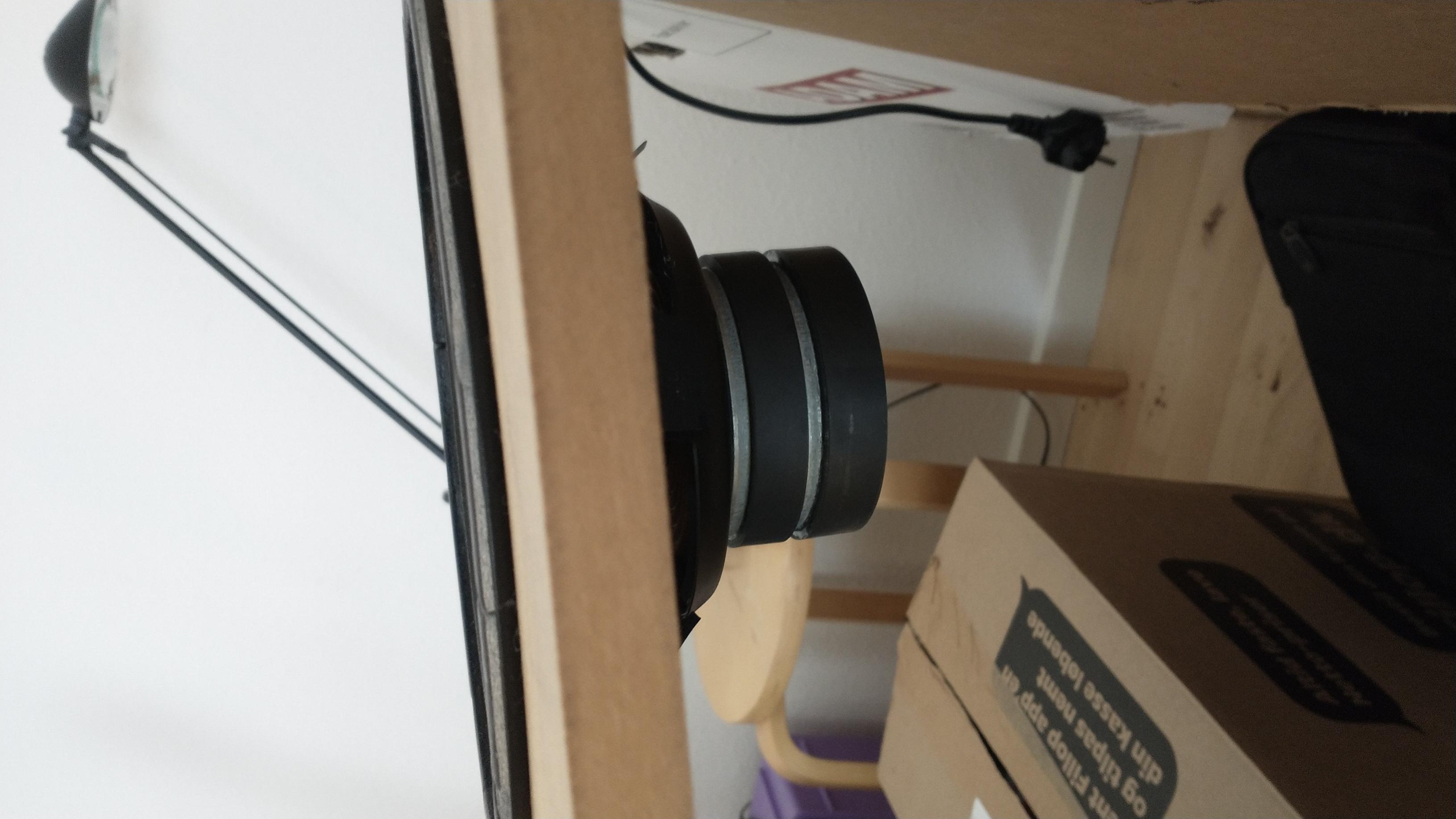

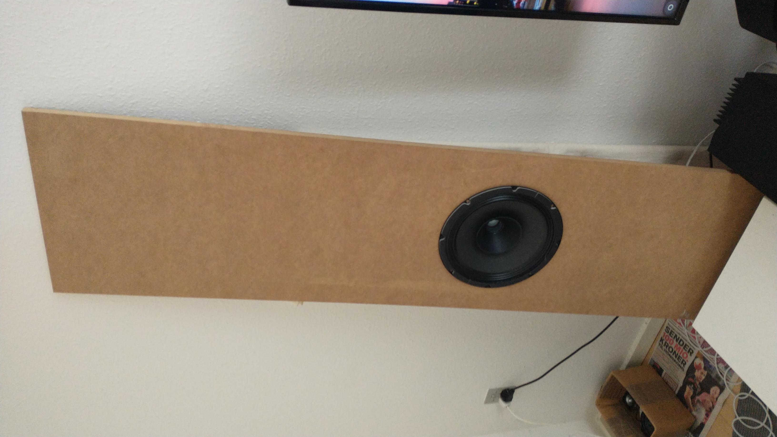

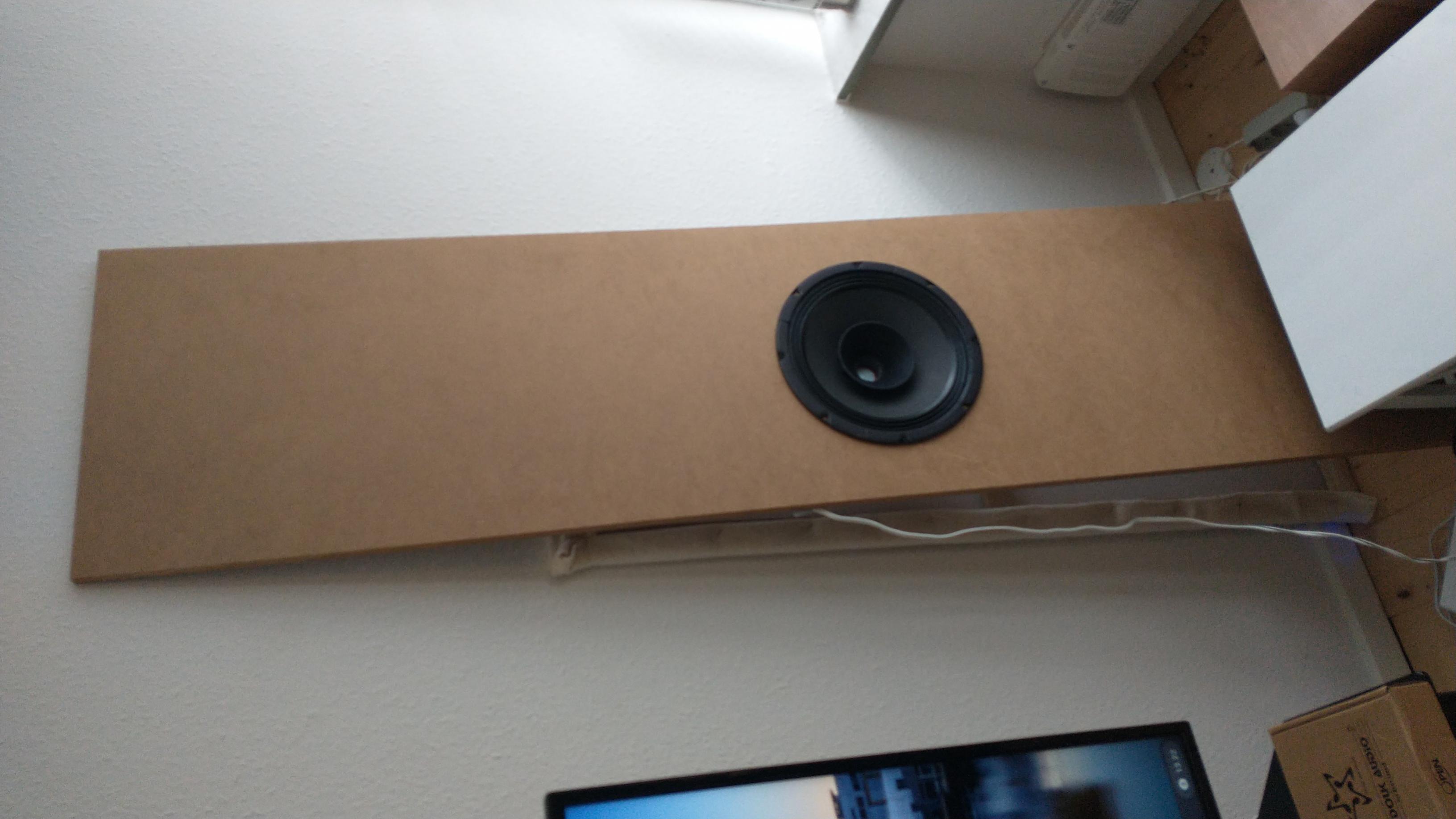

Trying to be creative and build my own design, well...wel...
Yesterday I had the prototype up against the wall, I was going to make sure that the speakers was allright efter been lying in a store room for some years, so I plug them in to a 100W chinese amp. Well, well, what can I say, is sounds like they have "a cold" no bass at all. At low volumes its worse, but when I crank up the volume something is happening - soundstage is good, piano, voices, etc...like a typical full range, but no bass :-( there is allso some distortion, but maybee my connections and the amp is not the right kind for this speaker. Im thinking I dont want to live without the bass from a speaker, so - what to do about it? yeah the baffle is too narrow, 40cm, but I have a small living room. Maybee someting in the middel to make the wide about 60 cm? I had allso been looking at the decware nfx enclosure DECWARE / High Efficiency speaker model NFX, hmm... too difficult for me, but maybee something like that.

The baffle isn't wide enough to get any bass. The front wave is cancelling out the back wave.
Open baffles are meant to be used away from the wall.
The Dacapo project you posted shows -8db at 90hz even with some kind of filter and it still has no bass.
Here is a very simple open baffle that should improve bass.

Check Breezer cabinet with Seas FA22RCZ drivers.
Its bih enough for your Ciares and you will get some deacent bass. If thats to complicated you can design your own simplified version with square footprint.
