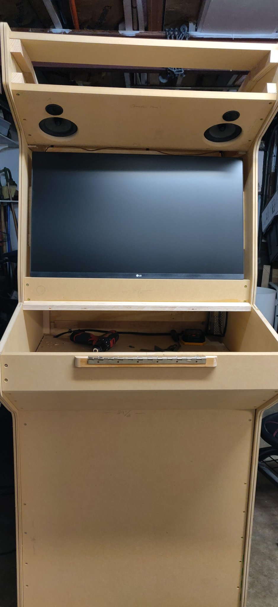

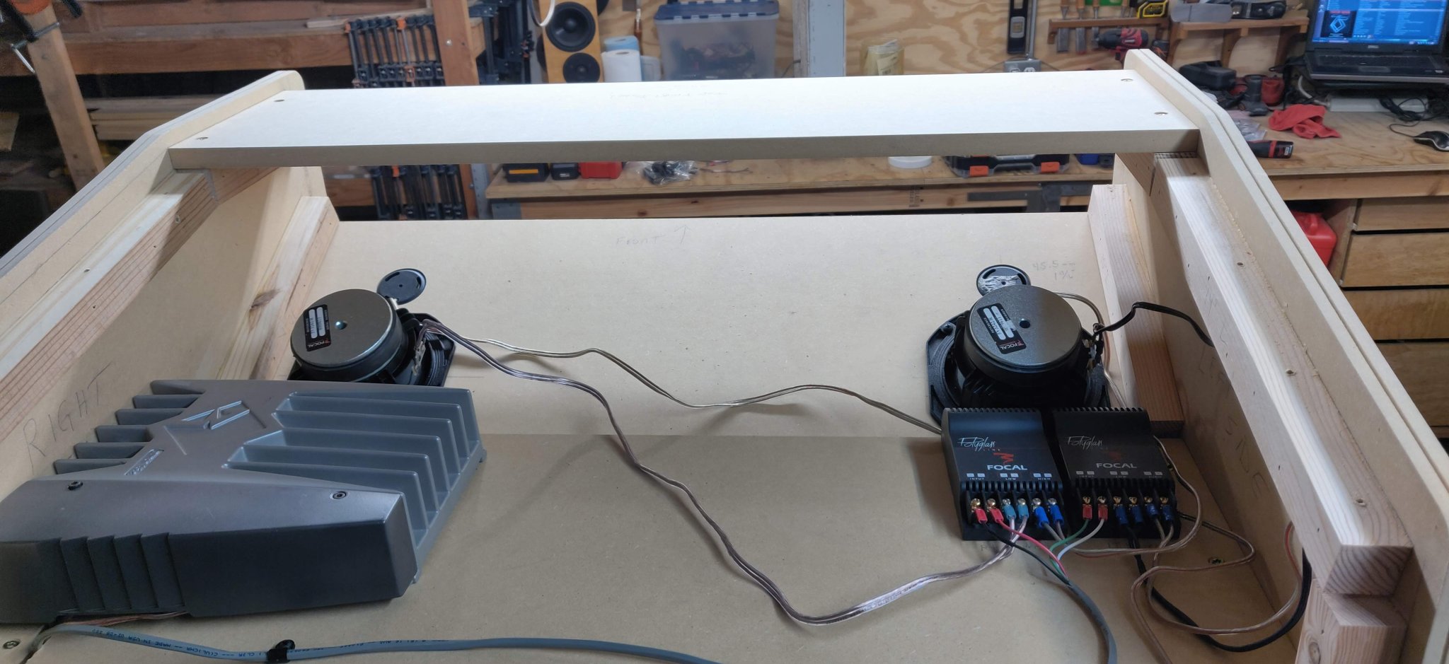

Full size MAME Arcade cabinet build, that will also double as playing blu-ray movies. Started with intent to repurpose very old auto components/amp, but I need to pivot to using full range, and a much more efficient amplifier/speakers. I do not want to have a powered sub, so will probably need at least a 4-5 inch speaker. Will also likely be powered by a not yet acquired simple 2-channel amp board, like the Dayton KAB-250v4 2 X 50W

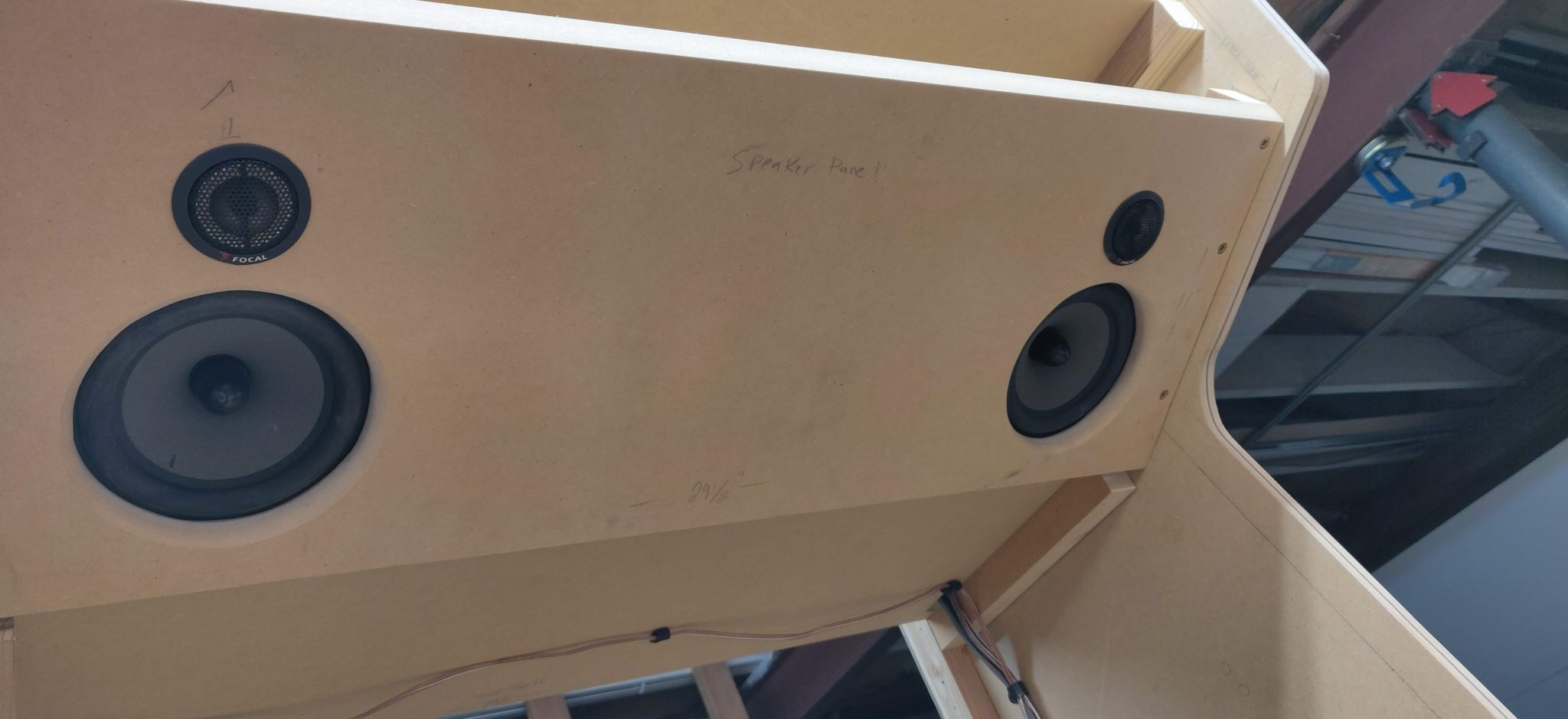

Any suggestions on a good full range that would have a decent amount of bass? I have been out of the building game for some years now, and never really tried full range designs before. I will be putting a new baffle panel, so will not need to use existing. I also would not be averse to constructing a sealed enclosure behine the baffle for each driver, if that turns out to be necessary to get proper bass response.
I know the HiVi B4N's could be an option, but haven't any experience with using them full range, without a tweeter.
