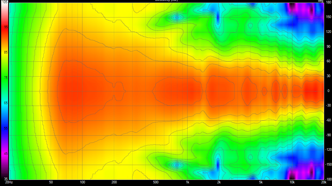

My wish is to fully simulate speaker with VituixCAD before buying any of the components and building physical cabinets.
Project in details:
-Bookshelf form
-Passive crossover
-2-way with only 5,5 C 1,5 CP coax driver
-Bass reflex 5-10L of internal volume. Manufacturer gives 8L or 9L as recommended in its documentation, quick sim with WinISD also gives "ok" results in 5+ liters range
-Narrow baffle with massive edge radius, 50mm or similar. Only to fit the driver and then some more for rounding/beveling
I already invested some generous two-digit hours of time in understanding some of the Vituix tools, but... Unfortunately it is a tremendously complex software comparable to the collection of the scientific calculators but still with no clear workflow how to actually simulate the speaker in digital form before starting the physical process.
What I did:
1. Took the freely available measurement files in picture format from dibirama.it. I assume they are made on large baffle, 2pi space, 1000mm at 0 degrees H and V.
2. Made FRD and ZMA files with "SPL Trace" tool in Vituix.
3. Simulated Baffle Step Loss with "Diffraction" tool, opened FRD file from my trace, then exported FRD files with 10 degree steps. All the steps above for both drivers - tweeter and woofer.
4. In "Drivers" tab created 2 drivers and opened bunch of FRD files and ZMA file. Everything seems to look ok.
5. Started to play with crossover, manufacturer suggested as a starting point.

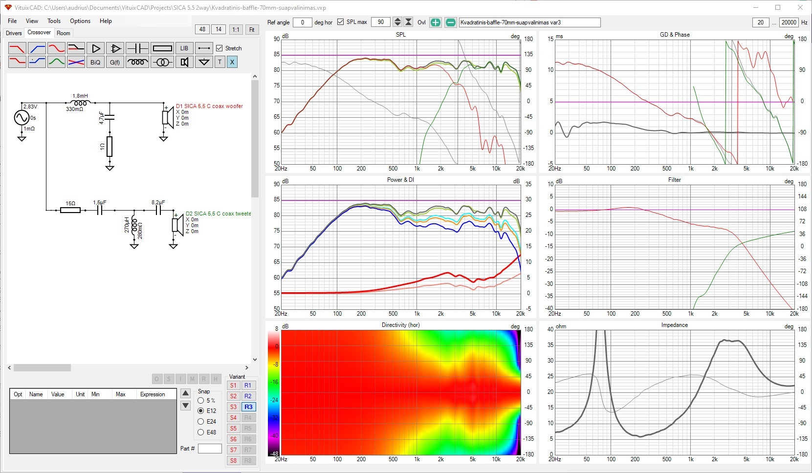

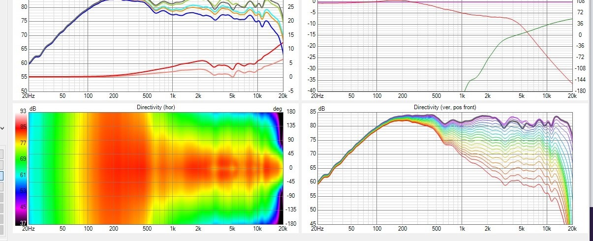

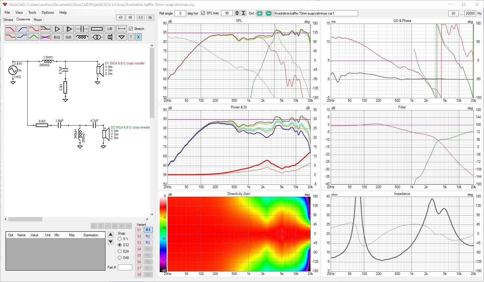

This is what I got with dibirama.it SPL and impedance data AND manufacturer suggested crossover:
dibirama.it data with tuned values of manufacturer crossover:
The same with manufacturer data AND manufacturer crossover values:
I do not worry much about the 100Hz range simulation, as the vented box behavior is pretty much clear to me. Also, I have made all the simulations in the virtual 1m distance, because I think the manufacturer and dibirama.it measured at the same distance.

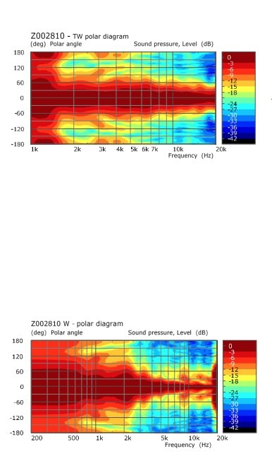

Below are manufacturer polar diagram of separate tweeter and woofer:
It seems dibirama.it + manufacturer crossover is even better than the manufacturer data alone.
I do believe, that manufacturers make their data by cherry-picking their drivers for measurement or/and simply by painting them to look more beautiful, but my questions are:
-Does the driver look listenable from my simulations?
-If not - what could be reasonable crossover for this driver?
and most importantly:
-Are my simulation steps right?

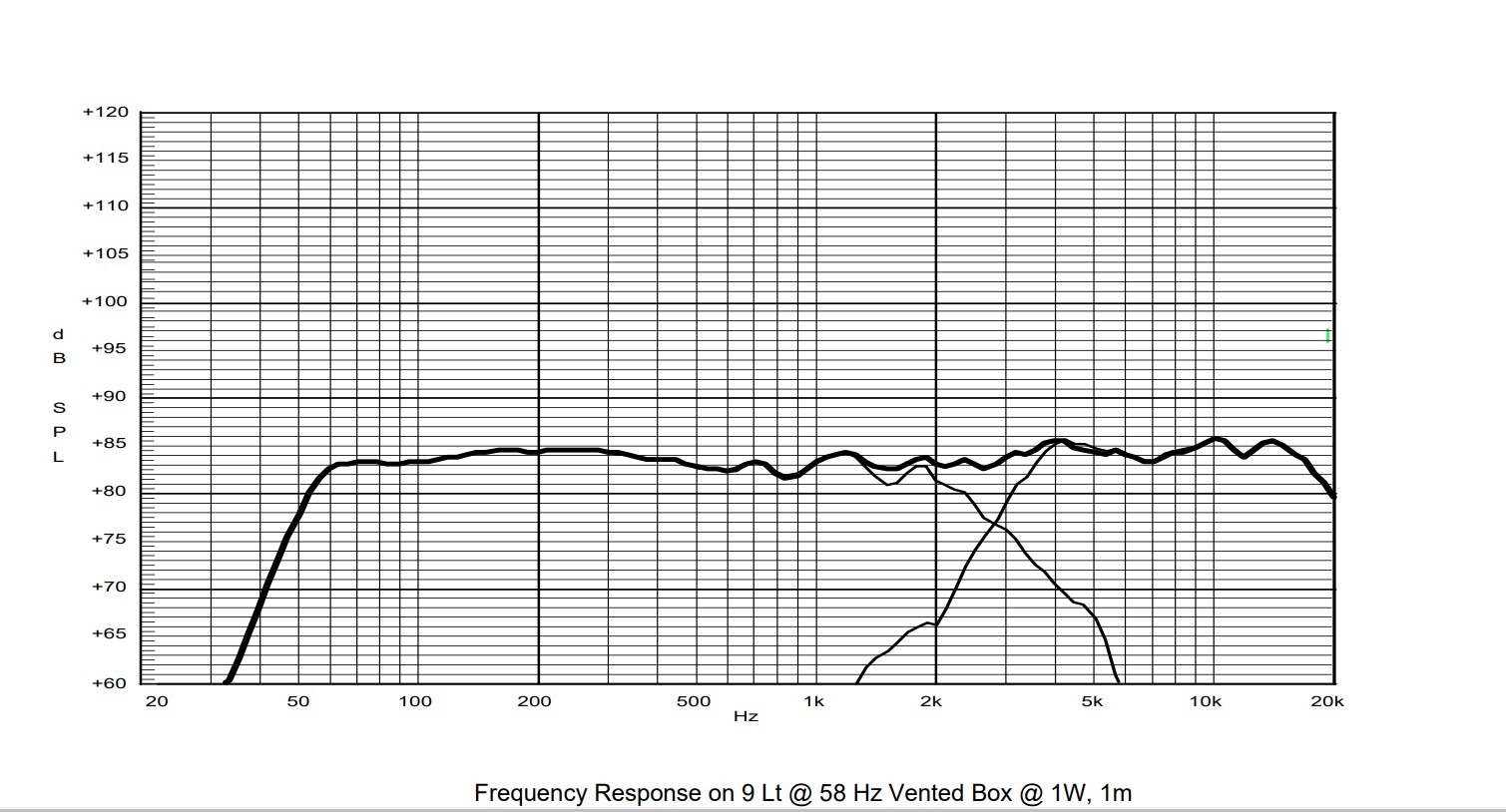

Here is manufacturer data of the completed speaker with their suggested crossover. All the ripples are in 2-3dB range, but my simulation shows closer to 5-6dB, a pretty big difference:
It is a pretty expensive experiment to do in physical form, as drivers and crossover components will be at least 250-300EUR, I want to make sure it will not disappoint me. There are not many projects with this driver, and also I am scared of crossovers with ridiculous amounts of components (15+...).
Thank you for your thoughts

For diffraction simulation, main problem is that this simulation assumes flat piston, so it becomes quite inaccurate for upper frequency range, let's say >1500Hz, and especially so for any tweeter other than flat faceplate like standard dome. A coax tweeter is effectively horn-loaded by the woofer cone, so don't be surprised when your overall power & DI of the real speaker is quite different from your simulation.
For final speaker design presentation, normalization of polar map should not be used.

Manufacturer data + dibirama just isn't enough data for a good simulation. You might wanna try @vineethkumar01 's full set of measurements for their teardrop shaped speaker with the 5.5C1.5CP. https://www.diyaudio.com/community/threads/a-3-way-design-study.376620/page-31#post-7113704

Your choice. VituixCAD diffraction tool won't cut it.Dcibel, I have read your post few times... More questions than answers:
Did not think about that at all. We need another tool for waveguide simulation at other than 0 degrees. Is that right?
Should I learn AKABAK?
Normalized chart simply applies on-axis EQ to pound the response completely flat, so all directivity is shown relative to 0deg axis. Good use for things like evaluating waveguides and horn shapes, or cabinet shape, but a complete speaker is not flat on 0 deg 20Hz-20kHz, so its true directivity result is without normalization. I usually turn on contours at 3dB steps to make the directivity shape clear.What should I use? The same polar map, but without normalizing fuction? Why? What will I see more from non-normalized chart?
