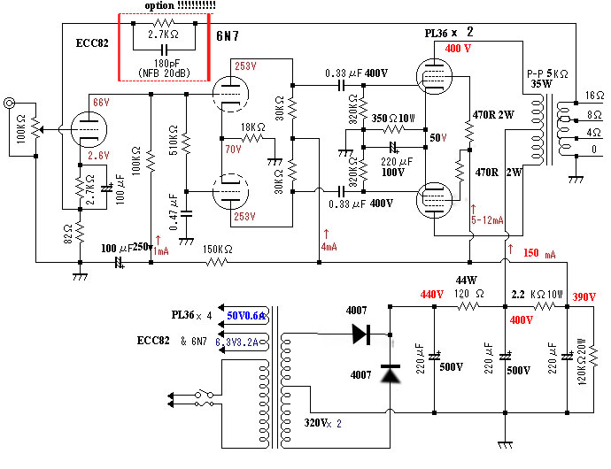

But see amps with diodes and still use center-tapped full-wave. I don't get that.
This one, for example, showed up in the forum feed just today for me:
http://www.diyaudio.com/forums/atta...w-full-construction-details-pl36-ppsch-02.jpg
(Thread: http://www.diyaudio.com/forums/tube...-amplifier-22w-full-construction-details.html)
Thanks for the response. I'll have to look into hybrid bridge rectifiers....
The power trafo could have been on hand.
The B- supply in the uploaded "El Cheapo" schematic employs a hybrid bridge.
