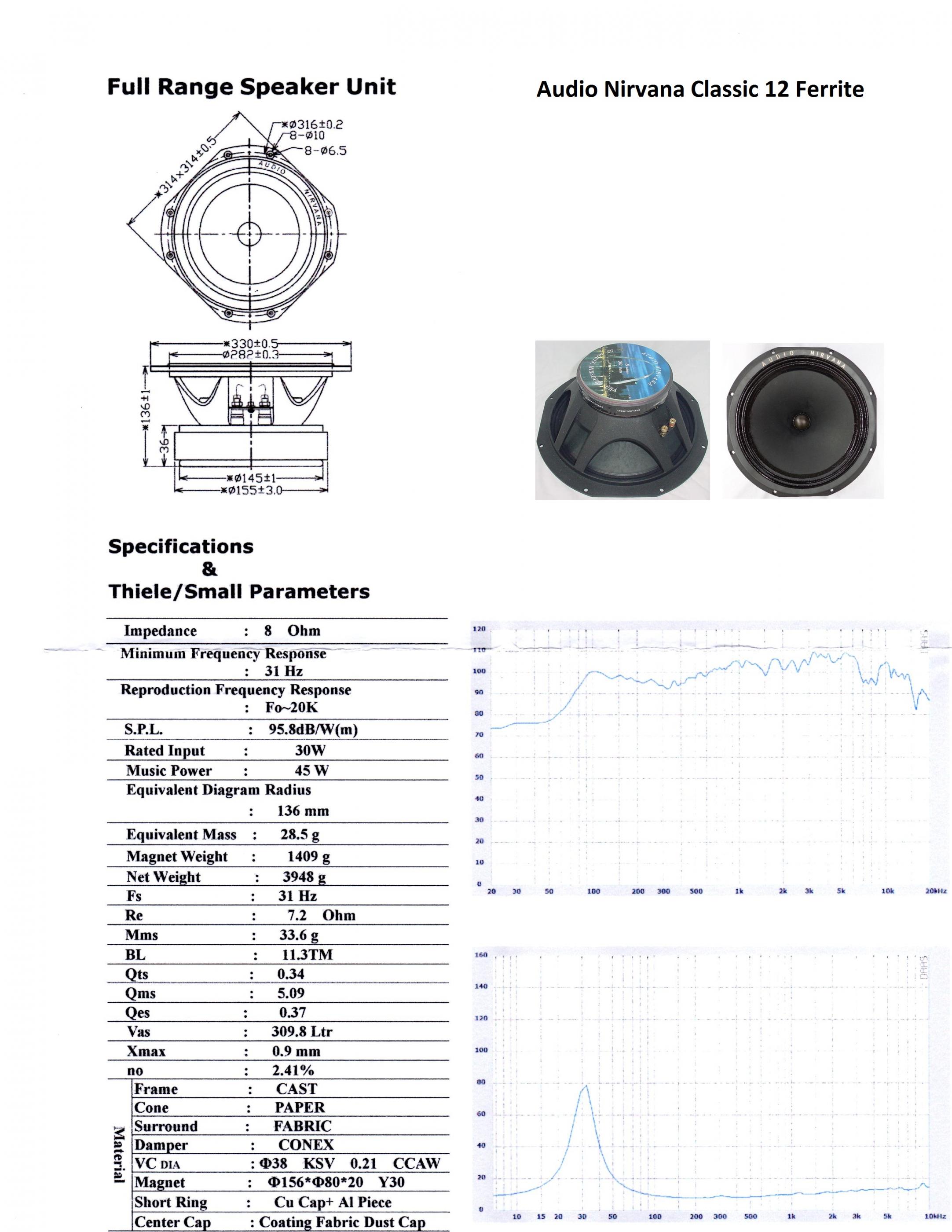

Real-world sensitivity looks more like 97-98 dB, but quite flat compared to most of that category.
Won't do low bass, a quick look at the specs suggest it wants to be an OB with a helper woofer.

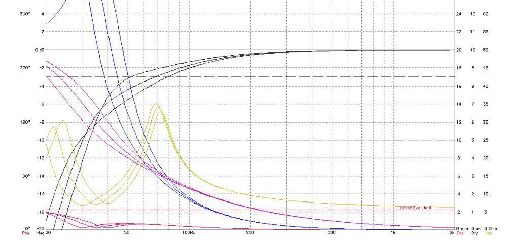

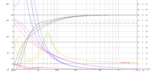

AN12 Classic. 150 litres 35 Hz gives F10, 40 Hz, with a fairly well damped responsenot particualrily low for a 12 but decent.
Could be squeezed into a small as 90 litres.
Note that real world measures of the Classic 10 sensitivity was some 2dB less than spec, i would expect similar for the 12.
