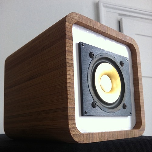

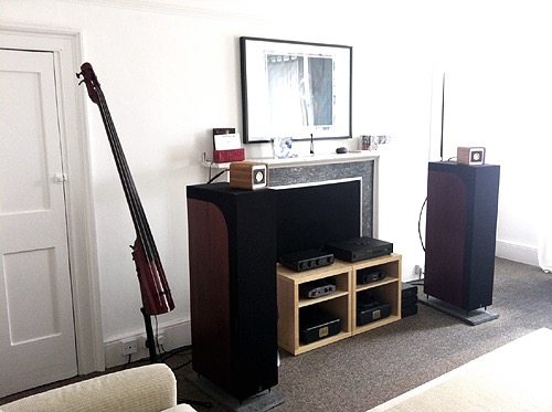

I recently knocked-up something similar for fun using some Bandor 50mm drivers I have. These only require 1.5litres of sealed box, and I found a suitable pair of laminated bamboo utensil pots in a closing-down sale (Habitat!). These got stuffed with dense mineral wool batt offcuts and a front bafle added; enclosed volume about 1.7litres.
Tiny box trial fit:
Dwarfed in situ
These sound better than they have any right to for the minimal amount of effort invested. The spectrum rolls-off top and bottom in a very well-balanced way giving tremendous presence and clarity (and bass down to around 100Hz but with the impresion is they go lower - bass pitch definition is very good indeed). They are almost criminally insensitive, somewhere around 78db/W I reckon, and a lot of fun to listen to.
