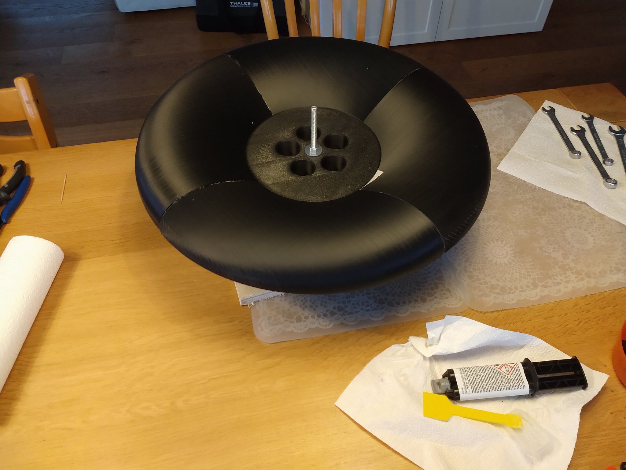

I made a first prototype following his guidelines after struggling with Fusion 360:

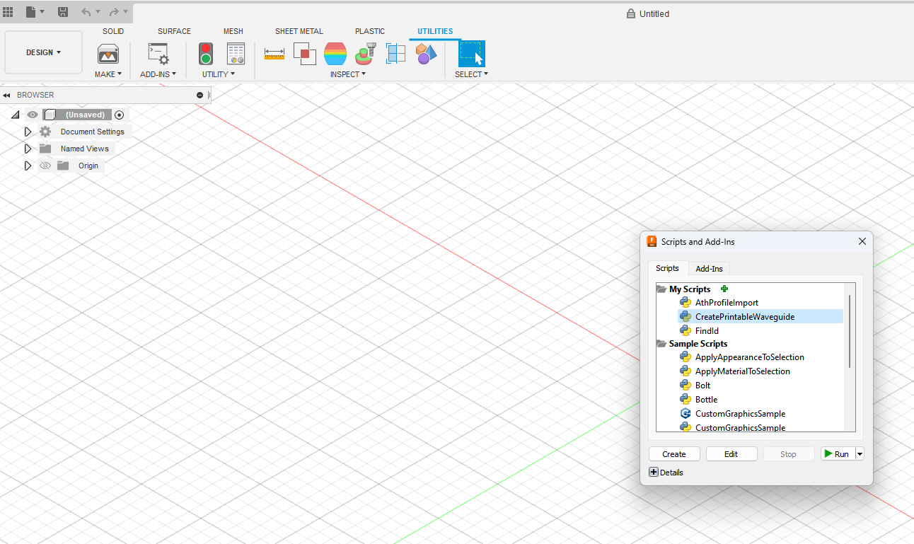

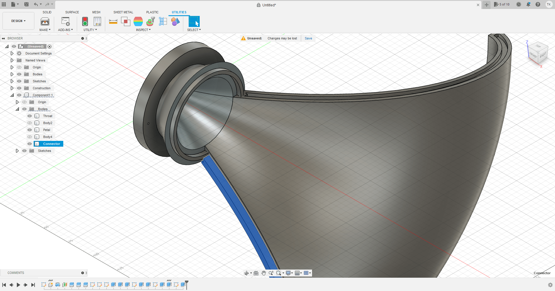

It's use is simple though.
1) ath generates a .afp file
2) create a config file in the same directory and with the same name as the .afp file, only with the extension .cfg (see post #1)
3) start Fusion 360
4) Utilities -> Add-ins -> select 'CreatePrintableWaveguide' -> click 'Run'
5) Done! (see post #2)
The code is still brittle though. It relies on id's that are not always the same. I need to find a more robust way to get to bodies, faces and the like.

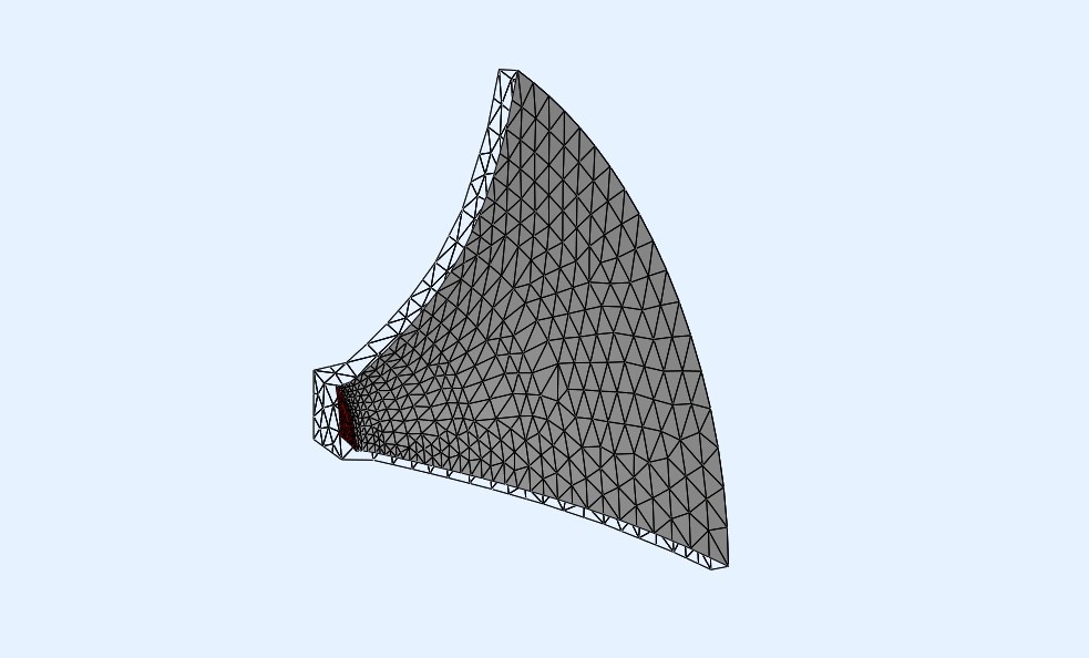

For non-axisymmetric waveguides, Ath provides STL-files that are imported into Fusion like this:
Despite the looks in Ath,
... they do not import with a wall and have no mounting flange defined.
If at a later stage of development you have a chance to include this case, it would be wonderful. Thanks for your work!

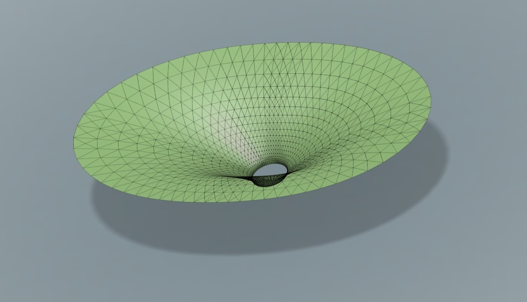

@docali made some scripts up to turn co-ordinates in a CSV file into surfaces through python scripting in Fusion. These are capable of working with any geometry. He might be willing to give you some pointers if you wanted to expand out of axisymmetric.The code and my knowledge need some work to do that.
Funny that two of the smartest people I have come across have no problem scripting the program but struggle with the GUI 🙂
I will show you how to import an irregular shape into Fusion as a smooth surface, I do it all the time, have a Python script for that already, it's just that it is easier to do the rest (the flange, fillets, etc.) manually with the GUI, I think. That's the point where I gave up with scripting.

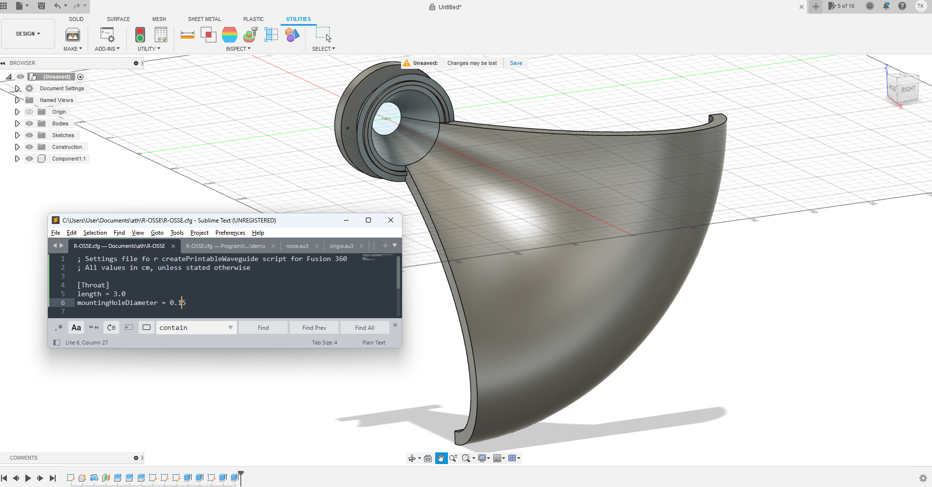

Not much news on the functionality. Code is getting cleaner:
Python:
(throatSettings, throatMouthConnectorSettings, petalConnectorSettings) = read_config(dlg.filename, unitsMgr)
importAFP(dlg.filename, rootComp, sketch)
(fullWaveguide, ext) = revolveProfileIntoWaveguide(sketch, rootComp)
createMountingHoles(rootComp, throatSettings.mountingHoleDiameter, extrudes)
(splitBodyFeats, offsetPlane) = splitWaveguideIntoThroatAndMouth(fullWaveguide, rootComp, throatSettings.length)
petal = splitMouthIntoPetal(rootComp, ext, splitBodyFeats)
throat = ext.bodies.item(0)
createThroatMouthConnector(throat, rootComp, offsetPlane, throatMouthConnectorSettings, throatSettings.length)
generatePetalConnection(petal, petalConnectorSettings)
- Less brittle body and face id-ing.
- further use of configuration (with units!)
Code:
[Throat]
length = 80 mm
mountingDiameter = 76 mm
mountingHoleDiameter = 6.5 mm
[ThroatMouthConnector]
slotWidth = 3 mm
slotDepth = 3 mm
connectorWidth = 2.9 mm
connectorHeight = 5.8 mm
hasFillet = True
filletSize = 1 mm
[PetalConnector]
slotWidth = 3 mm
slotDepth = 3 mm
ConnectorWidth = 2.9 mm
ConnectorHeight = 5.8 mm
hasFillet = True
filletSize = 1 mm

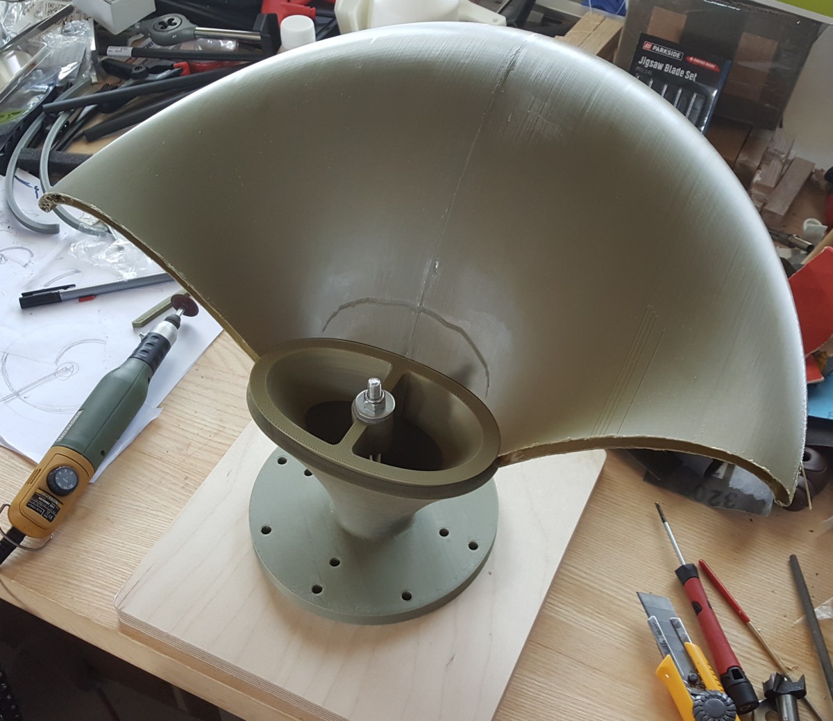

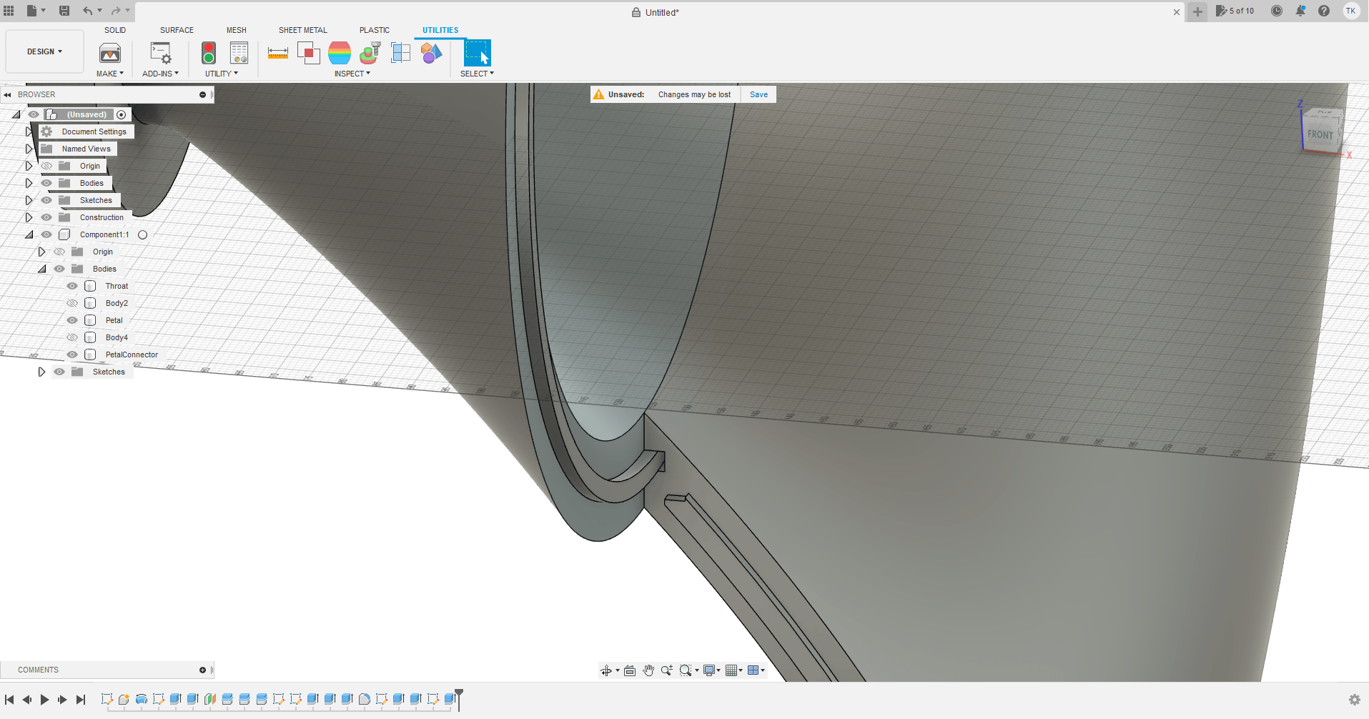

Some more structuring, learned a bit, still need to learn a lot.
In the mean time, more config items actually do what they are supposed to do.
The separate connection pieces make it easy to tune the size of this w.r.t. the slot; you can quickly print small pieces in search for the best fit for your printer (settings).
The fillets on these pieces is to be insensitive to the elephants foot of the printer.
I was thinking of adding some features to be able to screw the waveguide together. Either as a glue help or maybe as a possibility to test multiple petals on the same throat (e.g. for different tmax values). Just thinking out loud....

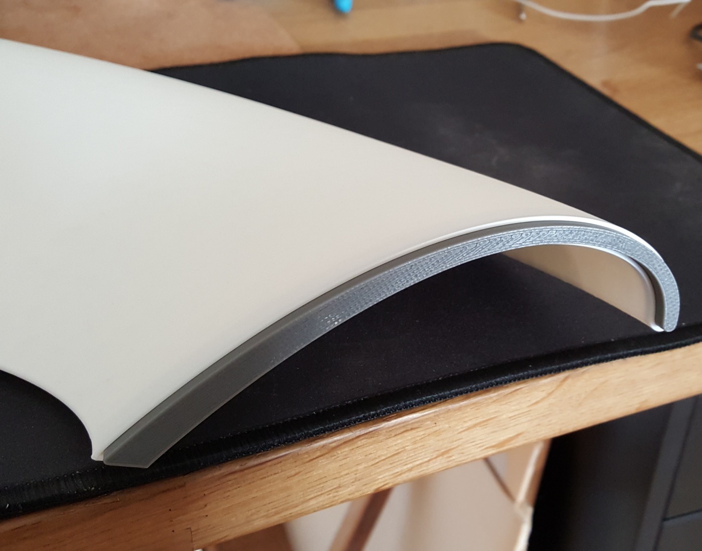

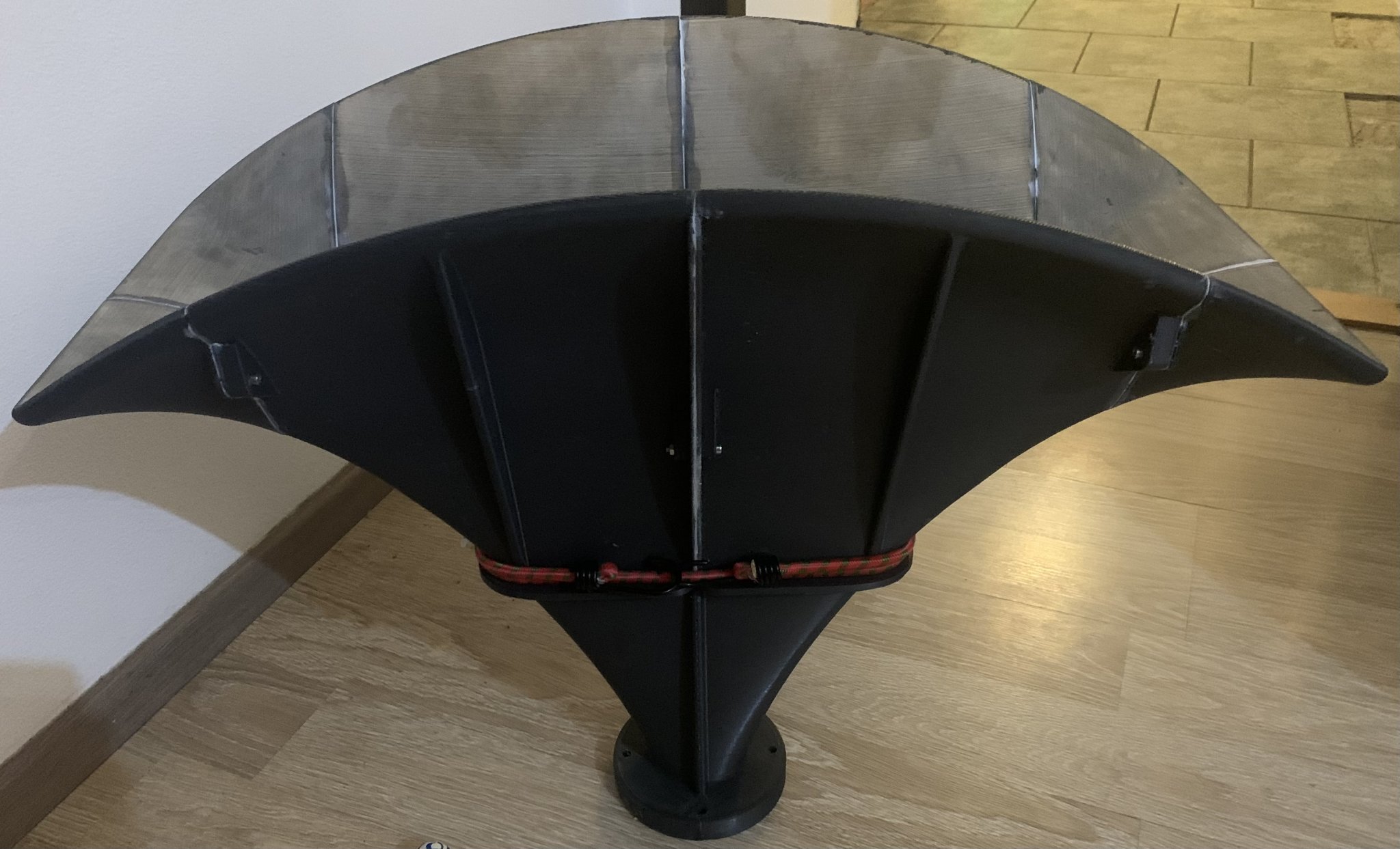

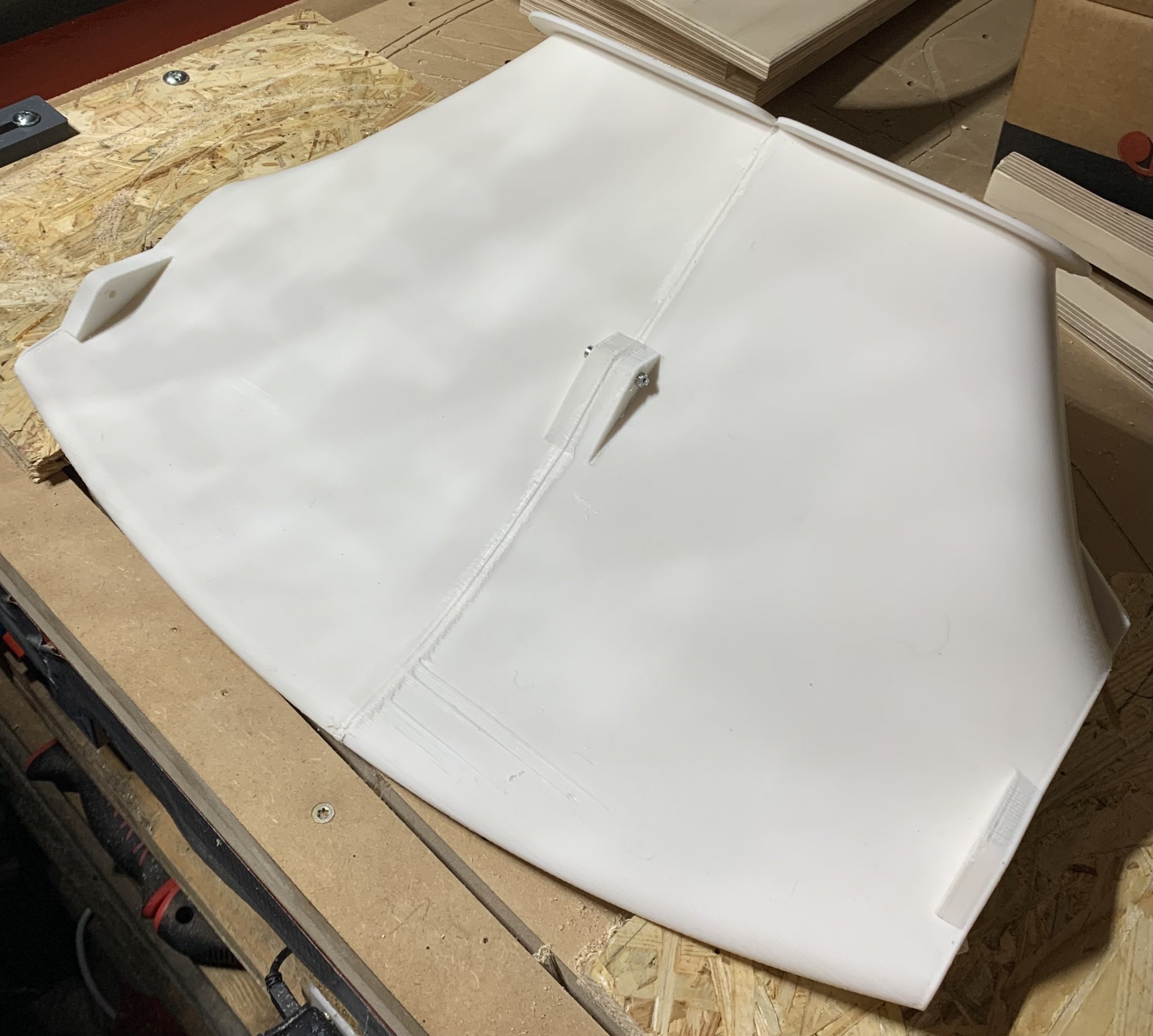

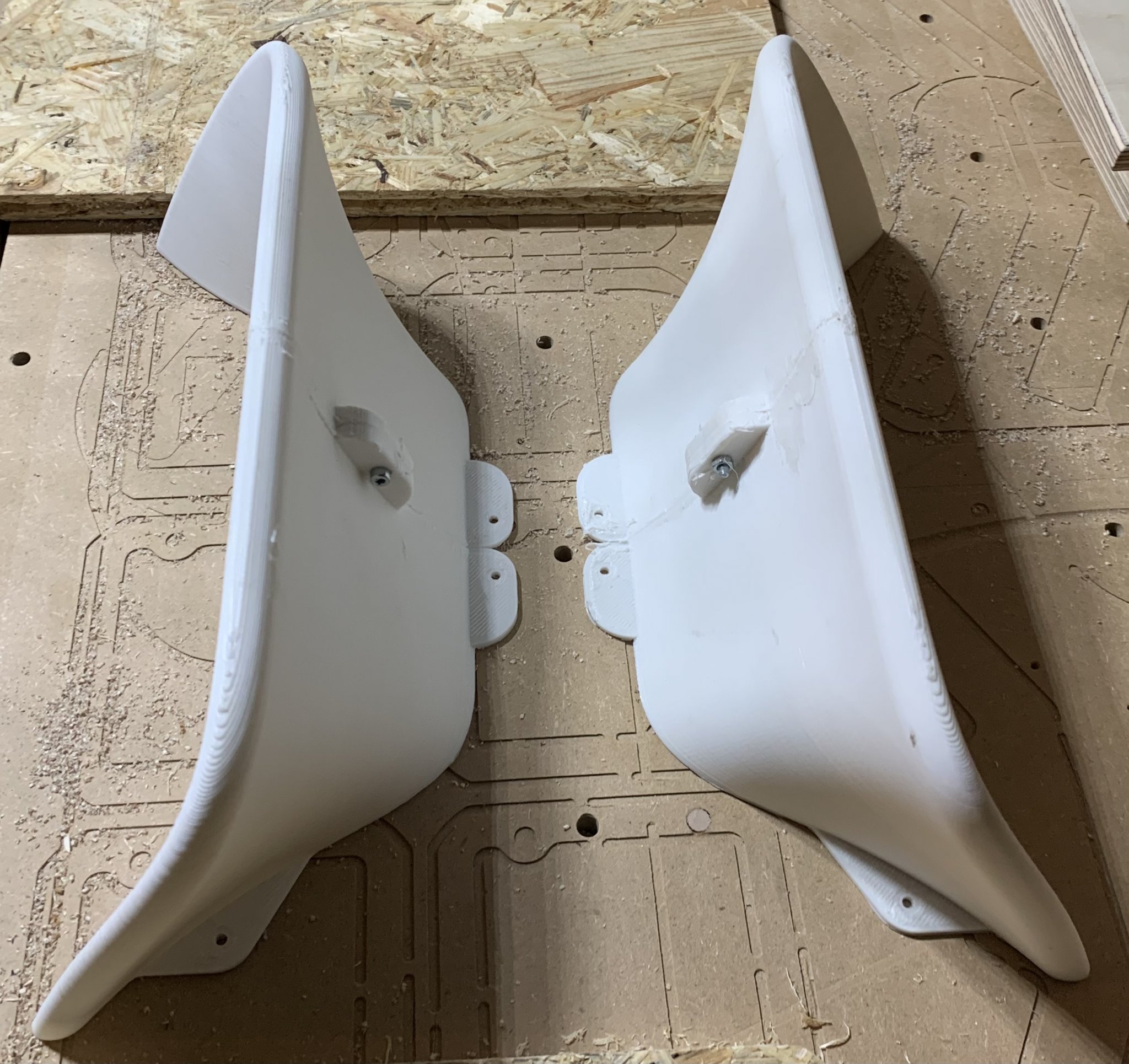

It definitely helps to use screws, I added some extra ribs to the second version of this: https://www.diyaudio.com/community/...-neile-alo-horn-by-sphericalhorns-net.390581/
I added ribs to the edges instead of the tongue/groove. The dark grey is the newer version with the rib along the whole edge, the white one is the older one with just small areas for screws. All done by hand, I have never used neither scripting nor parametric modeling in F360.
I sketched the shape on the dividing plane including the screw holes, then extruded the shape in the direction of the part and merged it with the part. Then I added a fillet where possible from the other side (sometimes it failed due to the shape). Of course, it depends on the printing orientation. I used just a hole (ideally two per flange), bolt and nut. I also used pyramidal alignment pins, so I could do with one bolt only.
