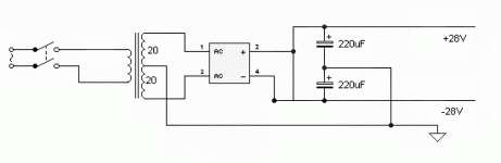

So you think that for my 2x50W your 20-0-20 at 2 amps is fine? Can you post a power supply schematic?
Thanks! So what is the VA rating of the transformer for both channels? I opted for a shared power supply, with a single transformer with double secondaries. Any problems with this? I mean, everyone here is suggesting to have 2 psu... but like I said hi-fi quality is not my target...
And to have about 50W per channel, what supply I have to look for? I mean what voltage of the transformer, it's ratings, capacitors...

Giaime said:Thanks! So what is the VA rating of the transformer for both channels? I opted for a shared power supply, with a single transformer with double secondaries. Any problems with this? I mean, everyone here is suggesting to have 2 psu... but like I said hi-fi quality is not my target...
i have a single power supply powering both chips. its 20-0-20V at 100VA which most people here i think would say is a little low but i'm not having any problems. the caps are rated at 35V which IS too low but thats what i had at hand. they should be at least 63V
And what kind of heatsink I should use? what termal resistance? should I go with CPU heatsinks with the small fan (they're just an economy move)? Should I isolate the chip from the heatsink?
i'm not sure of the thermal resistance of my heatsinks, i got them in a grab bag...but i think that a CPU heat sink will work fine even without the fan unless it is one of those heatsinks that is only a fan. the fan may cause interference with the signal but i'm not sure.
yes u shoulld isolate the chip electrically from the heatsink since the back side of the chip is connected to the negative supply and the box you are mounting it in is grounded.
But with a 100VA toroid, small caps, shared psu, isolated heatsink (that means worse contact, and rise in temperature) what power I'm gonna get? and it is safe and reliable? You know, if it has a THD of 1% on the stage it won't matter, but if after 30 minutes you could fry an egg on it...
