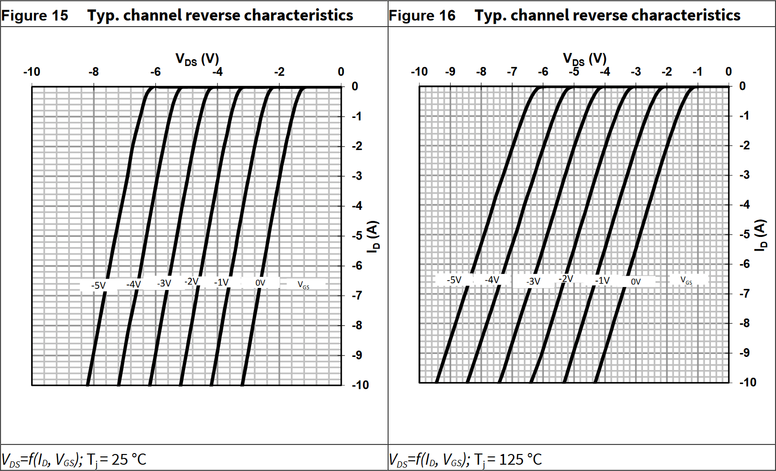

<CRAZY_AND_OR_STUPID_IDEA>

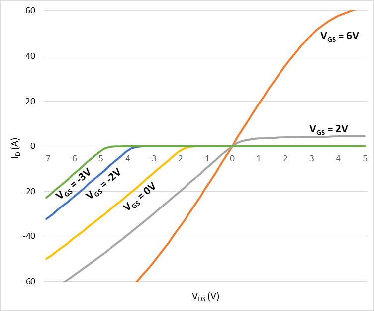

Whiling away the eternity, looking for in-production transistors that would exhibit triode-like behaviour, I've stumbled upon an enticing picture (Exhibit A, comes from this presentation) showing the 3rd quadrant / reverse conduction characteristics of a GaN transistor. Reading up on these a little, it appears that - unlike J/MOSFET, where the PN junction / body diode spoils the fun (I still can't make heads or tails of how BJT fit into all of this) - GaN will cheerfully conduct in the reverse direction in what I can only describe as triode-like manner.
So far so good...

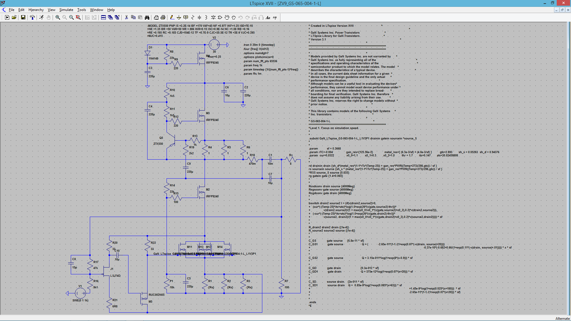

Now, taking heed of Mr Pass's admonition that the GaN parts like to burst into flames as soon as look at you, I went thru their data sheets looking for ones w/ explicitly specified DC SOA, and found a couple (and a half) that fit the bill:
Besides DC operation, these guys even have positive VGS(th) tempco! Unfortunately, they come in minuscule PiP [Pain-in-Posterior] SMD packages and would most probably dissipate their tiny little hearts out before any meaningful power could be extracted from them.
But if one went the ZV9 / F3 way and cascoded a few of them paralleled*, mounted on an IMS adapter board... (* That kinda excludes the Infineon parts as they are much too pricey.)

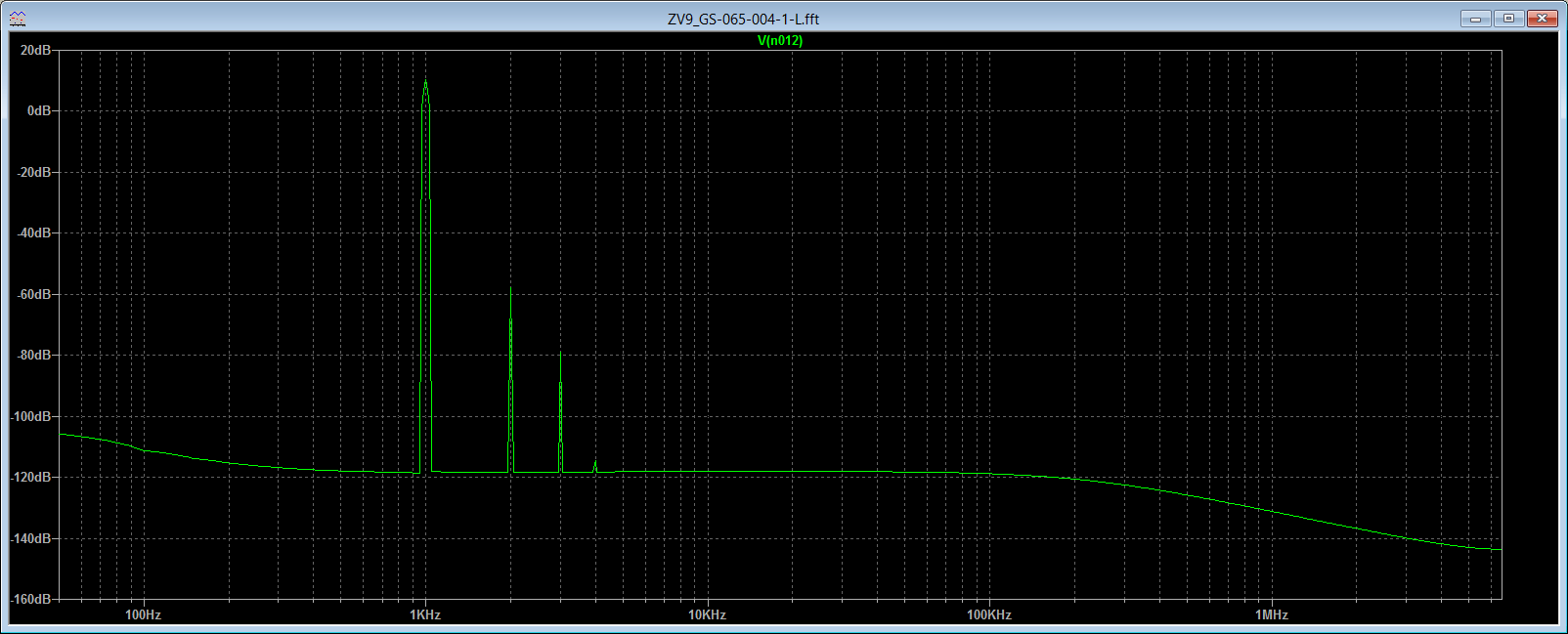

A quickly cobbled up simulation gives a 1.5W avg dissipation per one lil' bugger in a quad, and you can either run the sim yourself or check the ~1W / 8R distortion profile attached.

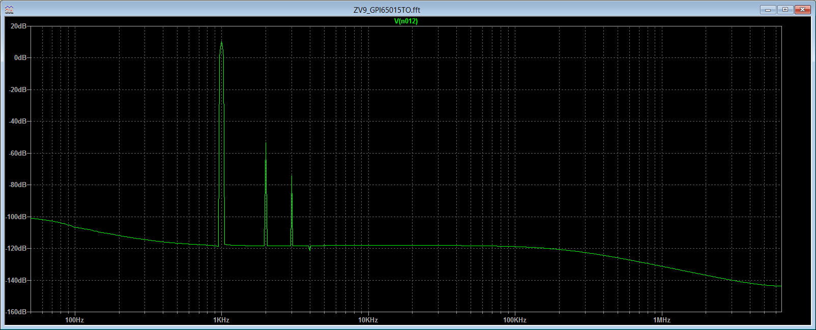

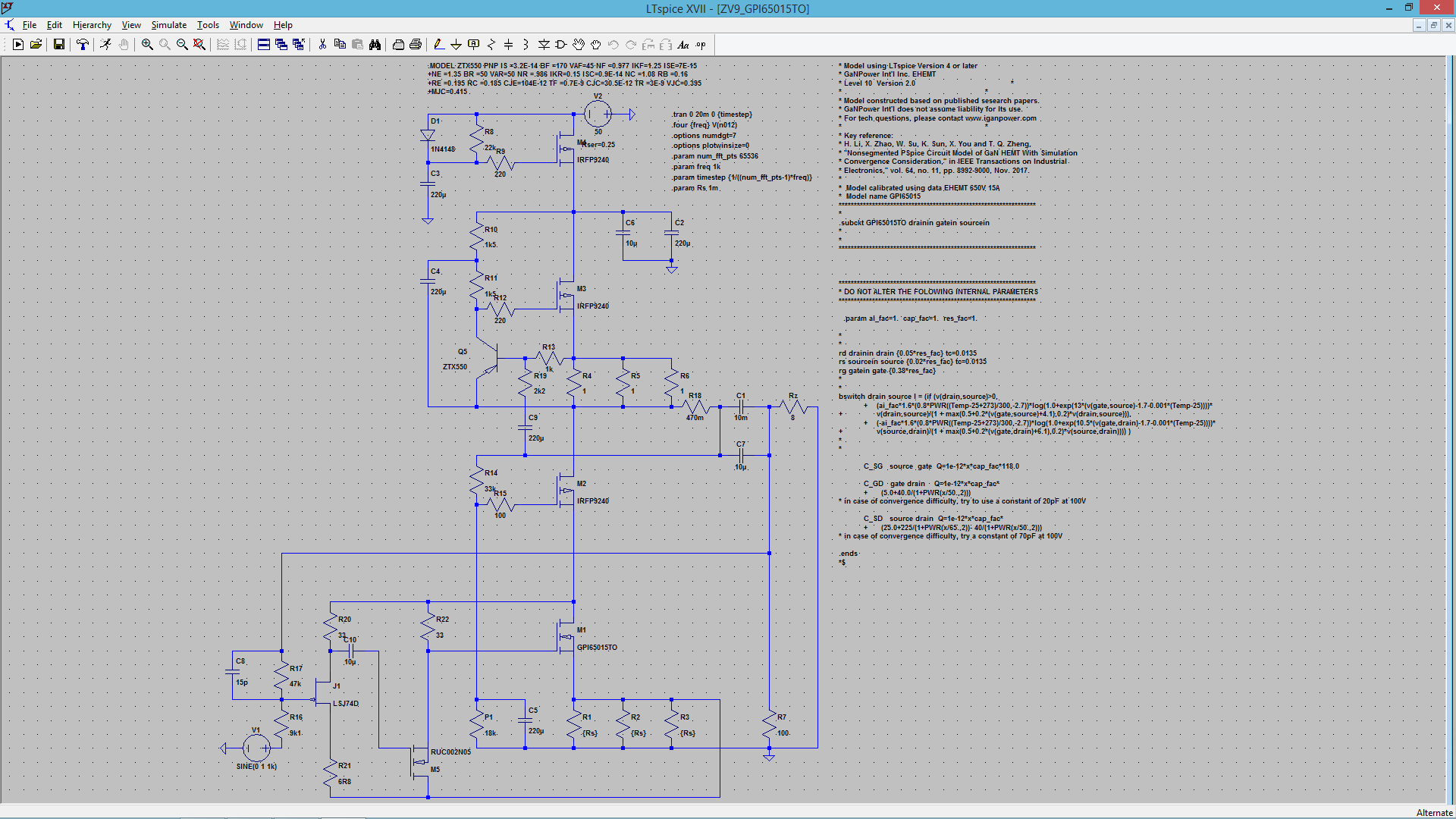

The missing half is the potentially usable GPI65015TO from GaNPower in a much more convenient TO-220 package, but it's only a half "hit" because - while positive VGS(th) tempco is clearly shown in the data sheet - the SOA chart is absent altogether. (I asked GaNPower about that - they said they'd look into it; they already fixed an error in the DS that I reported.)
</CRAZY_AND_OR_STUPID_IDEA>
P.S. NexGen supposedly manufactures a vertical GaN JFET, NXG2EB120985, but there's only 1 reference to it here, and my enquiry for more details remains unanswered...
  • ZV9_GS-065-004-1-L.asc

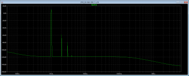

  • ZV9_GPI65015TO.asc
    ZV9_GPI65015TO.asc

The best way to look at the fet in that quadrant is that, if voltage is aplied to it, the higher the power supply voltage, the higher the voltage between gate and source needs to be (closer to the drain voltage).
When you drive the gate to the source (of course you can to +5 volts, flipped polarity, normally with an N fet this would be similar to -5 VGS), the lower it gets, the more it conducts.
Kind of counter intuitive.

So, could this be the replacement for vintage vfet from 70s? I am not an expert but I read some documents showing they are internally normally on and vertical structured bla bla, besides some output characteristics looks like vintage vfet. I don't care efficiencies or switching speed, but i care the warm sound characteristics which I think defined HiFi from very beginning. If they are good or better, we could diy futuristic vintage class a vfet amp!
So, could this be the replacement for vintage vfet from 70s? ...
That's exactly what I am suggesting! 😀 But - as corroborated by @mterbekke - the usable VSD and power dissipation have to be worked around. That's why I proposed the cascoded / paralleled approach...
Those are 7mΩ RDS(on), starting at $12 a pop at Mouser. I may be wrong, but my understanding is that - for linear operation - higher RDS(on) is more desirable (safer). Hence, my choice of GS-065-004-1-L, with 450mΩ RDS(on), starting at just about $3 a pop. My plan is to parallel 4 per channel - with the $12 parts, I might as well get me some proper Tokin triodes... 😉

The GS-065-004-1-L have bottom cooling and at 4 degrees per Watt are 8 times worse than the 0,5 degrees per watt of the GS1008T. You also have to cool them via the pcb on the bottom side, tough to do without a lot resistance added again.
Power dissipation of the top cooled part is so high that if you break them, you either overloaded the gate, or cooled them so bad that they loose the solder paste used and come off by themselves ;-)
That`s how safe the top cooled are, I can`t speak for the other types.
Honestly, I think the 650 volts types look great in reverse voltage mode, but I had trouble cooling the bottom cooled parts I used earlier (Panasonic), knew the characteristics change a lot with temperature (Gm goes down significantly), didn`t need the speed of less capacitance and also didn`t look forward to problems of paralleling them (oscillation, height/mounting/cooling differences) and more points of failures than just 1 fet. So it`s funny I considered them safer instead of less safe;-)
In normal operation, (the question about the VFet characteristics) the 650 volts part looks way less linear (IDS vs VDS) than the top cooled part, but i`d just test them on a bench to see that. I don`t know if the simulation model allows for linear operation and highly doubtful if the reverse quadrant is even more than just a very basic approach of the real world.
Also interesting to know:
The second image you showed (the Infineon IGLD60) looks more like the earlier reverse characteristics of the GanSystems (all of them). They changed that to the more confusing ones they have now, that look a bit strange (not linear), because the gate voltage in steps from +6 to 0 and then -3 is displayed. The GanSystems (i guess all of them) are not linear around that range from 0VSD to around 2VSD, you can see that illustrated in your first picture.
In other words: for low feedback systems, the linear range is less than the total allowable VSD. This is important for your operation point, PD etc.
By the way the Infineon`s you mentioned earlier look like the earlier Panasonics like the PGA26E07BA. They quit production some time ago, it seems Infineon bought it from them. They performed well subjectively, but were hard to cool because of the bottom side cooling needed.
These types seem to need a gate current when driven, the GANSystems do not. I didn`t measure the Panasonics, but verified the GanSystems: i could find no gate current untill just over -10 volts.
ST also have 1 type, that datasheet looks a lot like one of the GanSystems.
Lots of borrowing from each other, sadly not that many really original products, and a lot of other types are internal cascodes and will not work in reverse mode.
None of this type of GaN allow a higher gate voltage than -10 volts, and since the max VSD is around VSD + VGth ,the maximum VSD voltage is always around 10 + VGth = 12 volts.
Again, I don`t think you can break them if you keep them below e.g. 100 degrees centigrade (the pcb will break sooner than the fet) and within VGS and VSD spec. Pretty easy to do.
