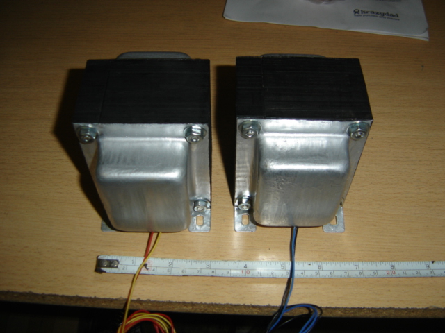

I have a pair of Electra-Print SE outputs that I had to re-stack after some rough shipping & "handling"....
They were not "dipped" - impregnated. Therefore the lams shifted when they were dropped. The paper gapping material was ripped and not flat anymore.
Is there a formula for determining the thickness? I have used some similar paper to re-gap them but I am wondering how critical it is?
They were supposedly for a GM-70, gapped for 125ma with priority given to HF response. They have perhaps only a quarter of the winding window on the bobbin filled. The lams are about the same size as Hammond 1628SEA. And it is only P-S-P layered. Is this normal? I though Electra-print had a good reputation for quality, but scramble wound with no interleaving really is something I could do myself... What am I missing?

Nobody else - only the original manufacturer - can tell you the exact air gap requirement for a particular installation. The simplest would be to ask them for the info. You can determine the airgap if you have measurement possibilities. You need to measure the inductance with DC current excitation. With the right airgap the inductance curve is flat up to the dc current of the tube. This type of instrument is very scarce. Another method is described in Sound Practices, unfortunately i don't find it right now, which needs more multimeters and a power rheostat. The title of the article is something as "Use your old junkbox chokes" or similar. Do not put a normal piece of paper in the transformer as air gap!!! Most of the papers contain very corrosive substances, make the iron rusty. Use such materials which are used in transformer windings as electrical row or layer insulation.
Thnaks for the reply. I had planned on using some "Back-Papier" its a type of food baking paper and is very sturdy and non toxic. I measured that 2 pieces stacked is almost exactly the same width as the original.
If I reduced the gap slightly would I gain bass response with a lower MADC flowing through the trans. due to the increased inductance?
