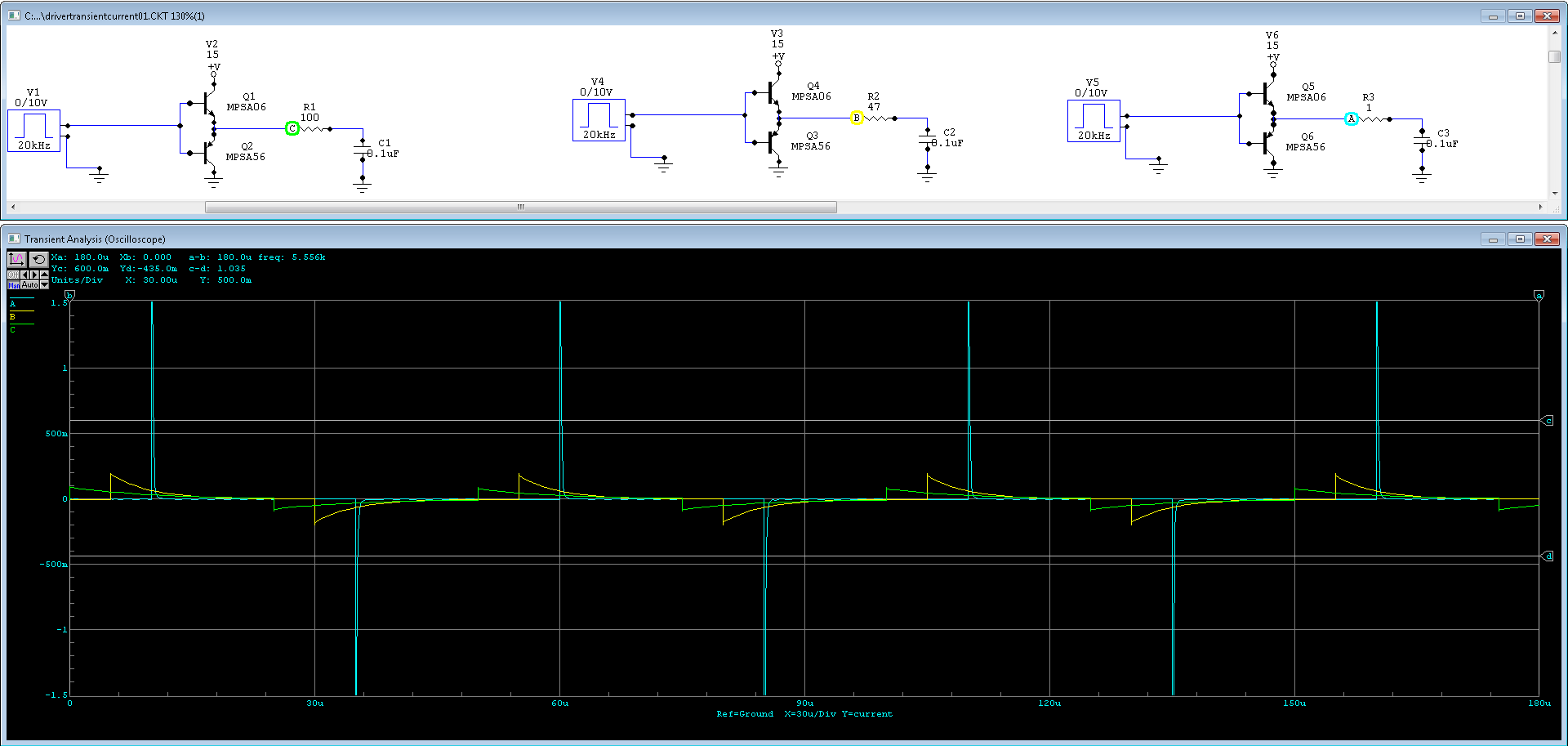

How does the gate resistor value affect the waveform? Does a higher value cause the wave to slope up more vs straight up and down?
You need to balance the drive to the FETs vs the load on the drivers. Too much resistance and the FETs likely run hot (and eventually fail). Too low resistance and it loads the drivers (possibly to the point of failure).
In the image below, you can see the transient current in the drive circuit with various gate resistor values. You can see that the lowest value has the highest spikes in current.

The gate is really just a capacitor. So you have an RC circuit. For a step voltage rise the peak current will be the step voltage / gate resistor value. So compare that with the current capability of the driver.
I see neither gates nor gate resistors, but I see bipolar transistors and load resistors? Go easy on me.In the image below, you can see the transient current in the drive circuit with various gate resistor values.
The FET gate acts much like a capacitor. The resistor between the EF pair (drivers) and the capacitor are basically the gate resistor.
