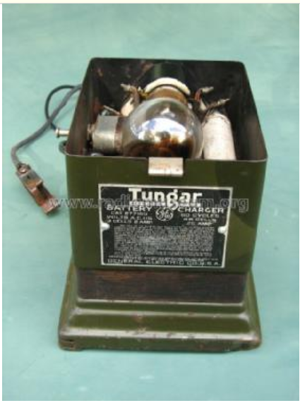

I have recently restored a Tungar Bulb Charger. It is working great. This model was used not only to charge car batteries but was used as a Tube Radio battery eliminator. I have the 2A model. It has multiple taps.
Tungar Battery-Charger for A and B Power-S General Electric
My question is, if I use this as a battery eliminator what kind of filter would I need to create? Given that it has a high current output does that mean I can use modern high value filter caps?
If I use it as a Battery Charger would I still need to filter it if I intend to add a charger cutoff circuit to protect the battery?. I know many chargers use pulsing DC, but will the circuit linked below have an issue with that?

I’m not sure how tungar rectifiers would handle filter caps. Lead acid batteries like ac ripple, you won’t find caps even in modern battery chargers.

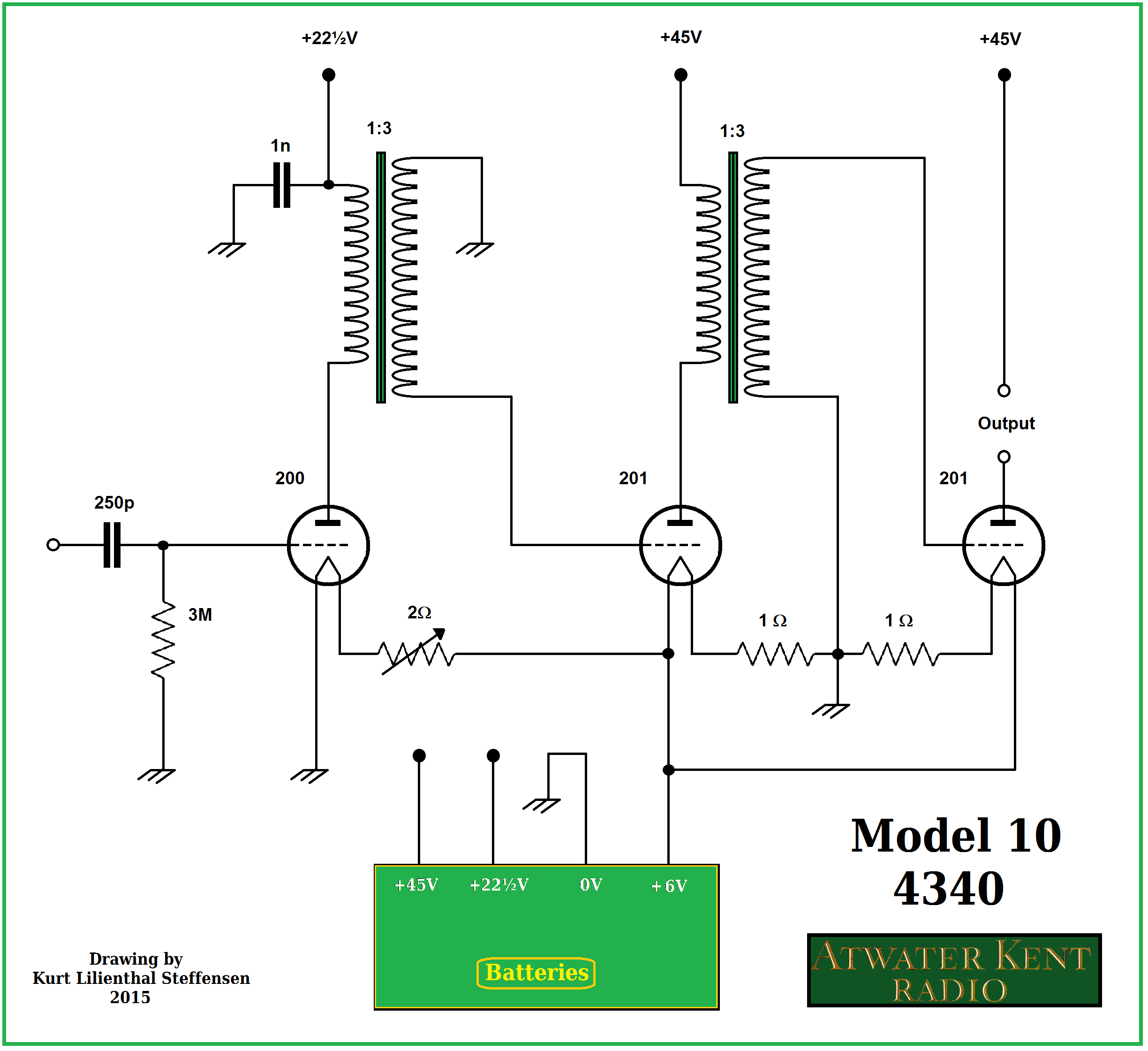

Its a lovely looking radio ,its a TRF design but no reaction control (UK speak ) - no regeneration ( US ) which means its not at all sensitive and requires a VERY long aerial.
You do know there are Seven versions of that model and the three tube version is the smallest ?
Modern battery chargers aren't linear anymore though, but microprocessor controlled switching systems. They make clean enough DC to run an inverter directly, too 🙂
Unless you get a really cheap POS that is.
Just like today, there are dozens/hundreds of models of "battery charger". You are going to have to figure out exactly what you have.
Battery chargers like these would typically NOT be isolated from the line. Touching the output can give you a shock. Deadly; but remember our ggg-grandfathers faced runaway horses, wood brake shoes, overhead drive belts in factories, and 1918 Flu (and there was a war on); electrocution was just another risk.
In those days we charged lead/acid batteries with a large current (limited by charger resistance/heat) until the acid boiled. (Maybe a hygrometer to stop just before boiling.) Today's lead/acid batteries will not take much of this treatment. But adding a microprocessor to a Tungar is really strange.

Around 1950 I worked as a 'grease monkey' is a auto service station. We did a lot more than sell gas. Some of those Tungar based rectifiers were still being used to charge batteries altho copper oxide & selenium were common.

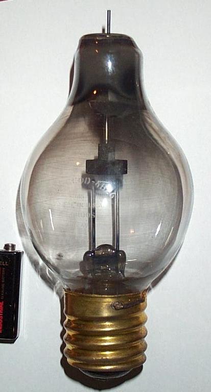

The Tungar rectifier is really 'brute force', it is half wave so the transformer needs to be gaped to allow for DC in the field.
Tungar is short for Tungsten Heater & Argon gas in the bulb.
Another point to stress is that like all gas rectifiers the tube has to conduct into something that will limit the peak current. When conducting the plate curve is vertical to negative, the unlimited current will soon destroy the cathode. The heater transformer can be setup as an auto transformer with lots of leakage reactance. That effectively limits the peak current while conducting.
If the Tungar ran straight into a battery the results would not be good.🙁
