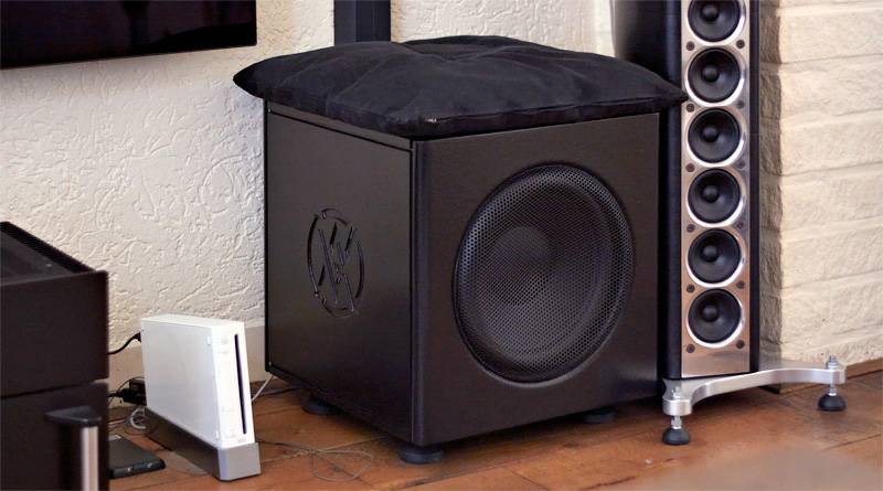

For bookshelf speakers on desks or cabinets I use 3M bumpers.
For speakers on polished floors I use plastic glides (see pic). Used to use spikes that went into centre of the X on PH2 screws in the floor but that was a pain.
The above two are arranged to give 3 point contact to the hard surface below them. 2 are located at the front outer edge and 2 are located in the centre of the back. I use 4 as I find it more stable than using just 3.
For carpet I use spikes so they contact the floor surface below.
For subwoofers I've tried SVS Soundpath or other similar methods.
Isn't the aim to stop the speaker from rocking? If you want to decouple from the floor then I imagine you have to go different routes. In the past I tried granite slabs under the speaker and these had rubber pads under them but was a waste of time and effort.
