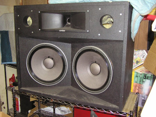

Today in a debate over enclosure qualifications, some one made the comment that George Augspurger used a BR for his studio monitor designs....
First of all...I don't know this to be true...MLTL gets confused for BR all the time...when I look at pictures of his designs it looks like BR at first glance...I see the inside being stuffed with dampening material...typical of TL not BR, so I thought.
Is anyone here, knowing whether or not George Augspurger studio monitors were actually BR or TL....if a BR whats the deal with the dampening material...and last, if George Augspurger did all this work on TL....only to eventually design a product using BR...did he come to the conclusion that TL is a waste of time...or is he just another designer cutting corners?

Regular Small type vented box AFAIK, but the short version: it doesn't really matter.
The point of transition from a Small type vented box (which technically isn't a bass reflex) to a mass-loaded QW occurs when one dimension is stretched sufficiently relative to the others for the longitudinal standing wave to alter the alignment you would obtain from a straightforward Helmholtz loading with the same Vb and vent dimensions.
That apart -well, QW loading can (as in 'can') provide the designer with more tuning options, or acoustical damping for a given set of vent dimensions if appropriately sized (i.e. long enough), but it's also still a vented box variation. It just doesn't happen to be using Helmholtz [cavity] resonance alone or as the primary mode.

And what Design is G. Augspurger using in his studio monitors?
From what i hear, is that he build his monitors tailored to the controlrooms he did design. He did use many techniques, depending on the situation in the room. Most of his studio monitors were custom builds for a specific studio, wich had their controlrooms done by him and were tuned inside the room and won't work outside that room. You did not buy a speakerset from Ausburger, but a total studio acoustic treatment including main monitoring tailored to that studio.

Already said. Regular Small type vented / Helmholtz, but it doesn't really matter.

I was lucky to have bought a pair of TAD 1601a woofers right before they were discontinued that I mounted into some cheap Parts Express knock down boxes while I looked for a better option. I recently researched Augspurger's designs because he used 1601a's, but I was unsuccessful in finding any details. Visually, it looks like his designs were lifted from, some might say inspired by, the TAD Exclusive 2401 and 2402.
I'd like to hear from someone who's listened to both designs to get an idea how they compared. Info on the 2402 is pretty scarce as well, but at least you can find the dimensions online, except for the port size and length.

Careless they are not. George's goals are referenced in his AES paper: +/- 1dB passband ripple for what he described as his optimised alignments ('optimised' in the sense that they were optimised for that specific objective) with a response ~ equal to a sealed box of equivalent internal volume, & reduced cone excursion.* They have a relatively well-damped impedance, but are not max-flat impedance pipes as that wasn't his primary consideration.
*At some point, being an open pipe, it will eventually unload @ 24dB/octave, but for these pipes it will be at a low frequency and sufficiently low level for this to be academic and not of practical concern.
