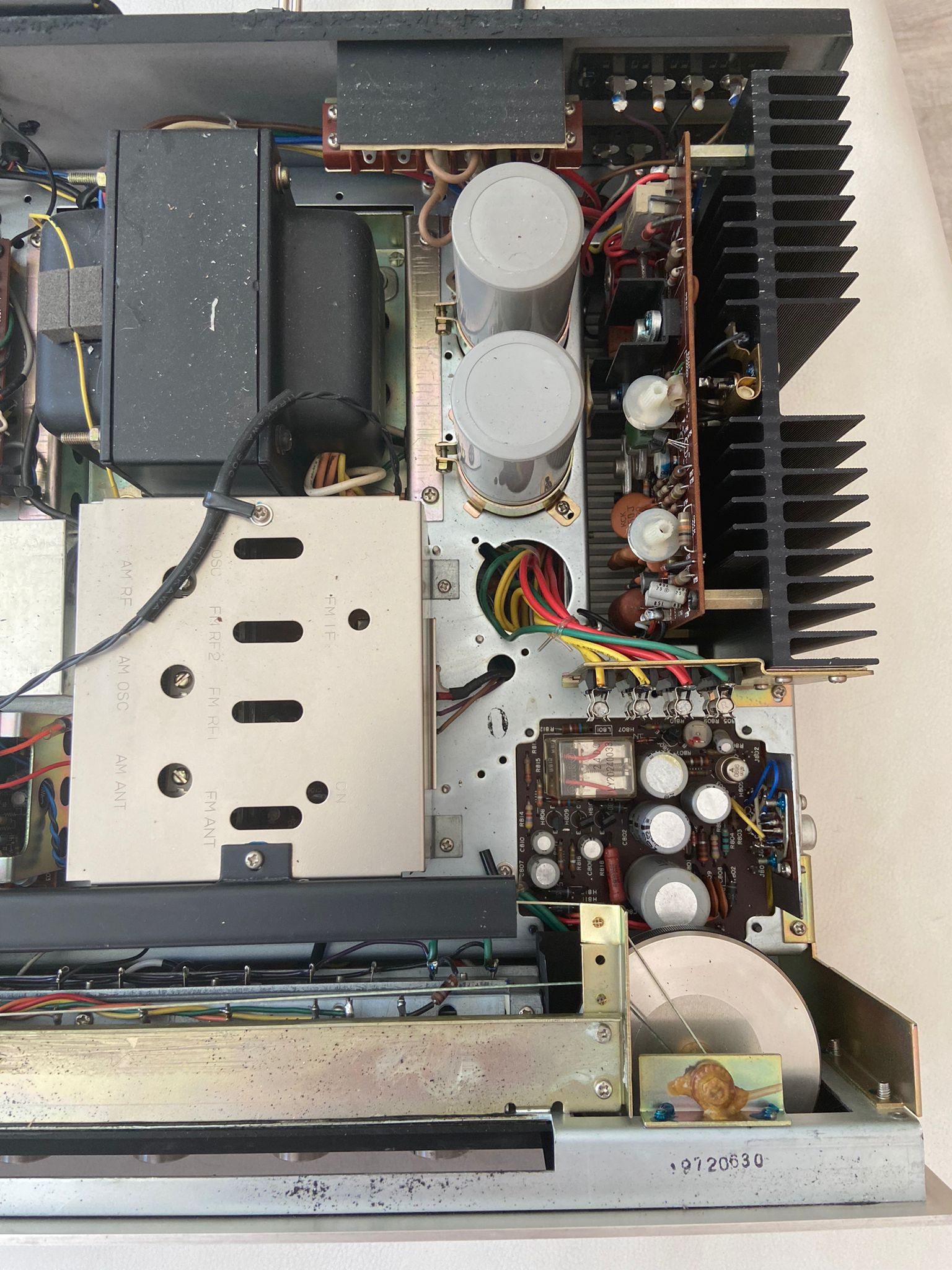

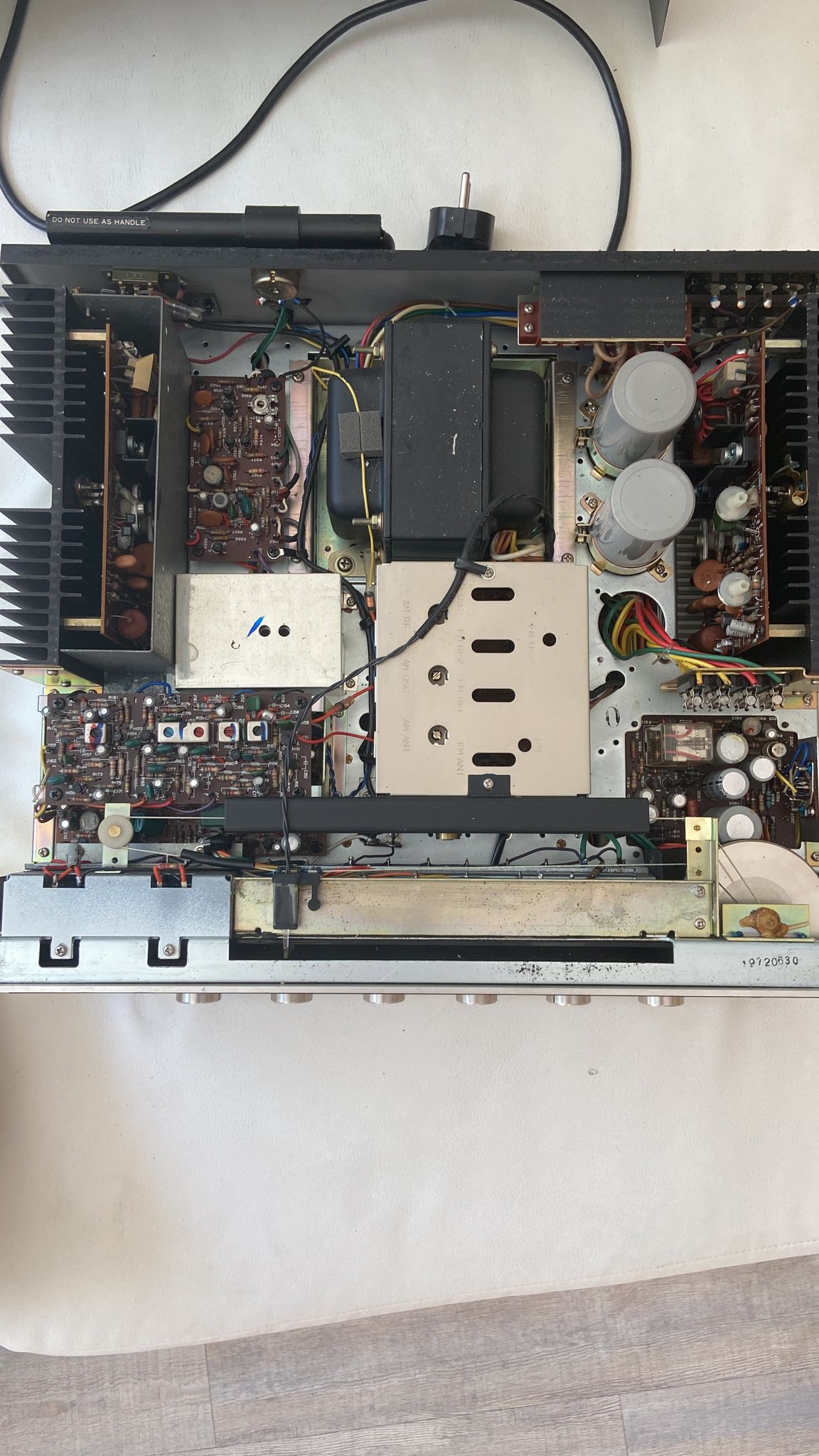

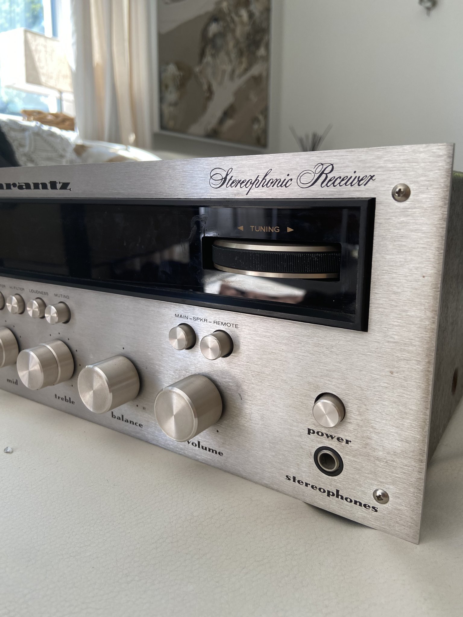

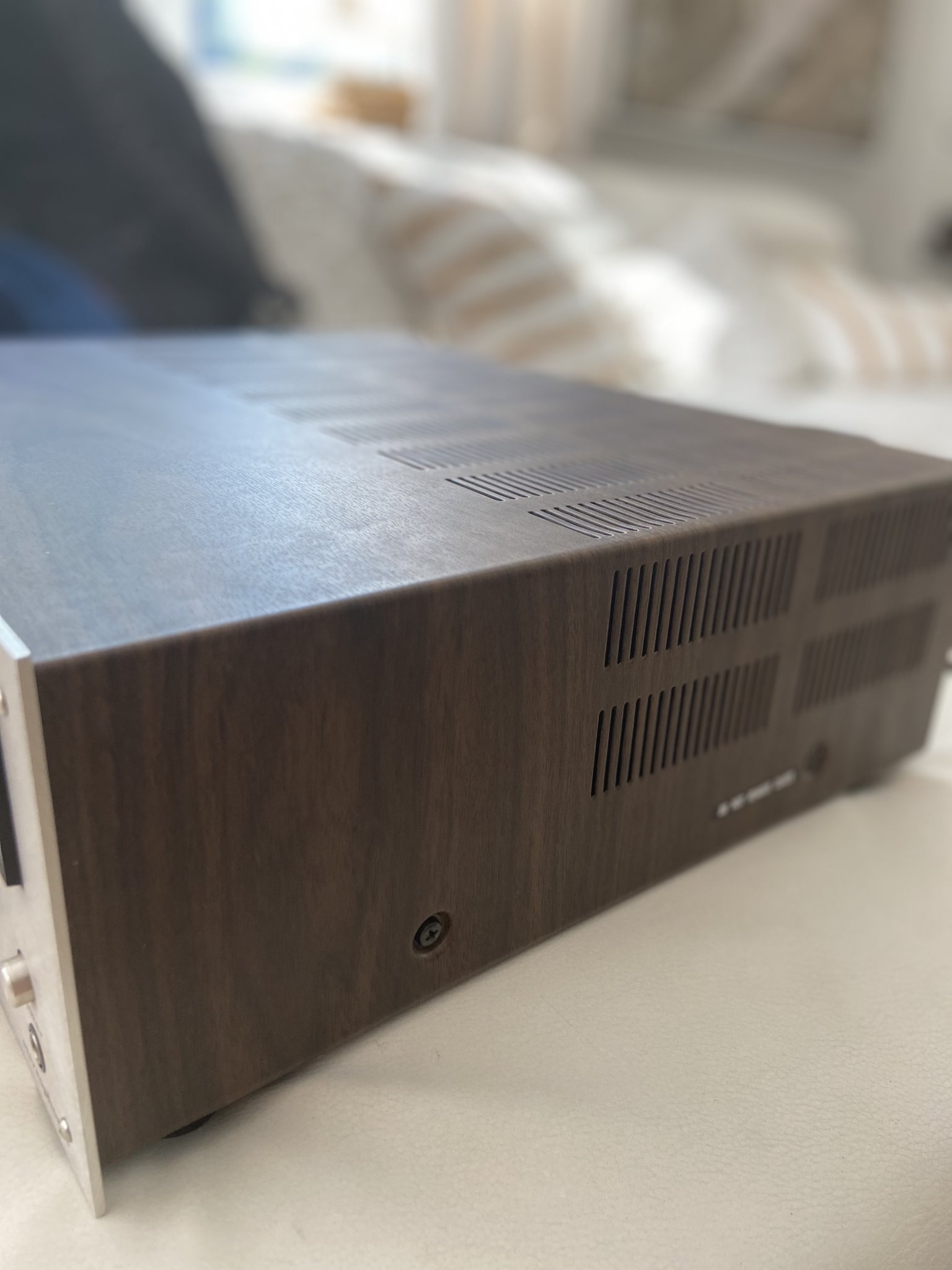

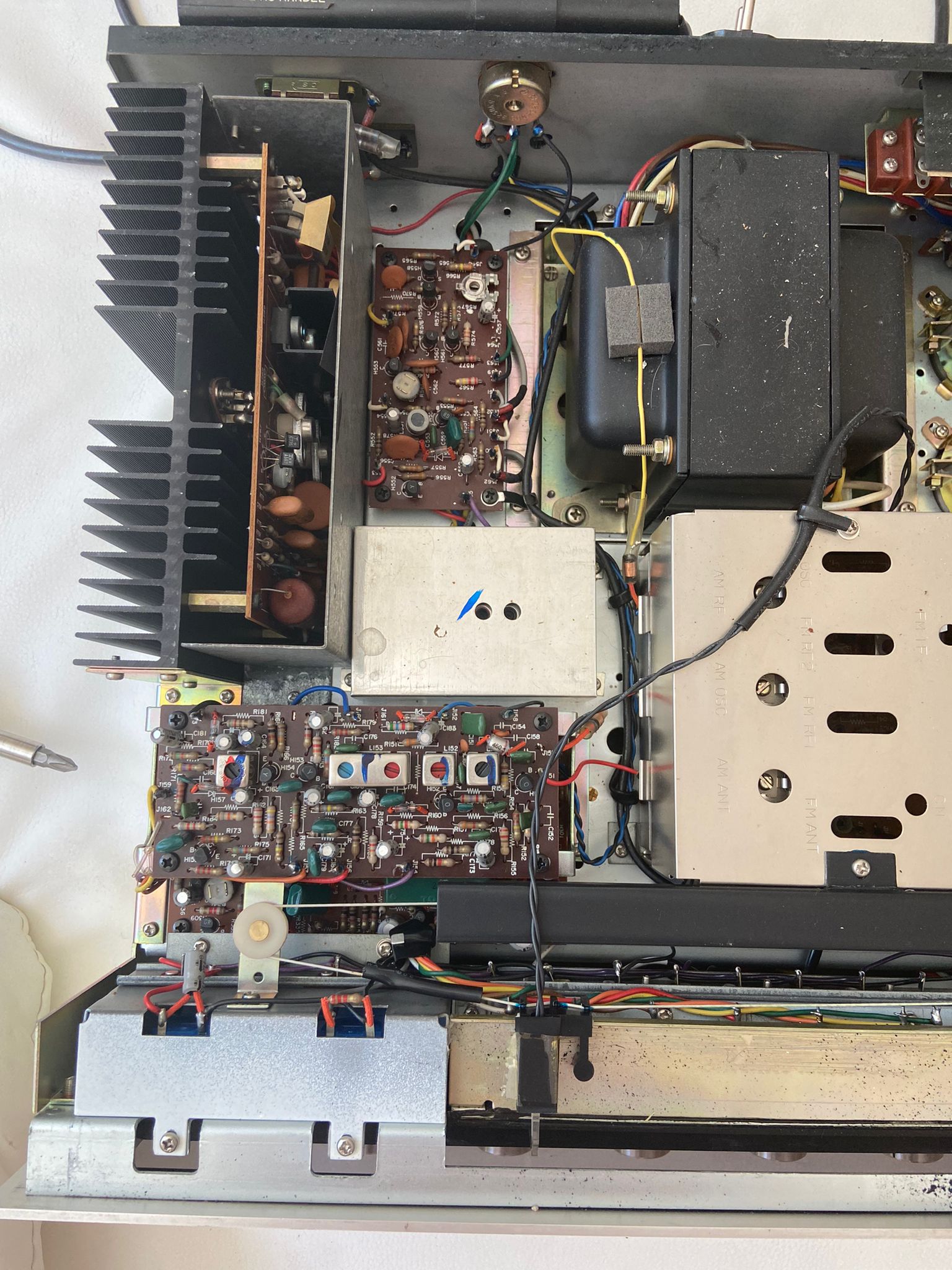

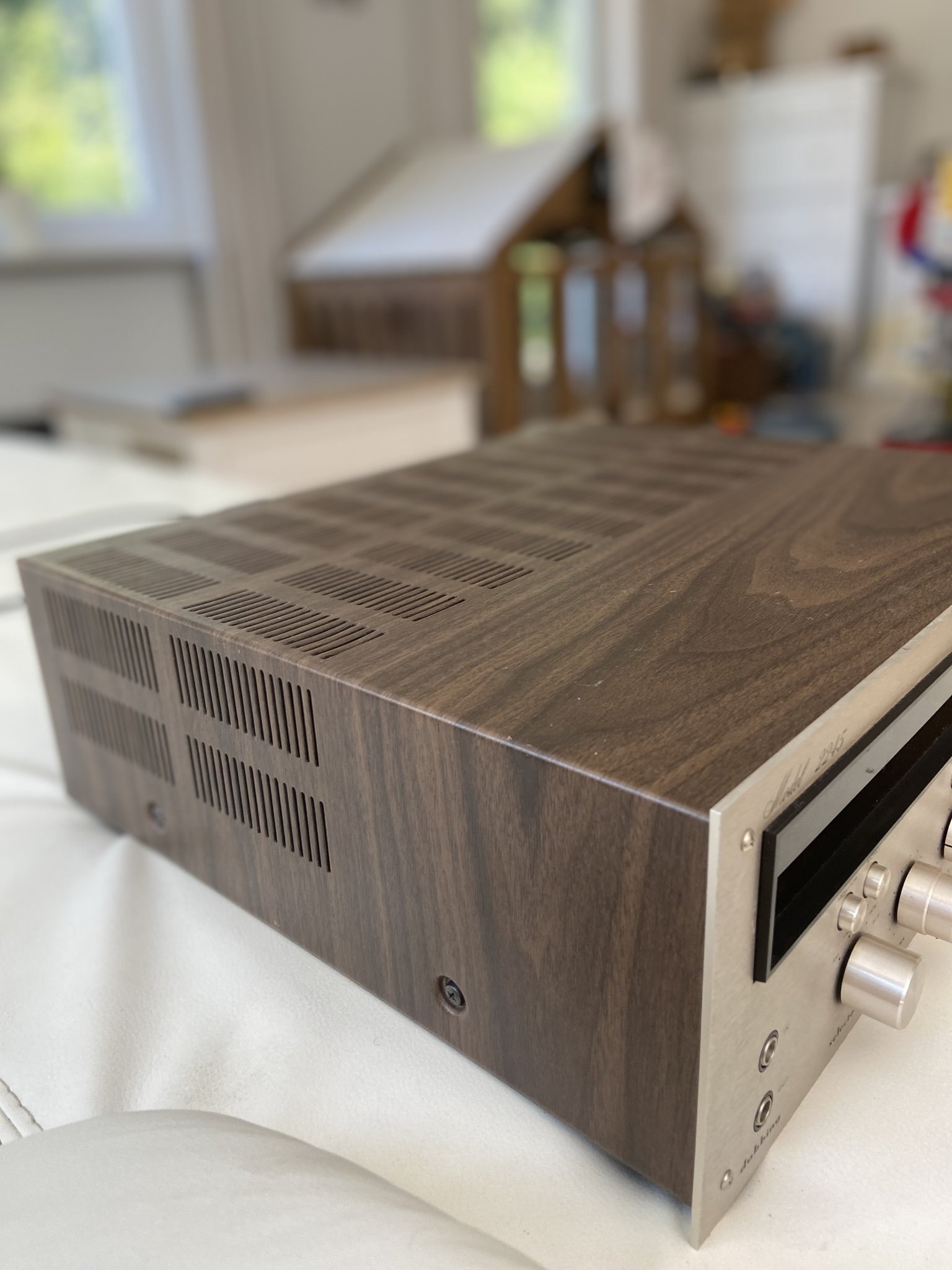

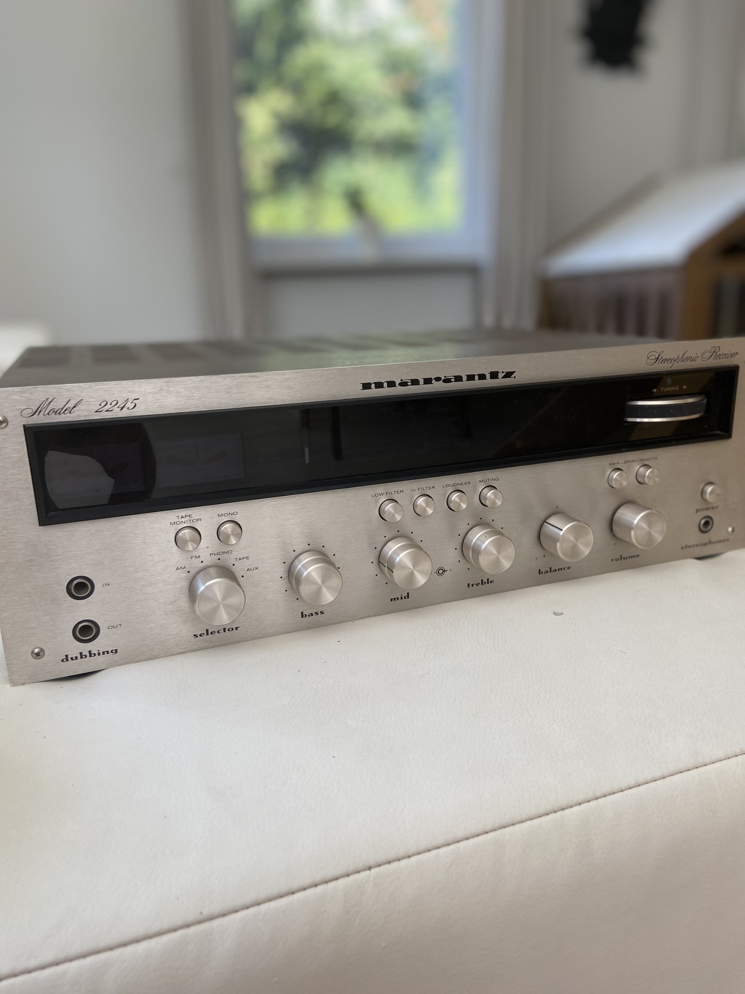

Following up here again. I have found one seller that has a 2245 for an OK price. (350EUR). According to seller, he is selling it because it was inherited from his father which passed away recently. He does not have speakers to try it out on, and lives quite far from me so it means I would need him to ship it to me.
He claims that at least he knows it was working around 6 months ago, because his father had it connected to the speakers. If he connects it to power, everything seems fine and all lamps etc seems to be OK.
Obviously it's impossible to know anything about the condition, but I guess that's also why the price is a bit lower. He seems like a trustworthy guy and he seems to be honest with the fact that he simply does not know anything about the history of the receiver since it was his father.
He did send me some pictures, but it is only on the outside - I decided to attach it here, perhaps someone has input or sees something out of the ordinary. I does look like it has no scratches or so - I do see some brownish edges around the front face plate, but perhaps this is something that can be fixed by just polishing / cleaning it on the front or using some sort of chemical? I asked if he knows if its been recapped / serviced or so, but he had no idea.
Any input on the matter would be greatly appreciated!
I almost told you "but it's not going well in your head? 350€ for a 2245 that you're not even sure works"
and then I looked at the prices on the net ...
yours is barely more expensive than a new woodcase made in Germany.
I hallucinate...
PS: here, the superscopes I picked them up in the recycling centers or for a few euros, I still have one that I took out from under a big crt tv in the container, it's a little crushed but works perfectly.
Otherwise I do not understand the interest of a receiver (in 2022) compared to an integrated amplifier (except for the pretty side of the backlit facade) but the tastes and colors ...
personally in this case I would take a 1030 or a 1045 or even a harman A401 and add a quality bluetooth receiver module to it, but once again, the tastes and colors...

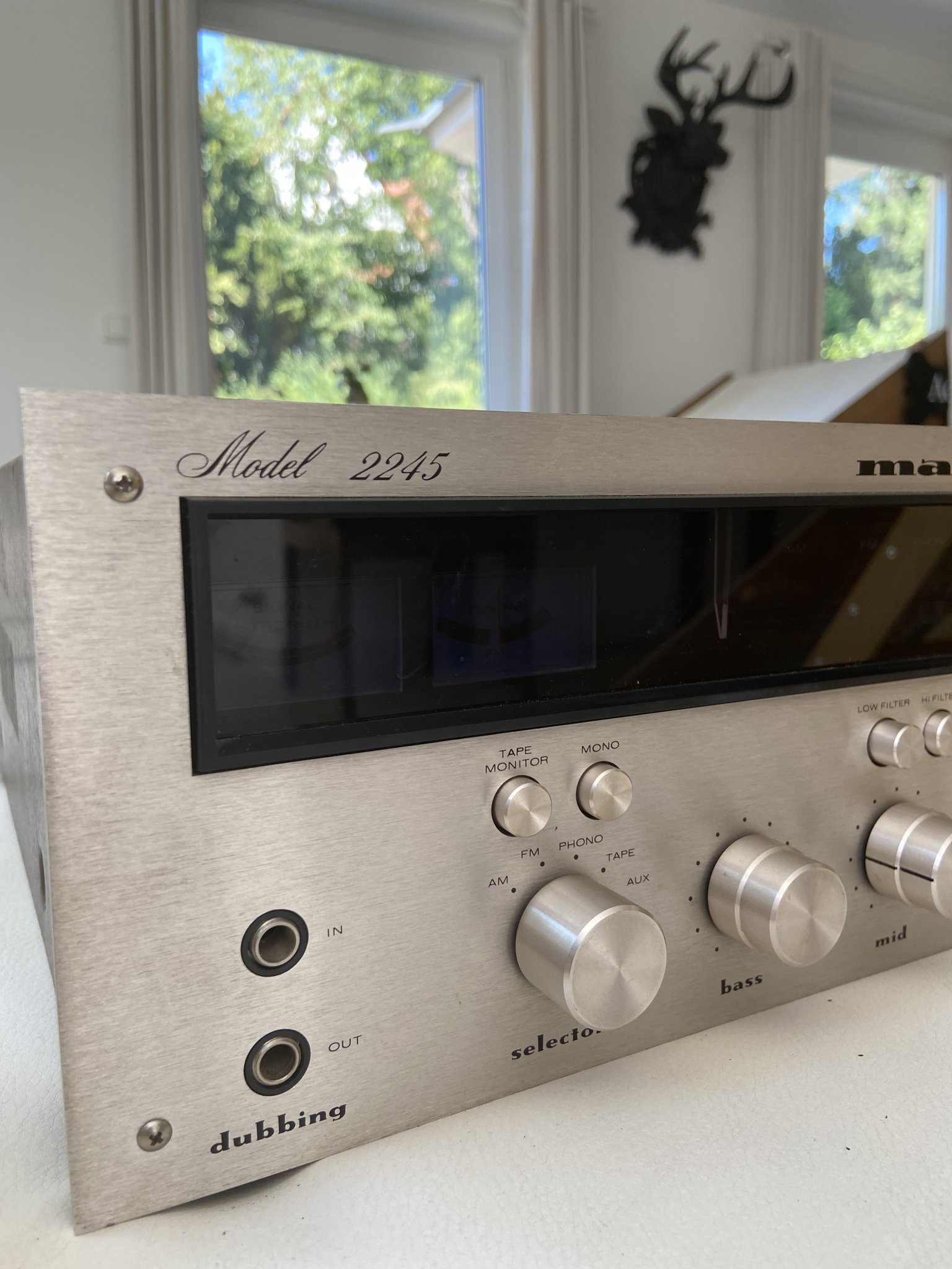

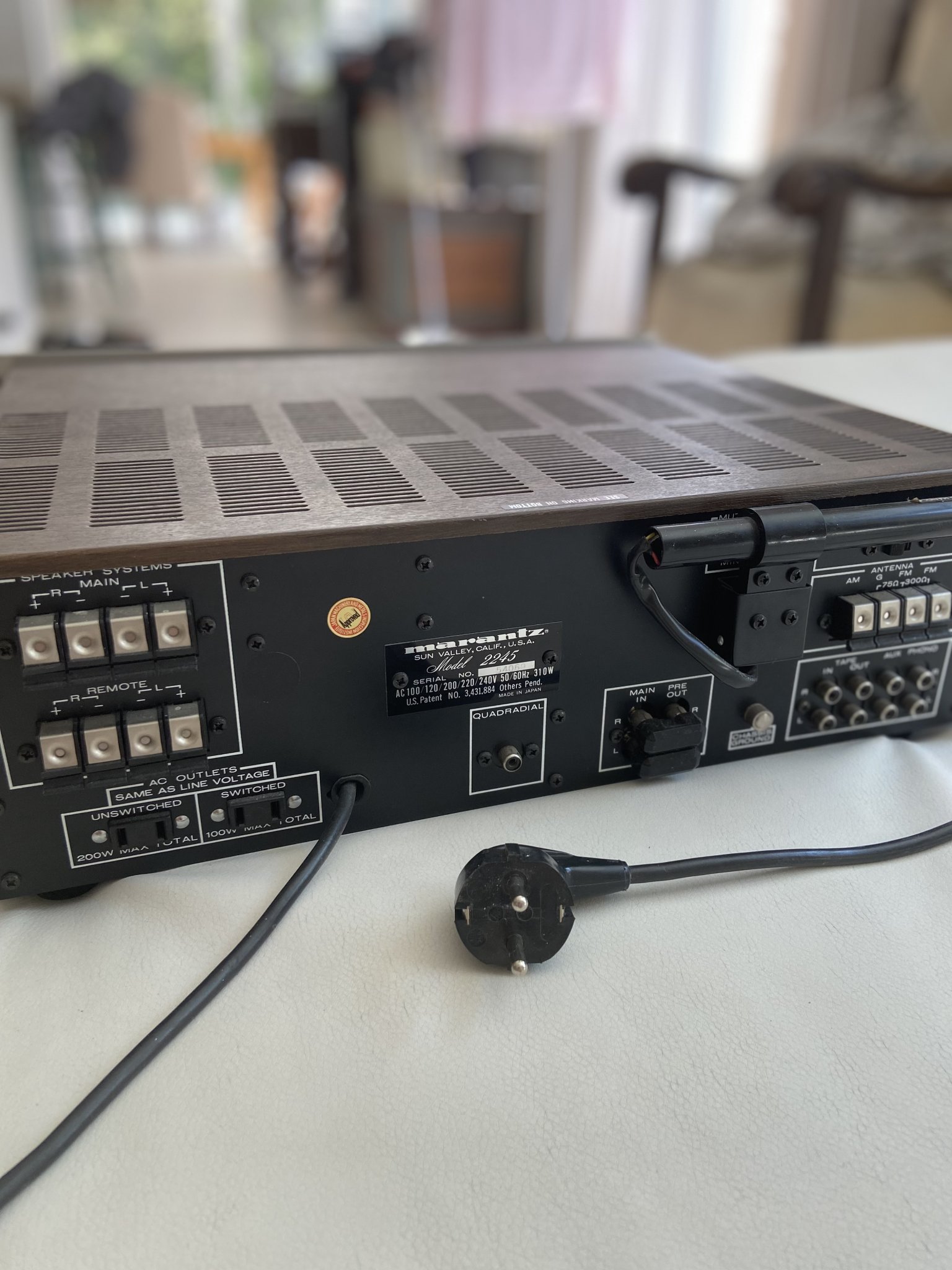

otherwise.
Clean
non-smoking environment
the cover screws seem untouched by any technician
same for the rear screws.
it is beautiful and it remains an adventure for you but you will most certainly have to put your hands in it otherwise it will self-destruct in a short time.
It's up to you to know what you want to do
Clean
Not sure why my original post came earlier in the thread, but anyway. I spoke to the seller and he was in fact able to take some shots of the inside of the unit. Any remarks on this?
nope, it's a second generation, it seems all original and in very good condition.
if it works and in view of the current sale price, it seems to be a very good deal
personally in this case I would take a 1030 or a 1040 or even a harman A401 and add a quality bluetooth receiver module to it, but once again, the tastes and colors...
Thanks!! Do you think the miscolouring etc on the faceplate can be "cleaned" off? It looks like it is the champagne coloured one, but it has some brown miscolouring around the edges and at some spots. Doesn't look like scratches, more like.. grease or dirt?
