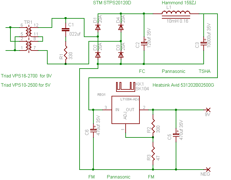

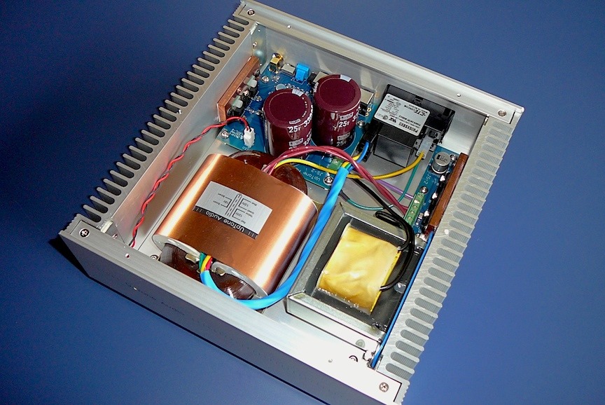

Another interesting option would be the C-L-C power supply John Swenson originally posted on the Audio Asylum that was the basis for the well-regarded Uptone AUdio JS-2 supply (see attached schematic & JS-2 picture). Based on what he wrote about it, you'd want to stick to the specified transformers, choke and raw DC caps, though I suspect you could use a different regulator and post-regulator cap without compromising performance. I'm not sure it if can source the current needed to power the output stage via the onboard DC-DC stages, but if you use a separate +-15V supply like I did, it should work very well too.
