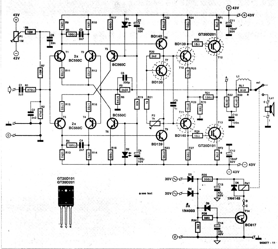

I've no idea what this amplifier looks like, can you post some details, it sounds interesting.
LEDs - can't see that this is very critical. There are some tests somewhere showing noise levels for different brands and colours, but if anybody is brave enough to tell me they can hear a difference I'll consider buying them a beer

I built the original amp. I was not aware of an update using the IRFP mosfets. I would like a copy if possible so as I have lots of the IRFP mosfets and I would like to build the updated model to compare the sound. PLease either post here or send to my e mail address.

It isn't an update from elector but from someone who had probs with this amp caused by oscillations of the IGBT.Did you have those probs too?the schematic is called the Hexfet amplifier but it's from the IGBT version.All what's in orange is the update but look out the partnumbers on the updated schematic ain't number the same as the original IGBT schematic.
Another one scheme , from Analog Devices.

I have never had any problems with the original amplifier with IGBT's. It seems to work fine. My speaker loads are around 4 ohms and with little/no crossovers.
I also have a couple of Forte amps that use IGBT's and no problems from them either.
However I am interested in listening to the difference if the output devices are changed to IRFP devices. I would like to see if the IGBT's improve anything or make things worse or make no difference. The theory behind IGBT's seemed ok but I am not sure if they really work in practice. I will have a go over Christmas and let you know how it sounds.

The LED's in question are thermally coupled to T5 and T6 in the circuit diagram that wahab attached earlier in this thread. They are supposed to have a 1.6V drop at 3mA. Trying to find an LED with those specifications is proving to be difficult for me.
- Giesberts IGBT amplifier Elektor 1995
