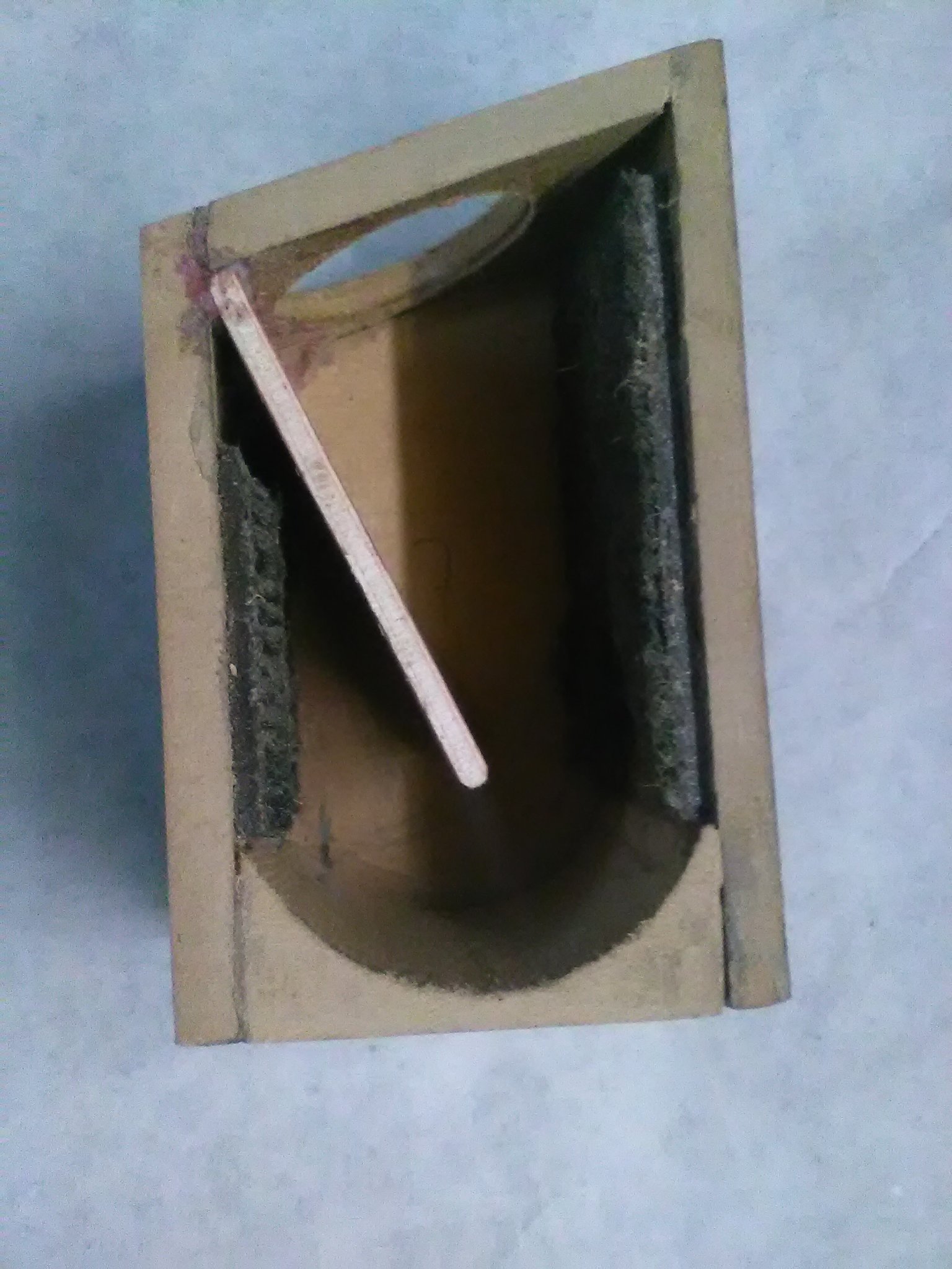

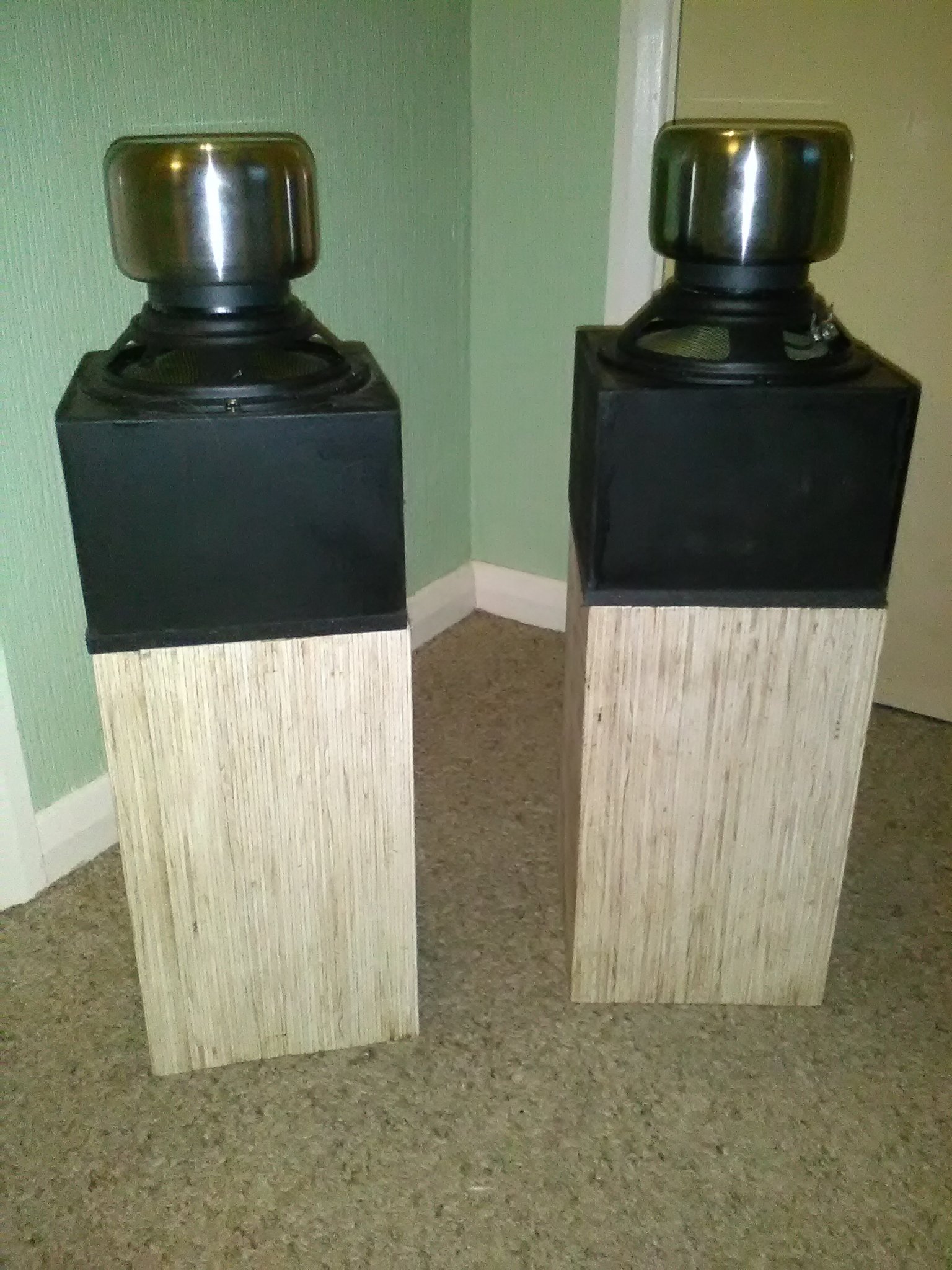

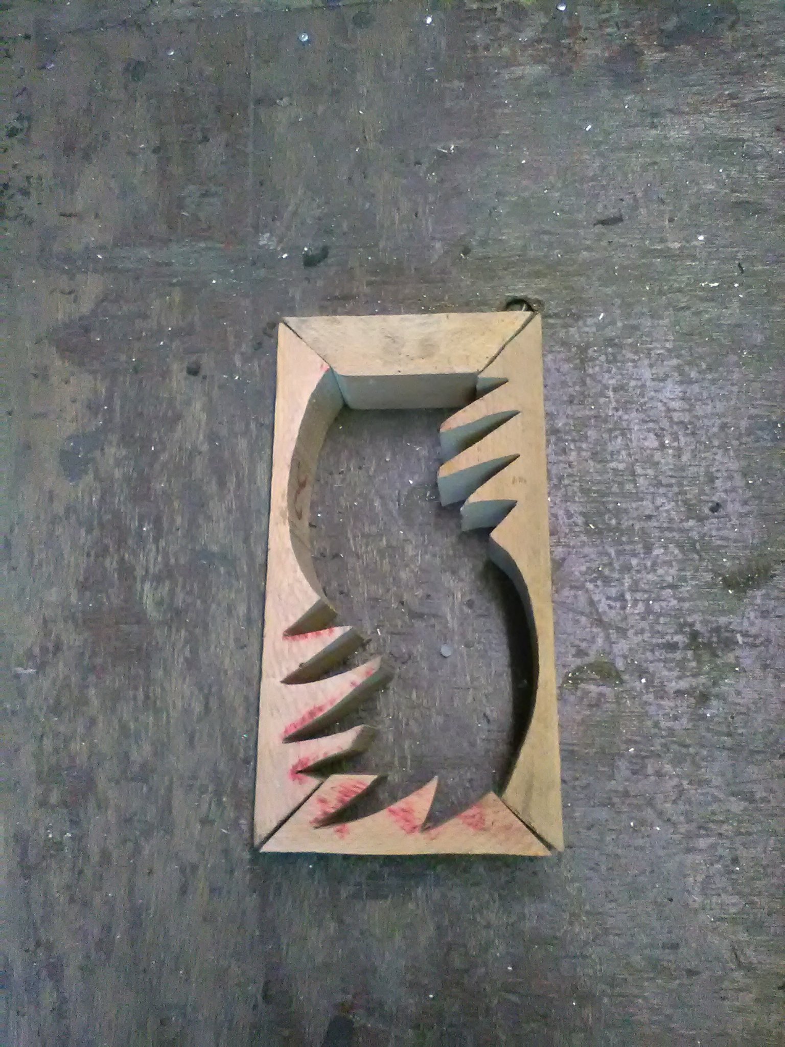

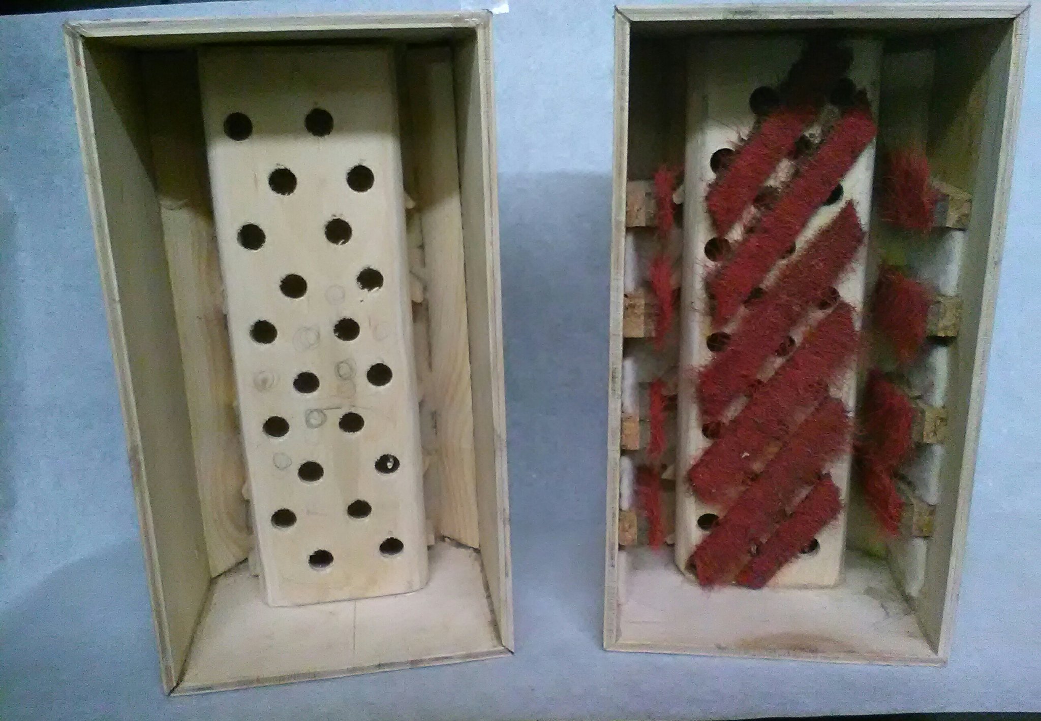

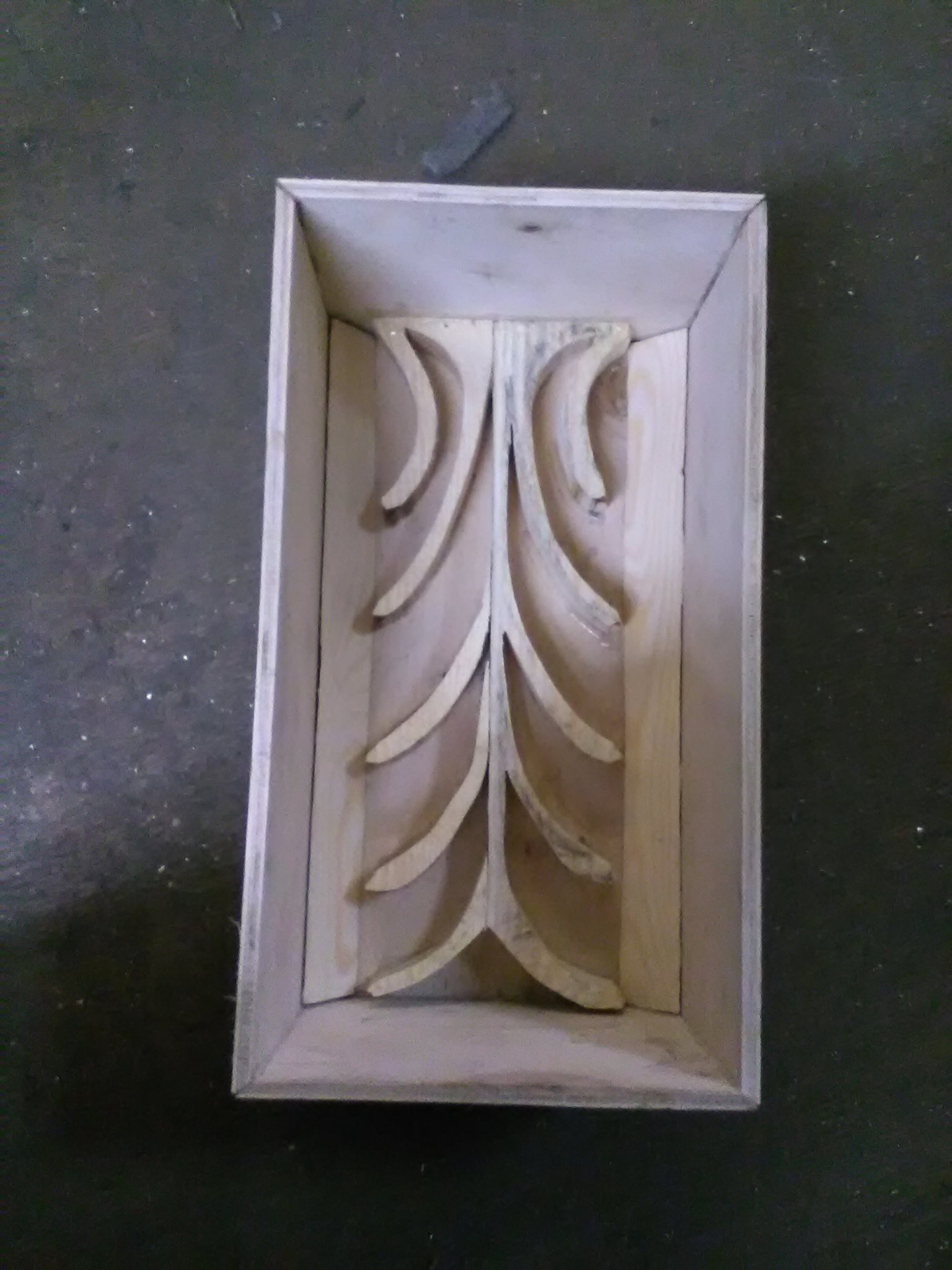

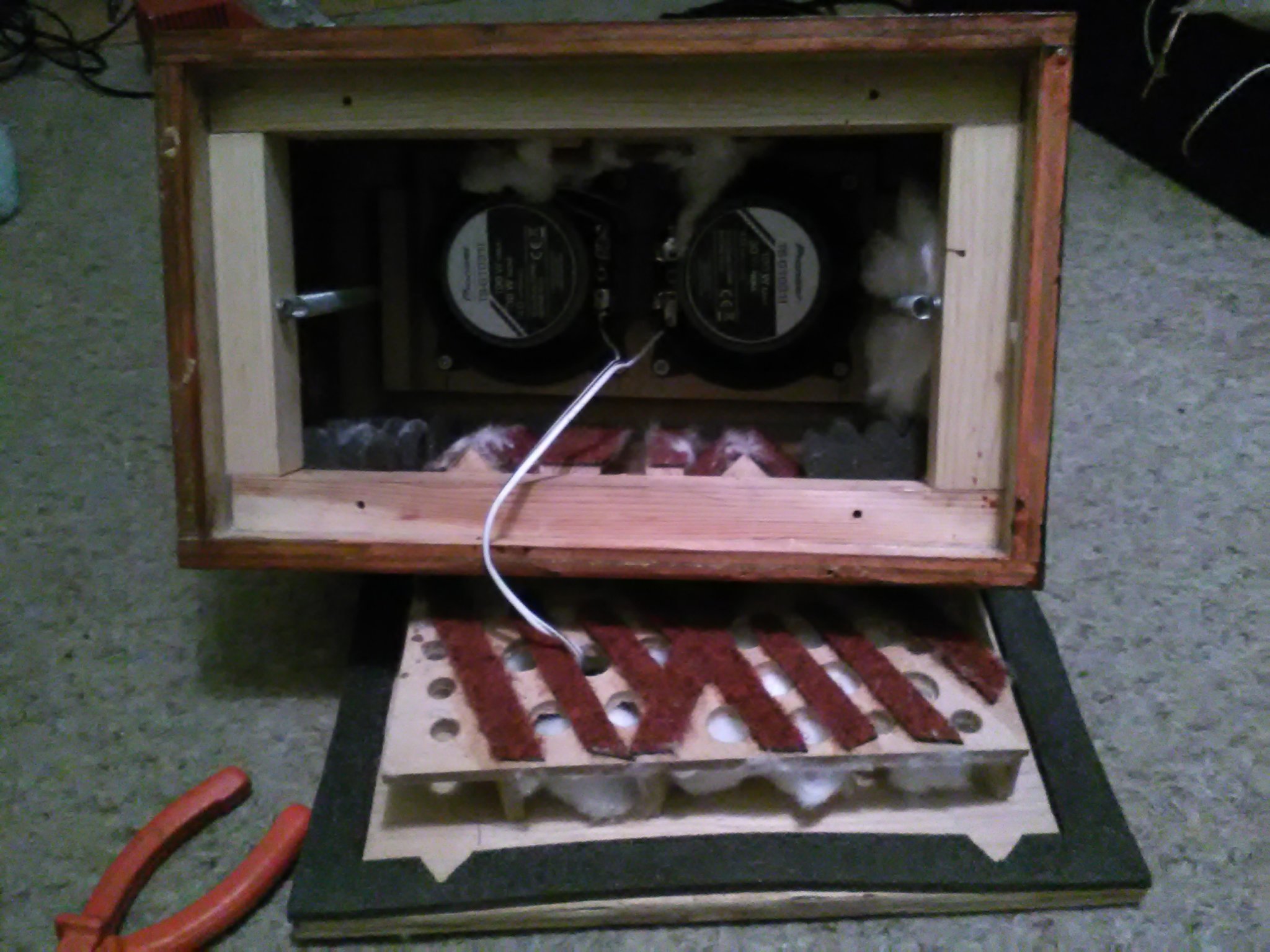

I'd consider a golden ratio to be a starting point. The last speakers that I've made use very cheap drivers, but a design of enclosure to absorb the back wave as much as possible, and to be " dead " - the front is softly mounted to the cabinet in an effort to both isolate the mechanical vibrations emanating from the drivers, and to dampen vibrations in the cabinet, and they are the best speakers that I've made so far, just lacking in ultimate bass extension due to their size. They are very detailed and reproduce tone ( and specifically vocals ) very well.
Here's a few attempts that I've made at absorbing internal waves and vibration, the speakers with the shinny ( 4.5 kg ) lump on top were an attempt at taking vibration directly from the driver magnet ( the black box beneath was also isolated from the lower " ply wood " enclosure by springs and foam. The last three pictures are of my packing case Christmas tree diffuser that I mentioned previously.

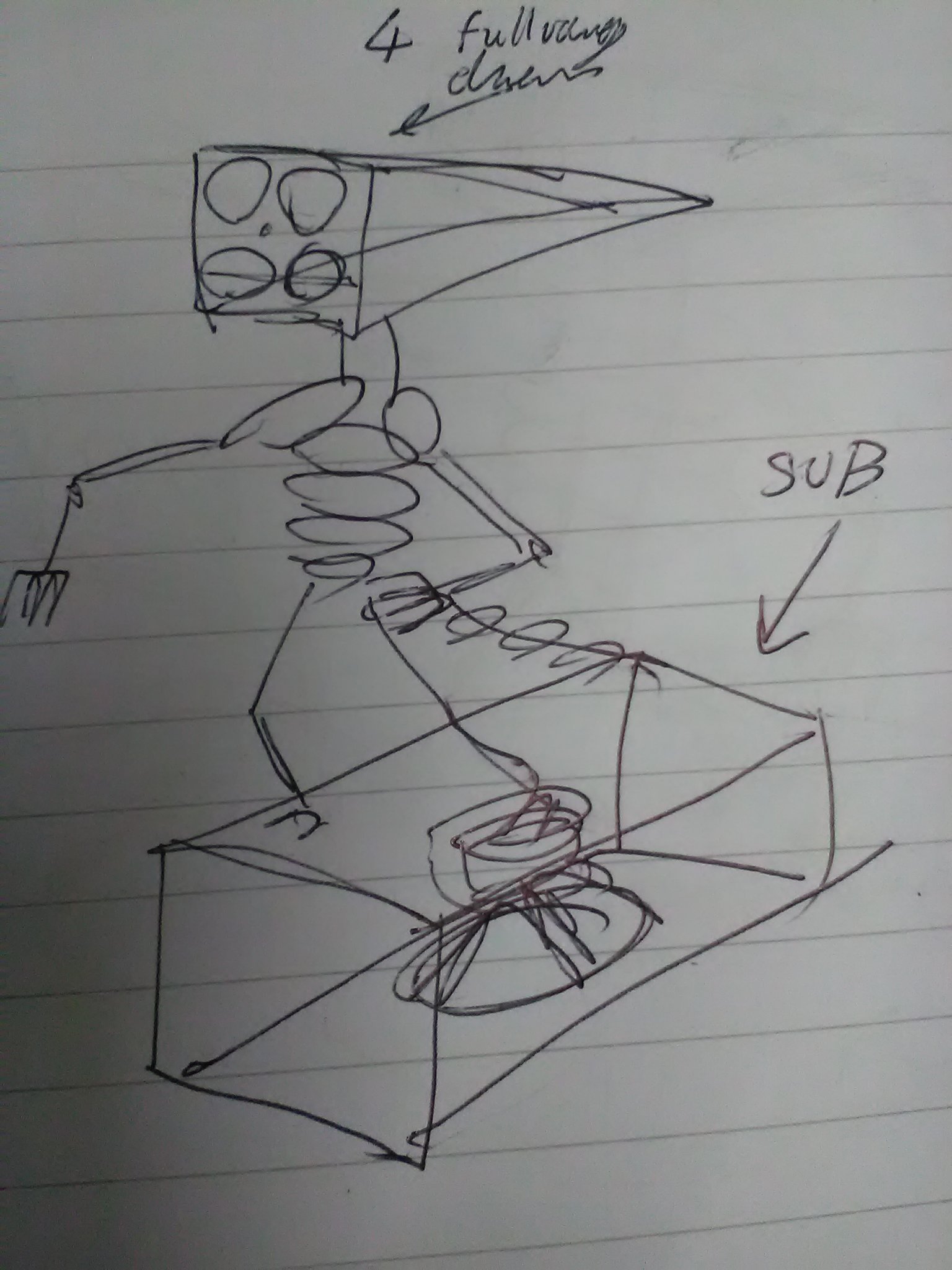

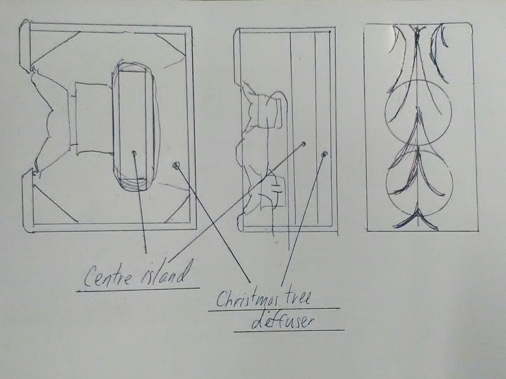

For my next speakers ( " quad triangle cutlery alien on a sub box" ) I'm going to use four small full range drivers, as hopefully four small drivers will be closer to posttonic motion than one big one. Also the triangle ( head ) enclosure should absorb the back wave well.
How about a 'meta-material'? I think the KEF idea is basically a quadratic residue diffusor sequence used to create an array of resonators with their freq. equally spread across the spectrum. Maybe similar could be done by making a nice deep diffusor (like RPG Omni-fusor) on the back of the box and adding a bit of damping at the bottom of each well.

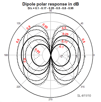

Lower frequencies that are less directional than high frequencies will leak out the gap and cancel at the sides. You are creating a kind of di-pole with a box behind the driver and damping to 'catch' the more direction mid and high frequencies. This is a common way to use di-pole in a room - open baffle di-pole with a thick sound absorber placed behind it.Scottmoose

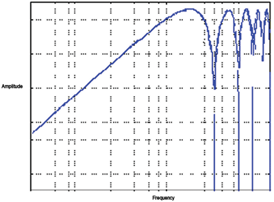

Why is that? Well, open baffles produce disastrously bad bass response, and usually disastrously bad frequency response up through the midrange as well. See attached pic showing predicted frequency response for an ideal (flat response, zero-diameter) speaker mounted in a circular open baffle. The bass rolls off gently starting at quite a high frequency, so there is very little bass. Sound from behind the baffle interferes with sound from the front at multiple frequencies, producing peaks and dips in the frequency response.
(In real life the midrange and HF peaks and dips are less extreme than they are in the simplified mathematical model. But the problem is still quite real. Open baffles do not produce anything close to a flat frequency response.)
