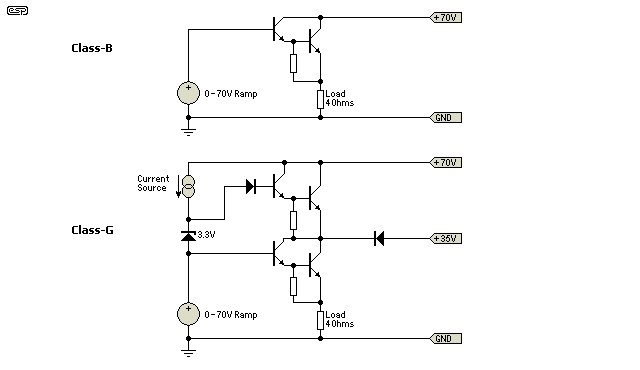

Many major manufacturers, in the quest for efficiency, use Class G or H. They use stacked power supply switching. More efficient than Class B.
Class B vs Class G Full Screen Image | Audioholics

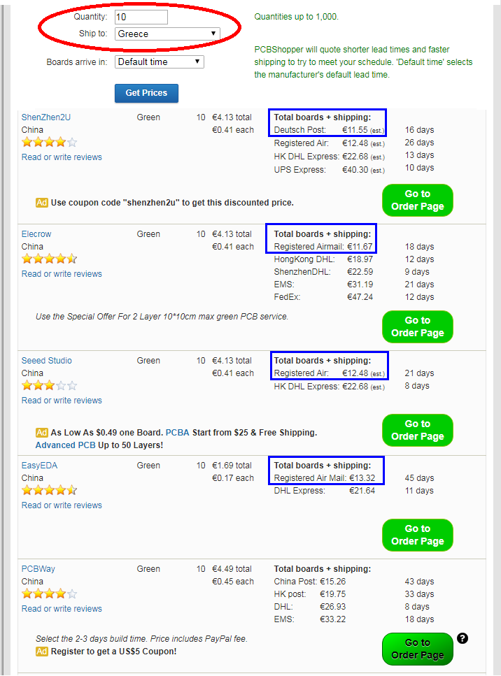

RingNot provides ±28V at 3.5 amps, it's intended for LM3886 based chip amps but perhaps it would suit the design you are contemplating. You can download the PCB CAD files (Gerber format) for free, and send them off to a board fab. Here is the delightful website PCBShopper – A Price Comparison Site for Printed Circuit Boards in action:

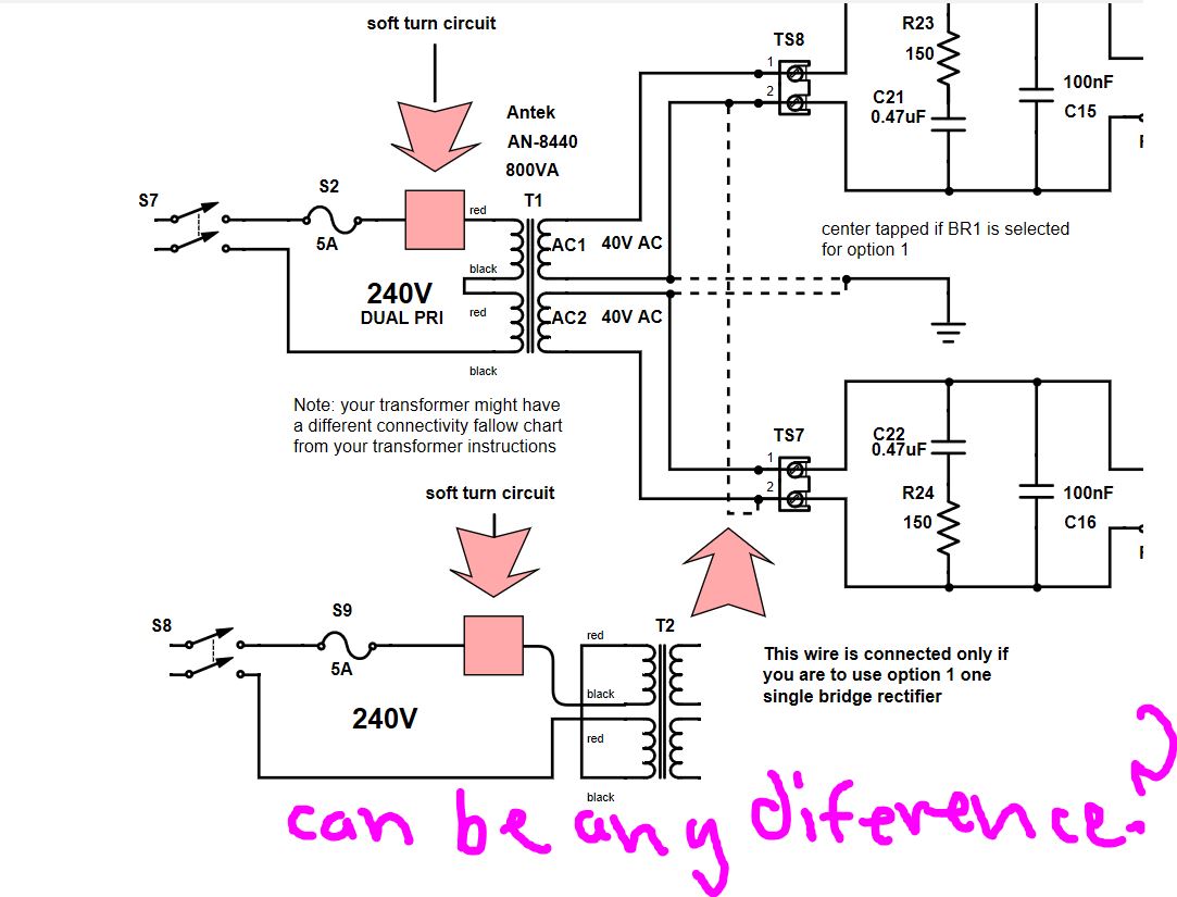

hello guys I might be on the wrong segment and I apologize for that but since this is about power supply I need to know if this really matter the way we connected the primary from a 800VA toroidal transformer that has 2 primary winding so it can be use in a 240V outlet the part number Antek AN-8440 has 4 color primary wire 2 red and 2 black wires so if to be use in 240 then the winding 1 is connected in series with winding 2 but how you can tell which one is the right one 1st and 2nd winding will it matter ? See images the last image what about if we connected as the bottom image it might affected the performance of the transformer ? sorry for the weird question because I'm really curious about this any respond I will reapply appreciate your help .

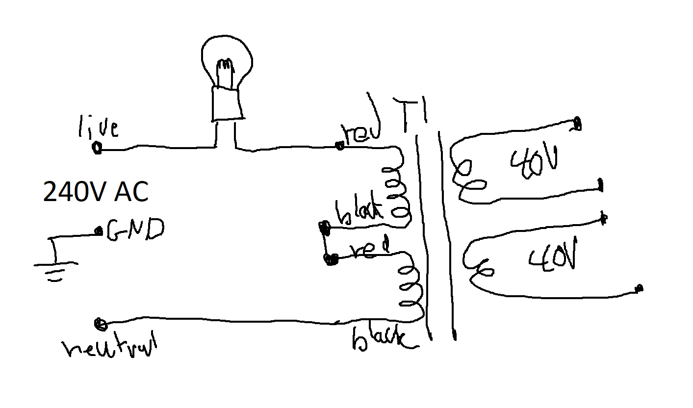

Yes, it has to be done correctly. If in doubt then use a DBT (dim bulb tester) on the primary winding. Connect the two windings in series and switch on checking that the bulb is not lit and that the expected AC voltages are present on the secondary.
If the bulb lights brightly then reverse the connections to ONE primary winding only and retest.

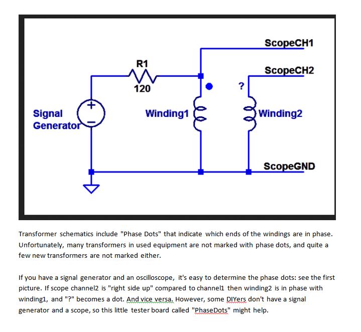

There's also a little tester called PhaseDots here on diyAudio, which runs on a 9V battery. You connect two of the transformer's windings to it and if they are in phase, a green LED lights up. If they are out of phase, a red LED lights up. It fits on a little 50 x 100mm piece of board. It helps you discover where to put the "Phase Dots" on the schematic diagram of your transformer.
oh I see if they are correct then the light bulb shouldn't be bright at all, I didn't know that so it should look like this drawing ? if bright then reverse the wire and retested, thank you 🙂

That's it
Hey Mark, that's a neat circuit. Hadn't seen that thread before:
A little tester to determine transformer PhaseDots with no scope or signal generator

I tried out the method described below (See image 1) and I don't think that's what I am after.
Yes it tells me which winding are in phase but my question is not exactly that.

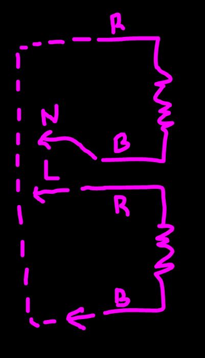

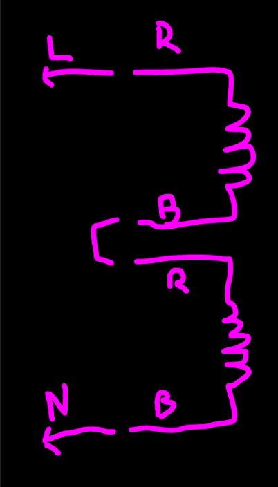

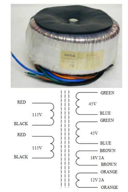

I have a Antek transformer (Image 2). I live in Australia 220v - 240v and I would like to know if the way or order that I wire the phases makes a difference to the performance or correct way of wiring the transformer to the mains supply.
As you can see in (Image 2) the end of each winding has a red wire and black wire.
So as I need to wire these winding's in series (220v - 240v). Do I need to determine the order of the winding's. In other words do I need to worry about which red wire I start with. see (Image 3 and Image 4)
Any help on this would be very much appreciated.
Cheers
Stuart

The current needs to flow in the same direction in both primary windings or their magnetic fields will cancel. Both image 3 and 4 appear good because in either case the flow is from R to B or vice-versa.
Thanks for your input. That's exactly what I thought. But how do I know which red wire is which in (image 2) so that I can wire the transformer as per (image 3)The current needs to flow in the same direction in both primary windings or their magnetic fields will cancel. Both image 3 and 4 appear good because in either case the flow is from R to B or vice-versa.
I guess that's part of the original question. Does it matter.Why do you think that matters?
It doesn't matter in absolute terms, although you could find situations where there were 'differences', particularly if you had for example two transformers running together and they were physically each within magnetic influence of each other.
Then it is just trial and error to see which gives lowest noise/hum/distortion or whatever.
Simple answer is no, it doesn't matter.
