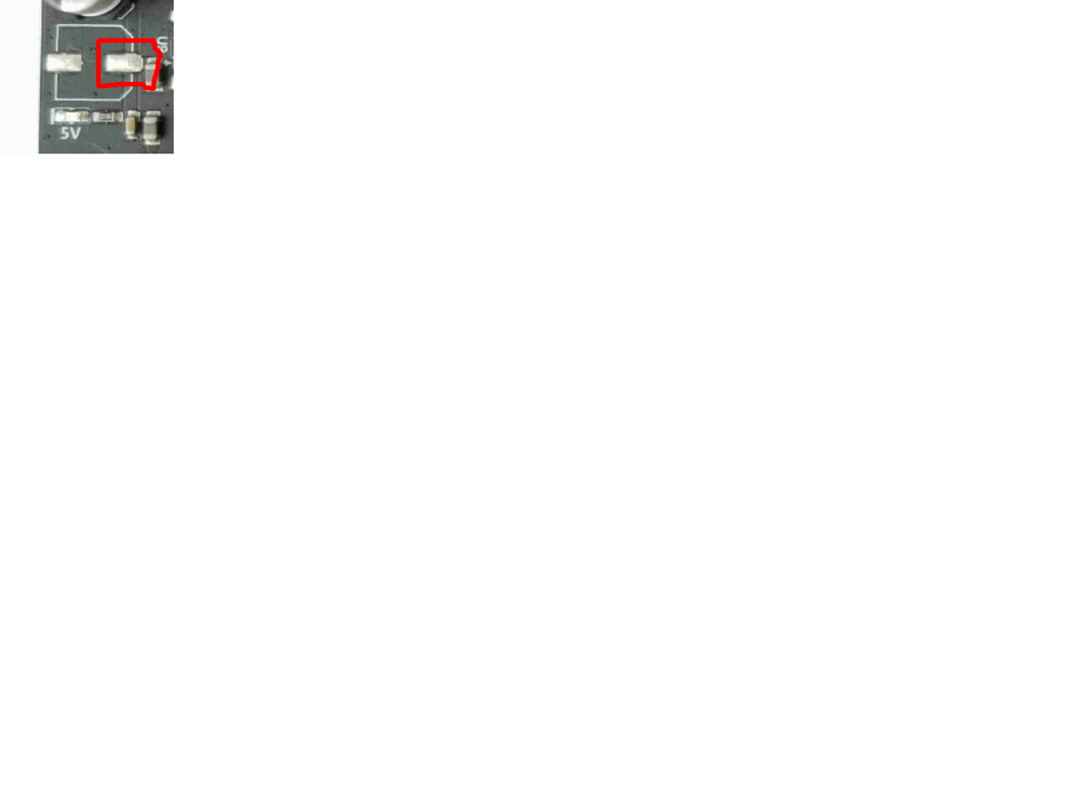

Just remember the ADAU1701's weakeast link is its ADCs: "2 ADCs: SNR of 100 dB, THD + N of −83 dB" (from the datasheet). Using the world's best DAC isn't going to improve those numbers. I'd say the first DAC in your list is fine. As a bonus you can get the DAC's 5V from an used capacitor pad on the 3e Audio DSP board.
@ernperkins I am using an USB to I2S for input, so no ADC.
