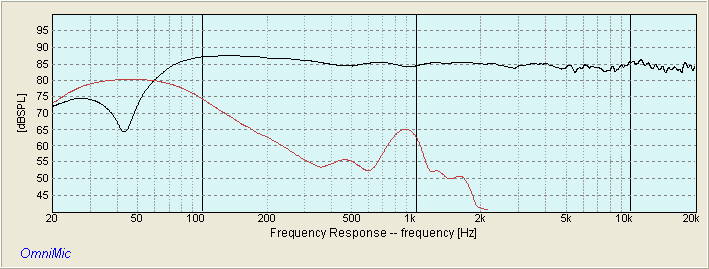

Borghese's designs don't really appeal to me, by the way. Had to dig deep to find any measurement and what I found didn't impress me a bit. Enclosed the response of his Sorriso.

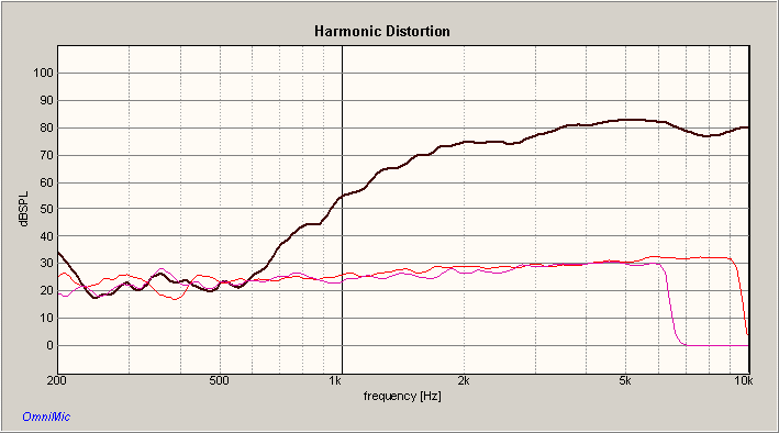

You cross that tweeter way to low, it needs a crossover above 2.5kHz at least to avoid heavy distortions on it. you can see that in the measurments: https://hificompass.com/en/speakers/measurements/peerless/peerless-bc25tg15-04
Needing a crossover above 2.5kHz is nonsense. Below is the distortion plot at 2.2kHz. Do you see any distortion rising?
My crossover frequency may seem low but this is for nearfield use. At normal listening levels, the crossover is perfectly fine.
