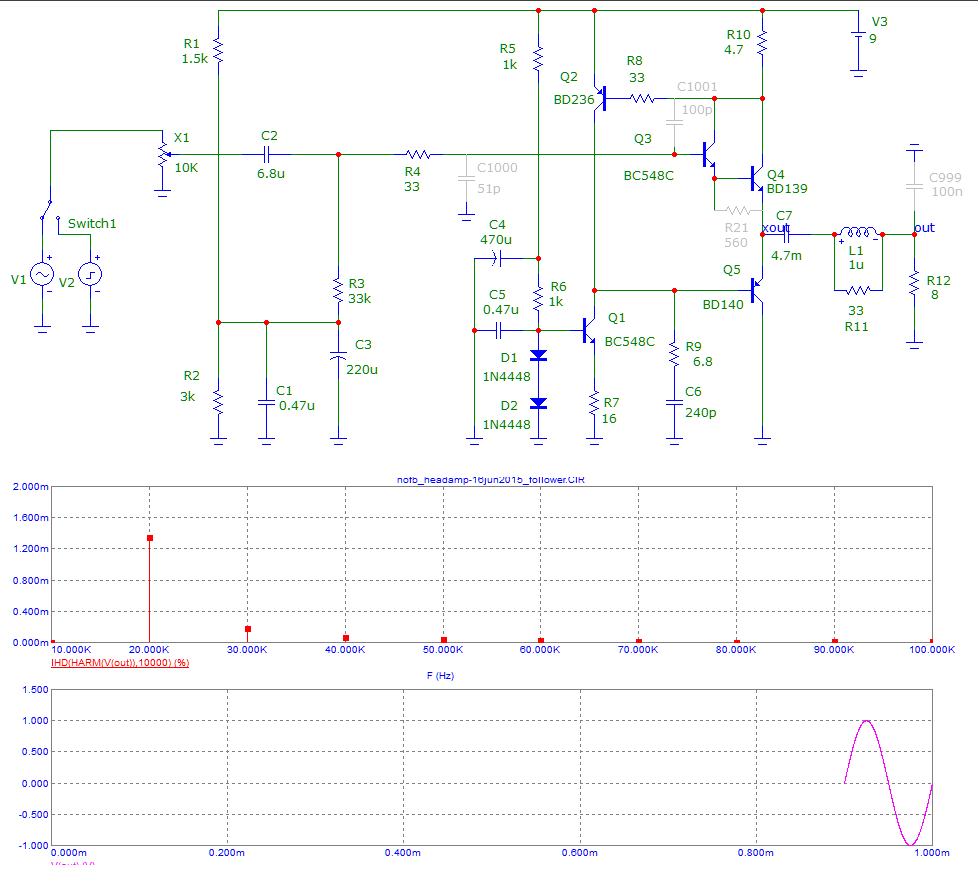

so.. I will not be too original.. Here is my design turned into follower (think you need only current amplification). However such modification never tested in hardware, in case of problems with stability - there're few grayed elements that should help...

Just to make sure. Could you be more specific, is it dB/mW or dB/V? Or even something else?
With those old 8 ohm cans, it's not even certain whether they're best driven from a voltage or current source. Typical headphone outputs of the time certainly would have been in the latter camp, featuring output impedances in the hundreds of ohms. I'd say try them with a random integrated amp or receiver, and that's pretty much as good as they're going to get. I didn't find anyone raving about the sound quality of this model, so I assume it's not anything too spectacular. (Most dynamic cans of the 1970s certainly weren't. Measurements of K240 Sextetts are really respectable though.)
If you need an approximated current source output without having to provide ridiculous voltage swings, about 80 ohms of output series resistance should do (so maybe 68, 75, 82 or 100 ohms). As for the amp to add these to, maybe something cMoy-ish with 2x 9V and an NJM4556A and a gain of about 10.
A real current output gets a little more tricky, one would basically need some kind of OTA for that.
